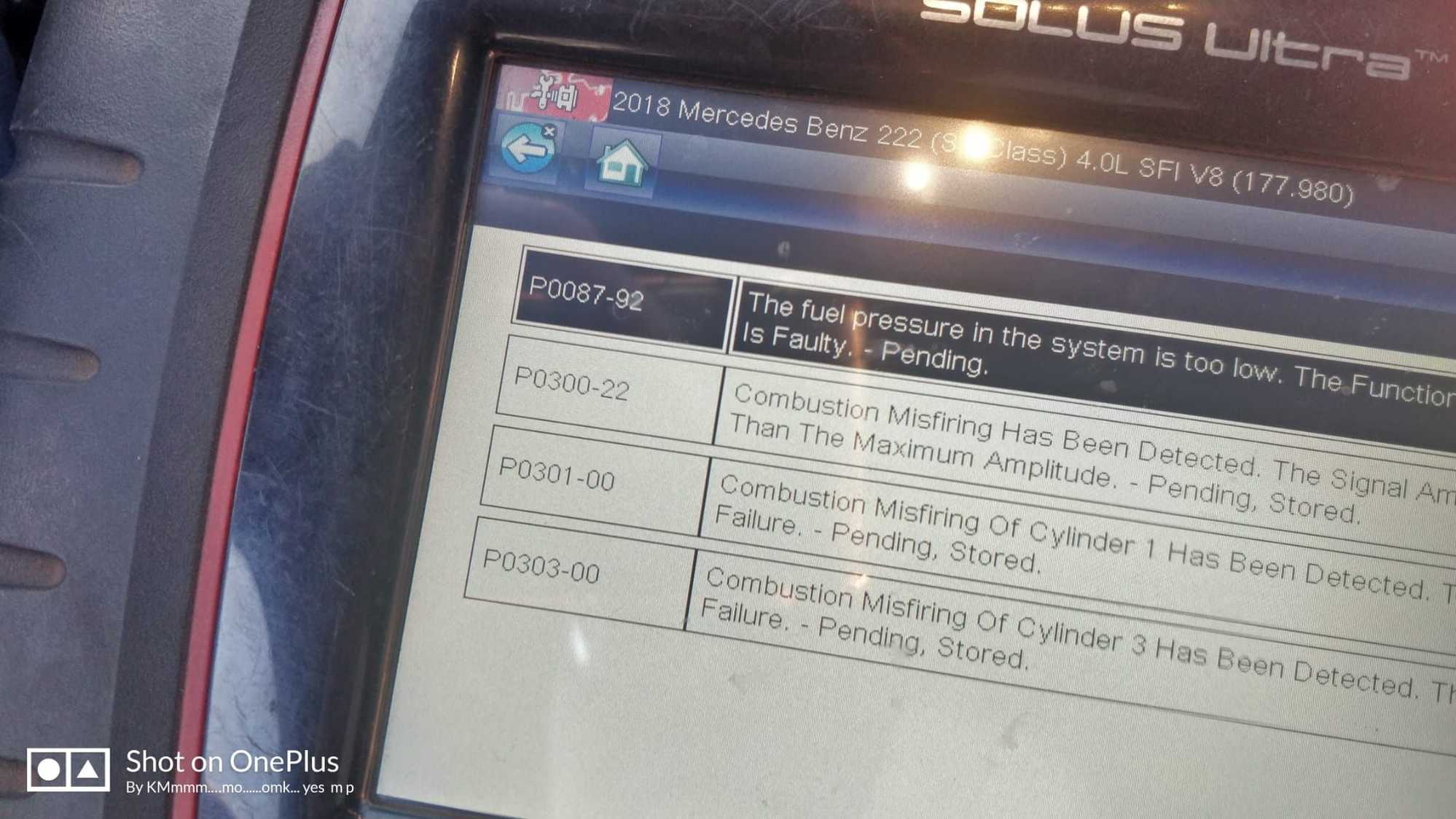

Dropped my car off at the indy shop and hopefully its something manageable for them to fix otherwise I will drop off at dealership.
This weekend , experienced when driving the car would shake like crazy when gasing and very rough starts. Alot of gas smells when starting up. So I decided to drop off the car this morning at the closeby indy shop for quick inspection and this is what came back. Now to see what can be fixed.

Dealership gathered it could be the aftermarket exhaust (Capistro) causing it and will not warranty
3 spark plugs being replaced
2 ignition coils be replaced
After that will test it out some more..

SA called me and explained they will warranty the parts and fixing it - they wanted to make sure I do NOT have any boost in the car before they download information off the computer which will void that warranty.
Finally it was warrantied and the following
1) replaced Ignition coil
2) replaced Spark plugs
3) Reman injector with nozzle
4) TS spring injector
5) TS oil filter
6) screw plug
7) Check Compressions
After all said and done it was replaced - they found out it was still having issues.
They suspect its the fuel injector and fuel kit and have that replaced which got the car running again. After getting the car back all was fine but few days after i noticed sometimes when starting the car the idle would be low and car would shake - than the RPM would jump up very high and back down again on random starts.
Yesterday when car is in Drive and stopped at the light or traffic for whatever reason - the car would just simply die. I'd put back to Park and restart the car which made it very dangerous to drive. When driving pass 60 the whole car would shake and rumble again.
Enough of it - sent back to dealership yesterday AGAIN so will see what the further analysis is.
