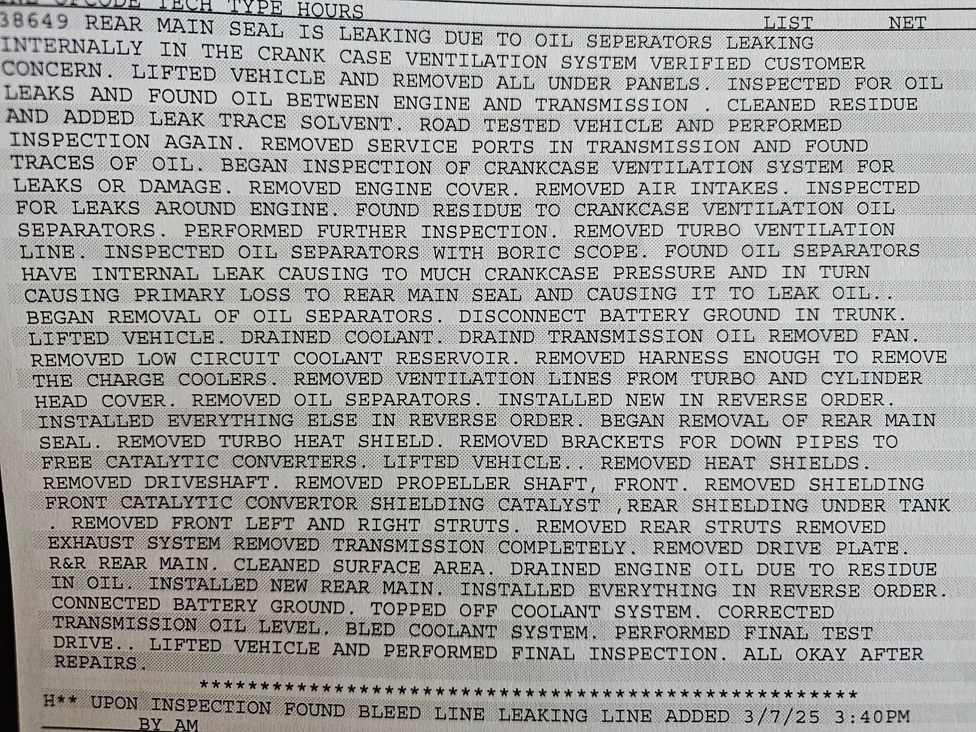

Car has returned. They replaced rear main seal, 2 oil separators. All under CPO warranty. All in all ~ $10500. Attach picture of work history. High trans temp didn't show up either.
Question
Did they fully drain the trans oil and refill or just a top off?
What would the residue in the engine oil be?
Question
https://cimg4.ibsrv.net/gimg/www.mbw...5387b5acaa.jpg
Finally got the car back, hope you have no more issues.

Interesting they mention removal of the transmission pan to do a rear main seal in the engine.
Remove all four struts? Sure seems like exhaust can come out without all the above mentioned drama..... I really doubt exhaust is one piece from cats to tailpipes. Sure reads as a good deal for the dealership at $250 or more/hour.
