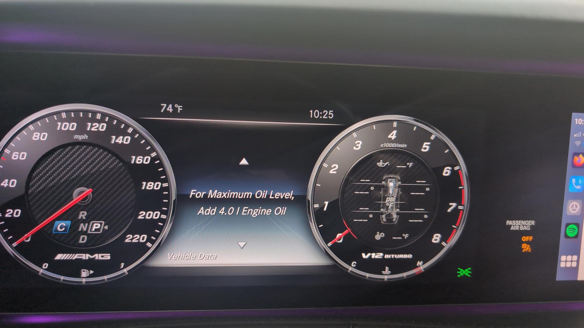

The over engineered oil dipstick sensor is terrible on the 279...
This was the level this morning. Cold car.
Then right after startup, all of the sudden, the oil was overfilled by 1.8 Liters.
After a minute or so, it starts reading normal.
Makes me wonder how many people are either overfilling or underfilling their oil based on the level sensor.

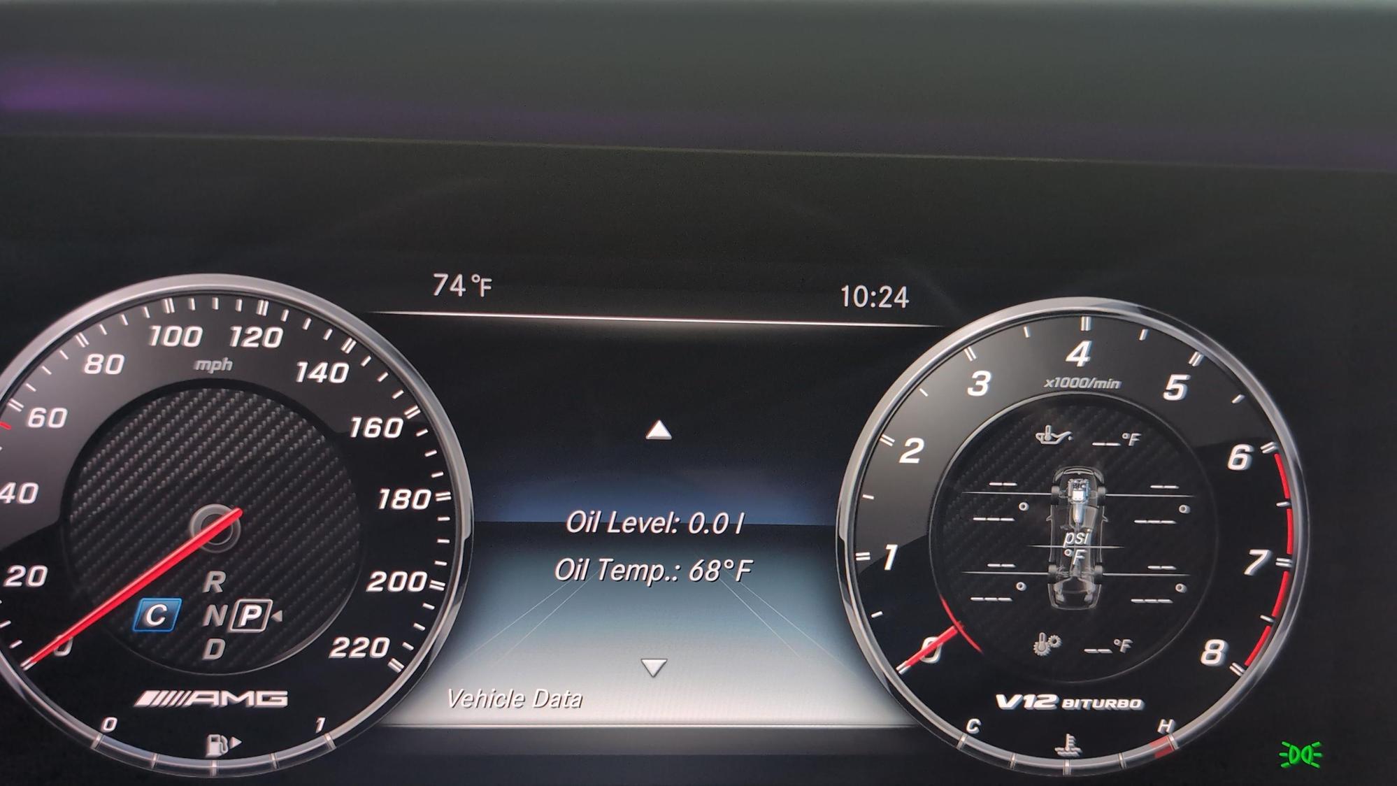

Definitely time for a dipstick. Seems they're relatively cheap on Fleabay.
This morning, cold engine.
Level at 0, but still thinks it only needs 4L to bring it to max.
