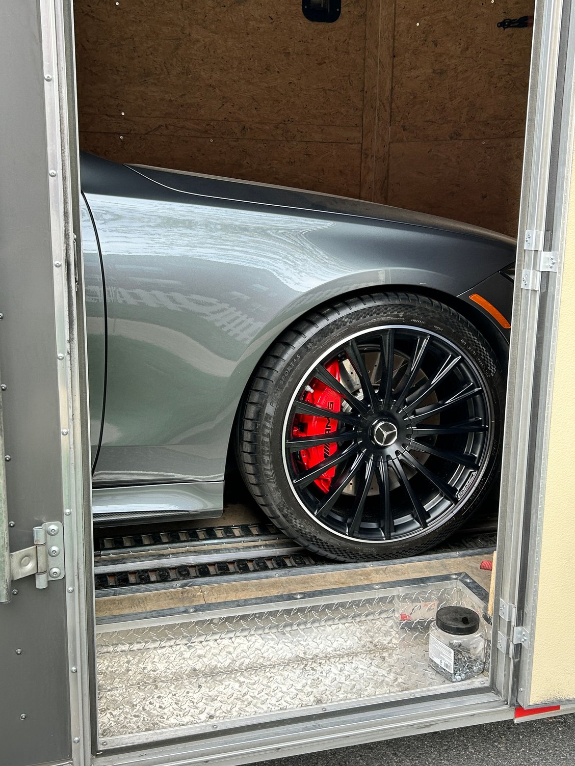

I recently had my car at the dealership for some warranty work and while they had it I had them install the Power Stop front and rear ceramic pads…….and holy sh*t what a difference in brake dust. I’m borderline obsessed with with my 2018 S63, so it gets wiped down ALL the time. I’m overly familiar with the brake dust the stock pads put out and have spent countless hours cleaning my rims/calipers.
I’ve driven my car with the new pads to a point where they’d typically be completely coated in brake dust with the old pads - I went to clean them tonight and there’s no dust……..well, not quite “none” but it’s so light I struggled to see it on a microfiber towel. It’s damn close.
I cannot believe the difference, If you’ve ever considered buying these to eliminate brake dust, don’t hesitate I’m kicking myself in the nuts for not buying these YEARS ago. They would have saved me HOURS of time!!!
For easy reference below are the exact pads and I purchased them on Amazon. Additionally, I’ve known my AMG tech for 15yrs and he’s the ONLY one who touches my car - he reported no issues with the install when we chatted when I picked the car up. We discuss every repair/problem everytime he sees the car, so he definitely would have told me.
Fronts- Power Stop Z23-1291 Front Z23 Evolution Sport Carbon Fiber Infused Ceramic Brake Pads with Hardware https://a.co/d/hyuoIb5
Rears- Power Stop Z23-1669 Rear Z23 Evolution Sport Carbon Fiber Infused Ceramic Brake Pads with Hardware For Mercedes-Benz S63 AMG, Mercedes-Benz SL63 AMG, Mercedes-Benz SL65 AMG [Model Specific] https://a.co/d/bvQ8qPq
