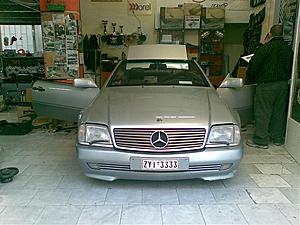

I changed the stock becker with a full stereo jvc,new better speakers, sub woofers etc. This mod can be done but you have to take it to a stereo expert, because he has to put new cables all over the car, and this could take at least 6 hours! (door removal, carpet removal etc...) Thats the only problem.If you decide to do it tell to the expert to remove the carpet from the side of the co-driver and place the cables from there. There is a small hole next to rear wheel which goes into the trunk. (this hole goes under the hood trunk hopefully!) Good luck!
