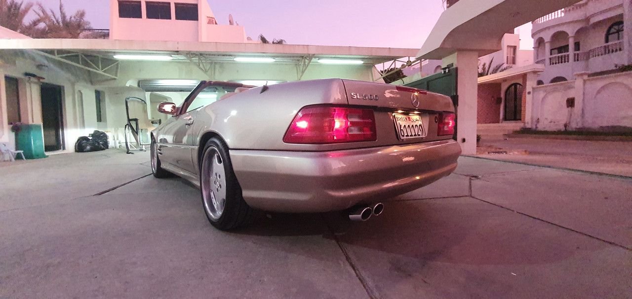

A good body shop can do it for you. It's a straight swap.
The only thing you'll need to worry about is sourcing the AMG fog lights.
Before
After

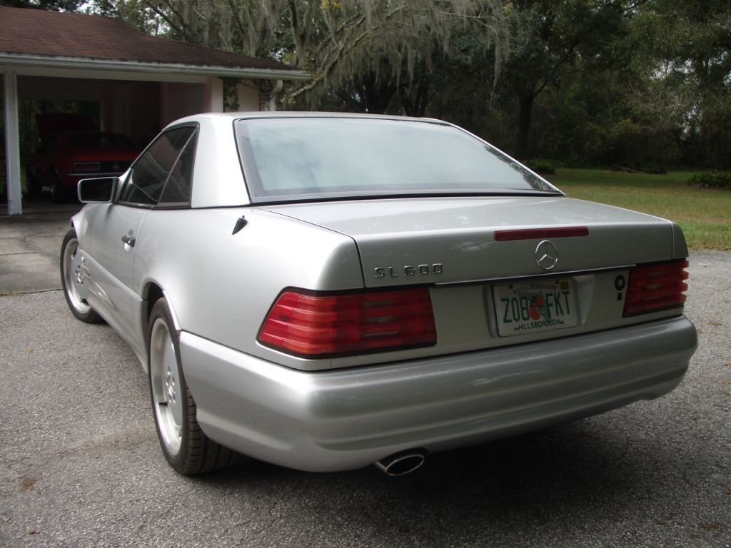

In addition to the Sport bodywork, I also added the TUV rear flares and used the 1998+ rear muffler to better match the newer Sport rear bumper cover. I do have a genuine twin tip AMG muffler for the middle year cars if anyone is interested.
Lower and wider.
Looks good with the updated muffler and the subtle OEM Euro TUV wheel arch flares.

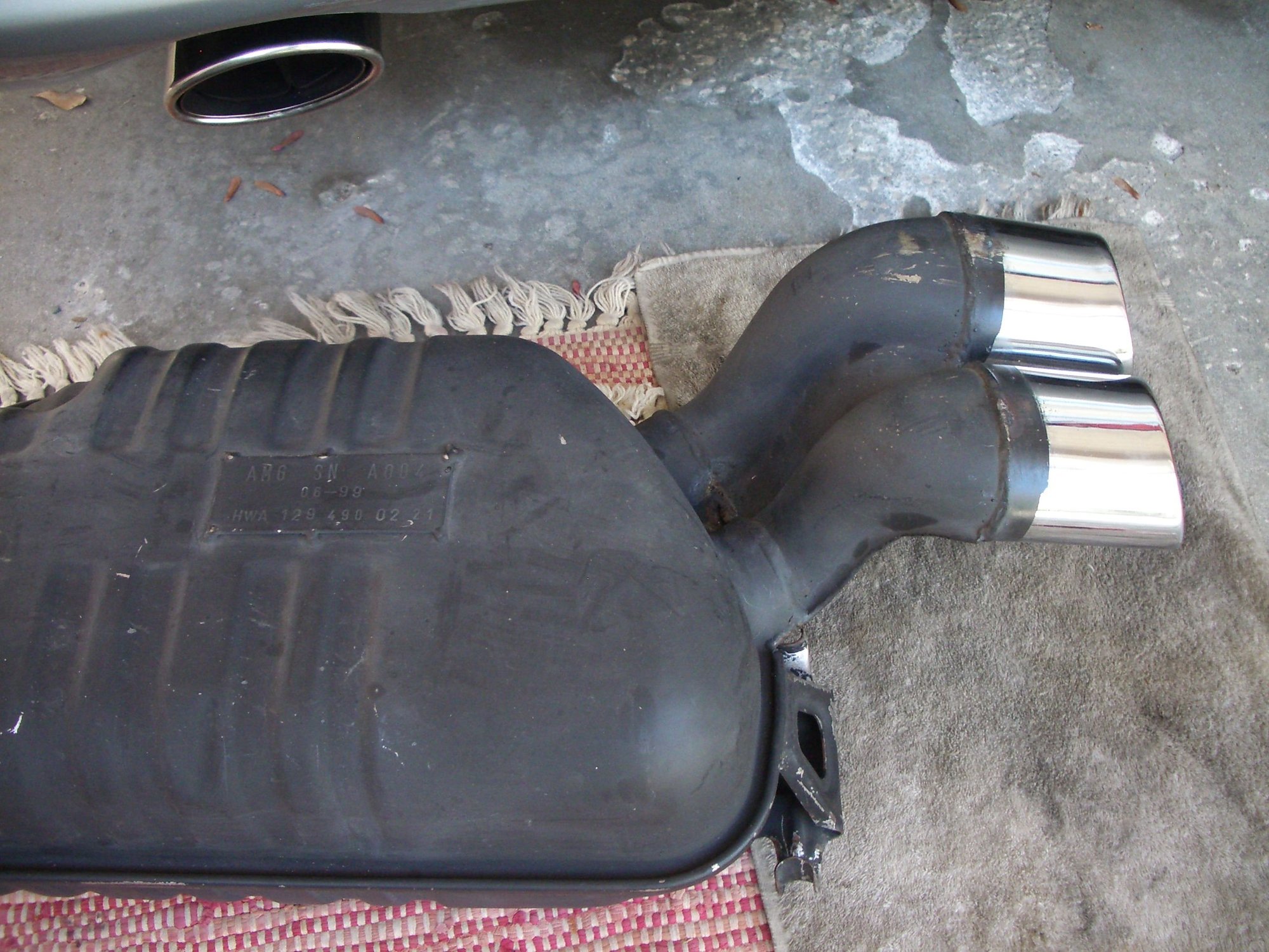

Nice. Have a pick of the twin tip AMG muffler?

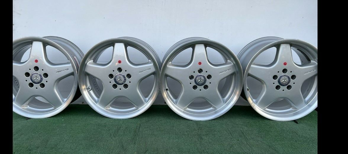

I bought these wheels to go along with the AMG bodywork.

Sure, here you go. Google the HWA tag number for an idea of value.
If someone is interested AND has a pre-99 V8 or six cylinder car with the resonator, I also have a resonator eliminator.
AMG twin tip for pre-99 car rear bumper (Sport or regular bodywork) cutout. A little bit of chrome flash for our otherwise understated cars.
