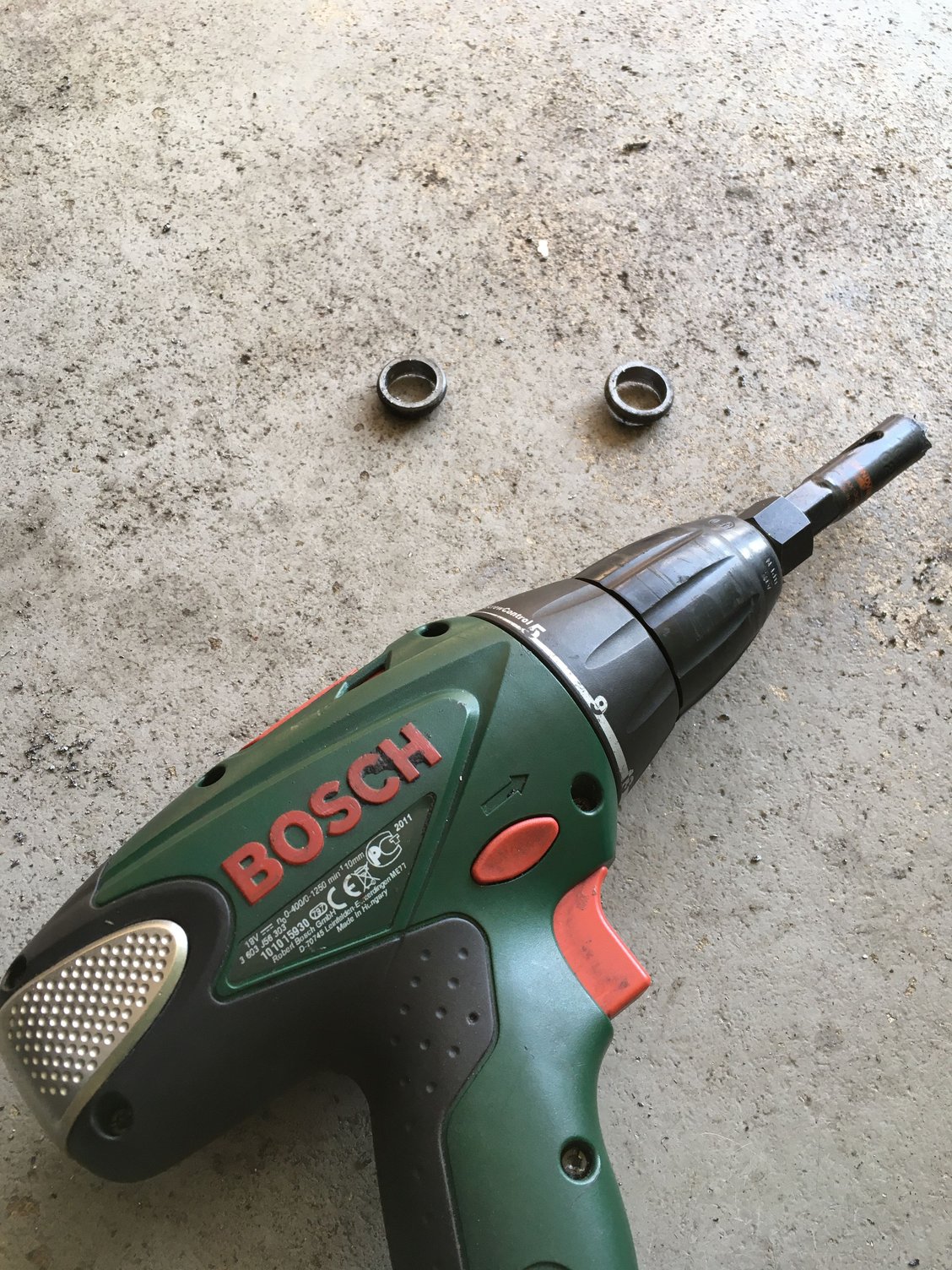

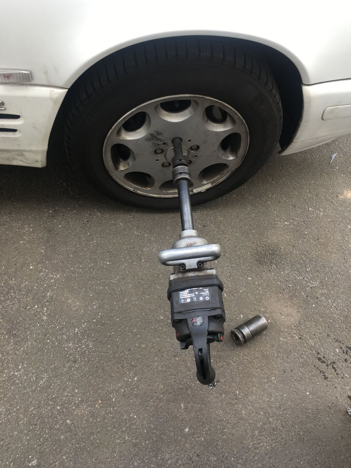

Update… I’ve removed about half of the bolts using my impact wrench and penetrating oil. The other half have not been so successful. I have purchased a 14mm hole saw (smallest Bi-Metal Available). The issue is that it is just a bit large than the hole… probably 1-2mm. If I were to miss and cut an extra millimeter from the hole, am I going to have to get rid of the wheel? I imagine not as the bolts are tapered (I’m sure there is a better word) so It would just be a matter of twisting it another quarter turn.

You are not the first and not the last one. All you need is the right hole saw, it is not too difficult.

Doesnt work:
Work:
