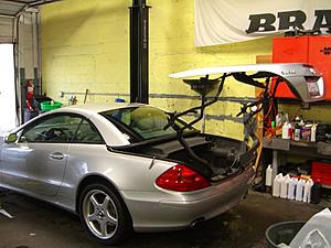

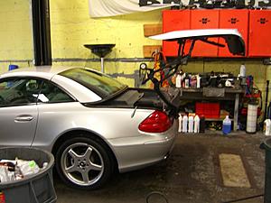

Today we had a SL come in with one of the flap cables broken.... So first the top has to be put in "service mode" to access the trunk lid....
Then the parts can be removed and reinsalled much easier...

Originally Posted by QuadBenz
Neat. How does one put the SL into service mode?
Is this something that needs to be done with STAR?
Nope just a wrench...... Not that high-tech, sorry.... lol

I had a similiar situation
One of my flaps didn't come out while putting the top down, and there was not enough room to move the flap manually, dealer had me put key in trunk and release the latch, and you end up with the trunk lid hanging over the back of the car. I was shocked to see it like that.

Originally Posted by derrick_lui
awesome! now we can use our SL's as platform ladders!
i was thinking if it was lower... it could serve at a picnic table.....

Wonder
Wonder how easy it is to get back in the closed position after opening it like that.
it falls back into place

hmmm...
I know the dealer had hell when repairing my deck lip flap, I guess it had something to do with the bolts it goes onto in the trunk. Was going to try it myself, but didn't want another problem.
