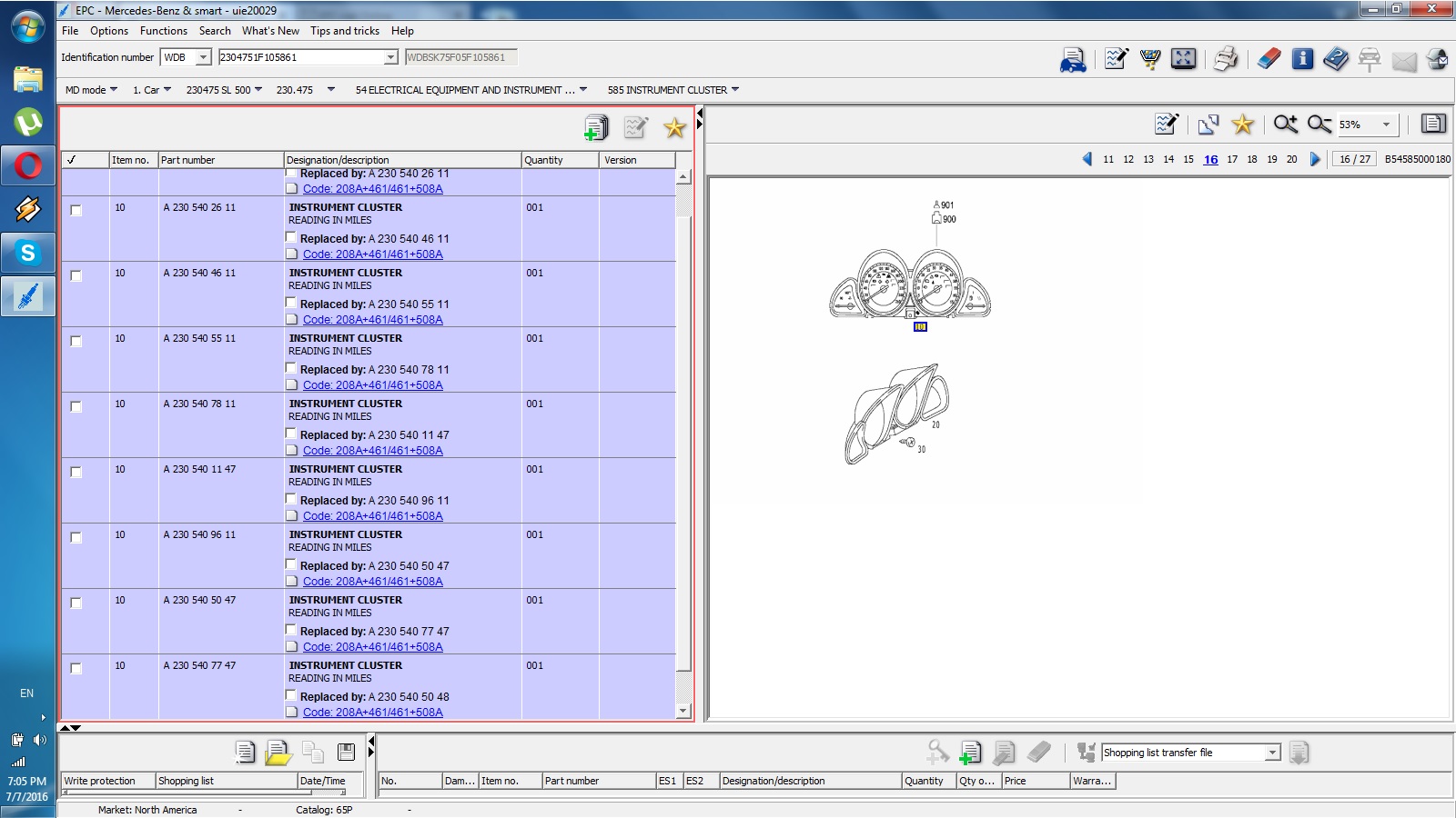

So i need to replace my instrument cluster on a 2005 SL500. Gives me all kinds of hicups and when scanned with SDS showed me something about bad connection with the cluster.
Any way the question is - can i replace with any SL500 donor cluster? Or from any SL of the series - SL55/600/63/65?
Why i'm asking is because i researched using the EPC system, and it shows me a list of parts #. The next part on the list replaces the previous (See attached 1). As much as i understand they're all interchangeable. Now when looking online for the cluster, all the sellers refer to an interchangeable part #. The interchangeable part # is not present in the list on the pic attached. Where did that come from?
Am i suppose to use a replacement cluster with the part # from the list? Or it will work if listed with the same interchangeable part #?
Is any big concern about how many miles has the donor vehicle? (I mean time related and lifespan)?
I know about the procedure, so please info on the questions asked
It confuses me because i expected 1 part number in result of a part search by VIN number. The system came up with 10 different parts #....
Thx in advance

Thx, Plutoe. Dealer confirmed that any of the same series SL will work for me. Luckily, i don't need it any more, was related to other issue and it's all good now.

When i was going to replace the cluster most likely i was going to get a used one ~$500 for used / 1700 new online / 3000 new dealer... see yourself My Indy guy, who i was going to let do the job, said he did that before, replaced the cluster with all the data being transfered to the new cluster. Of course i would come prepared to the task by finding out how/what he replaced before, and what part i need to find. Because the cluster is, as the EIS, vin specific. but works from any other SL of the series. from a 500 model to a 500, 55 to 55, and such. I checked with EPC before even considering a used one to make sure it fits.
