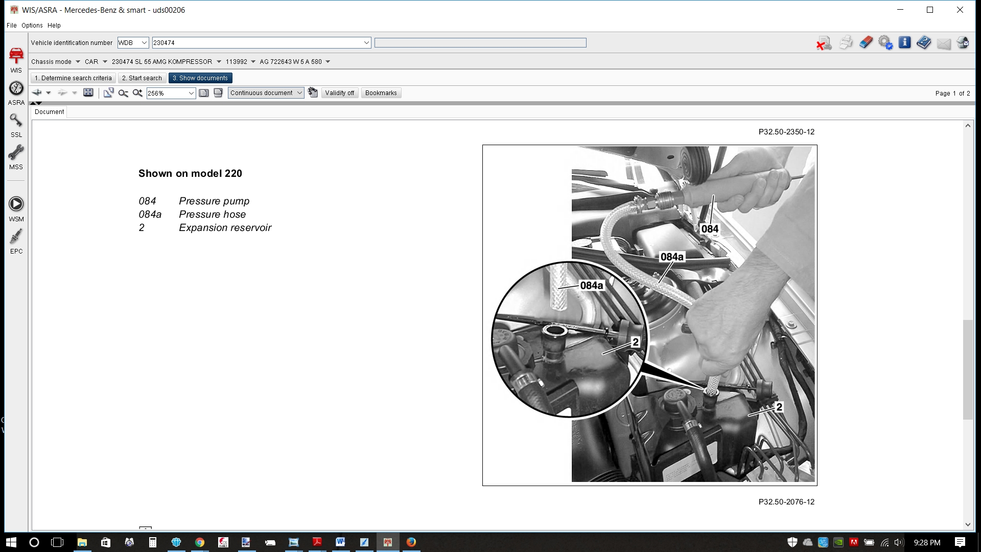

I realize that priming the pump has been covered more than a bit in this thread, but in the interest of clarity I thought I would add a little bit including the specific info from the WIS.
I recently had a leak at the pump output (broken bracket that secures the inline damper to the tandem pump on a 2003 sl55 caused the damper to break at the banjo fitting).
After reassembling the system , I needed to prime the pump. I had trouble getting the correct pressure in the tank to prime it (bad timing, insufficient pressure? ... not sure). So ... went to the WIS and followed the instructions for pressurizing the tank to 1 bar (15psi) AND THEN starting the motor. worked like a champ, and I was able to one-man it.
Attached are the WIS instructions (step 5 and 6 cover it) and a pic of the RIG I put together so I could pump it up (with my cooling system pressure tester).
Grateful for everyone who participates here and help make owning a fine car affordable.

Thanks for this picture of the "RIG" you put together. I'm going to do this job tomorrow. I noticed in your image of the WIS software the picture is so clear. I have WIS running off Virtual Machine software and the pictures are not nearly as sharp as yours. Is there some way to adjust the display to sharpen the images? Thanks in advance.
those were pulled directly off the mercedes on-line resource (back when I had access to a subscription on "STAR Techinfo" ). Just for grins, if I get a chance, I will see how those images compare to the same pages on my Star testers (one with a VM setup and a couple that have an internal drive) and will share if I notice some differences.
