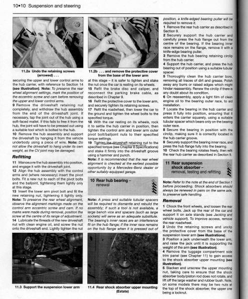

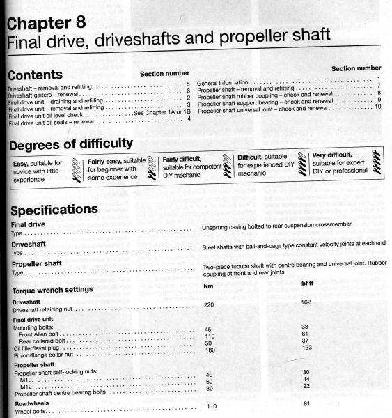

It could certainly be a bad half shaft CV joint making this sound. I have never heard of one going bad on a MB.
My C32 had a torn boot on the CV, which I was able to seal up without removing, but I have plans to replace the boot.
I would find a suitable replacement part, or even a used low mile shaft unit (if you trust the source).
You might want to pull the shaft and replace the parts. Here is a DIY for the shaft on a C32, not an R230...

Thanks ...could not make out the attach instructions maybe page nine needs to be included. Do you think the level of difficulty would be high. The boots look fine. Should be still driveable for a while. Maybe I can query and ask does anyone have a Shop Manual for the R230 for the
