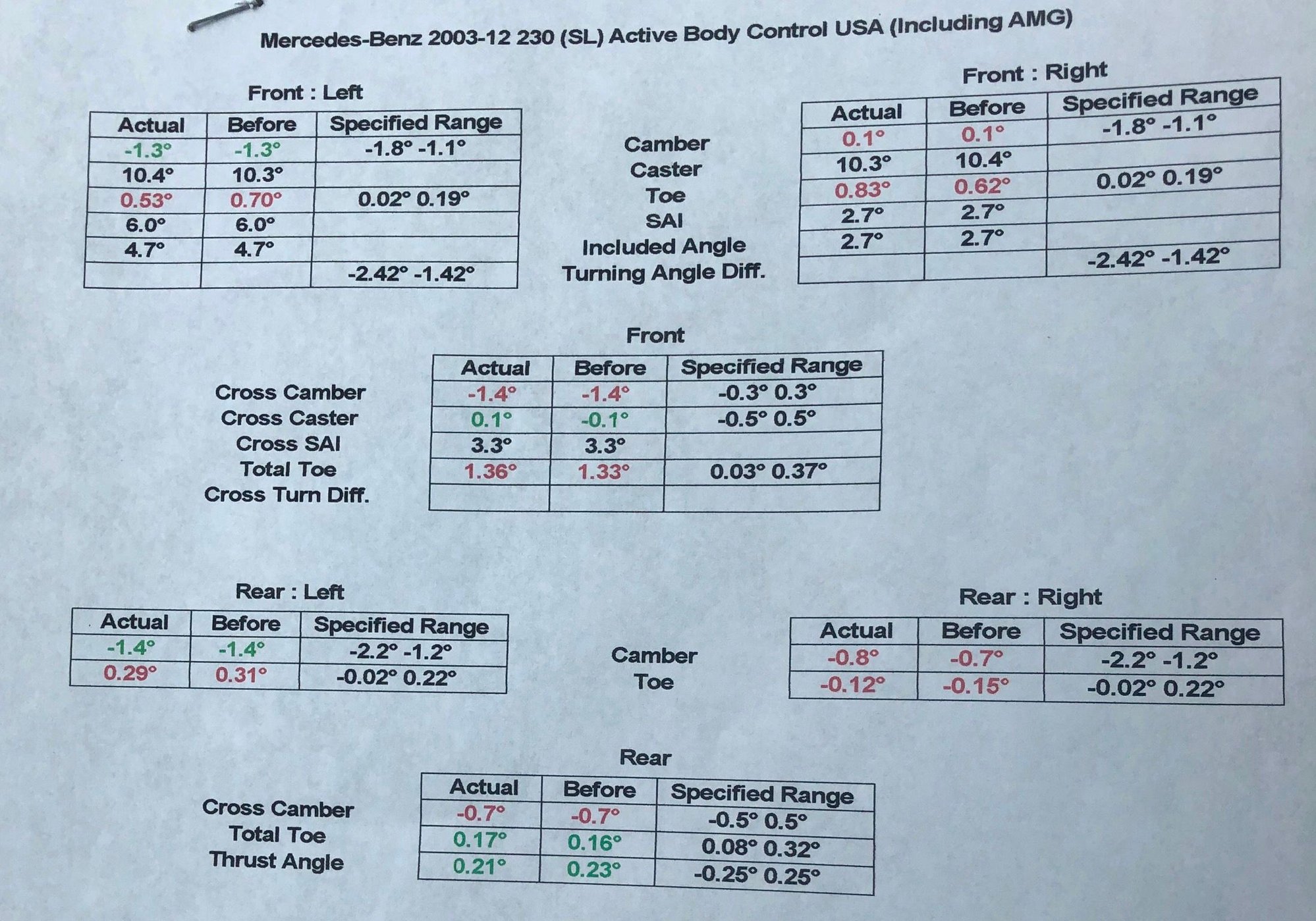

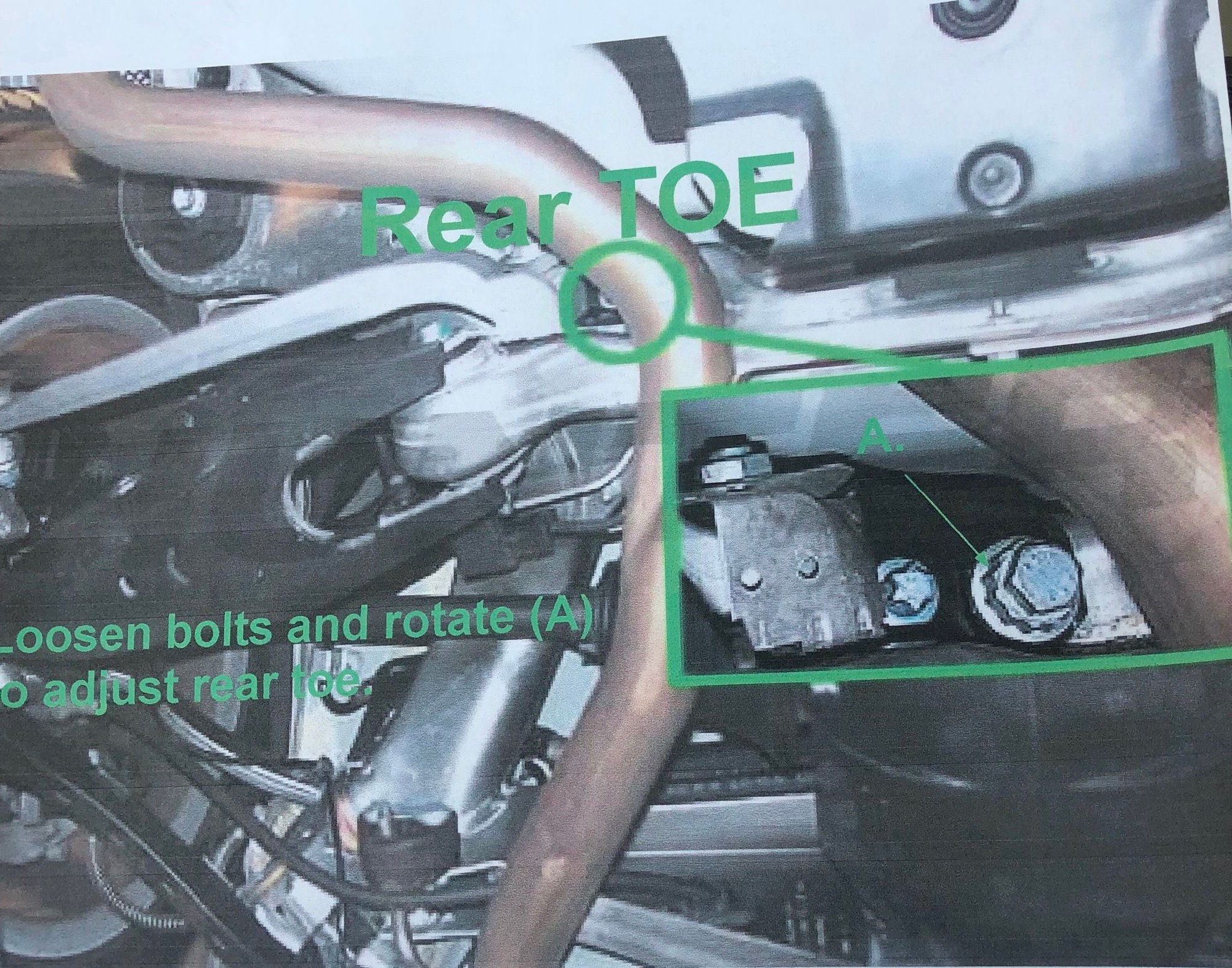

Just returned from Sears, for an alignment, unfortunately it wasn’t completed. I was told that the front was done but the rear wasn’t done, due to a rusted bolt. No clue... I was advised to take it to the dealership, where it’ll be done the right way.
