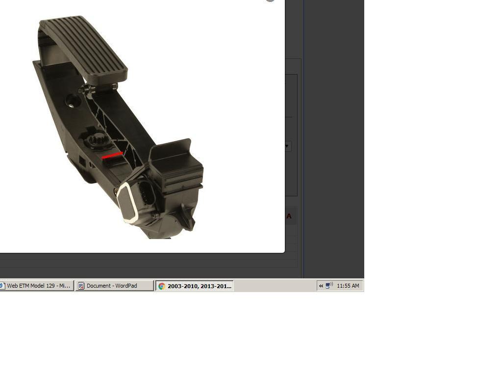

Last year I replaced a faulty accelerator pedal, and the new pedal had the issues you describe.
The maximum voltage on one of the potentiometers is permitted to be c. 4.8 volts, and at wide-open throttle Star Diagnosis revealed that mine was .1 volts beyond the upper limit. I taped a thin piece of plastic over the pedal's stop to very slightly reduce the pedal's travel without interfering with the kickdown switch operation, and the problem was cured.
it’s crazy the things people have to do to fix some of these things. To confirm, you put a piece of plastic between the back of the pedal and the button that clicks when you fully press the pedal? Just want to make sure I’m understanding.

Originally Posted by Amir_AMG
...you put a piece of plastic between the back of the pedal and the button that clicks when you fully press the pedal?
Yes. See the red line drawn in the attached photo.
Getting an appropriate thickness was a trial-and-error process, and I used Star Diagnosis to monitor the potentiometer voltage and get it right.

Thank you @bobterry99 problem solved with a tiny felt pad on the contact point.
No need to order a new part to replace one that has barely been used anyway.
Works like a charm!
