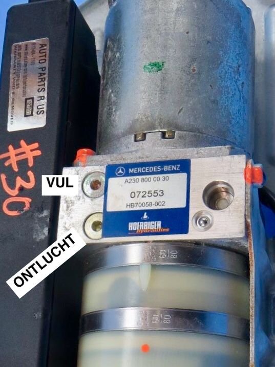

The dealer uses a screw in syringe. The two bolts on top are a filler and a decompression vent. I went for the solution of melting a neat hole in the top of the tank, with a soldering iron. Drilling can cause debris, posing risk of clogging, or worse. Afterwards, a screw and rubber grommet can act as cap. Reliable tape seems okay too, I would then cover up the glue where is sits over the hole.
OEM fluid is ‘Hydraulic Fluid ZH-M’. There’s been some discussion about cheaper alternatives on this forum, but it’s not worth the scavenge, imho.
I bought a few large syringes (without needles) at the local pharmacy, sucked the reservoir dead empty and refilled with new oil (an oil exchange and sucking out eventual deposits were my purpose). I used small hoses on the syringes to penetrate the reservoir, keeping sucking and filling stuff strictly separate. You’d have to re-do a few times for most of the oil in the whole system to be exchanged. After topping up you may have to run a few cycles (roof and roll bar) for air bubbles to escape to the reservoir (sluggish operation). Check level again after that, of course.
I noticed that sucking the oil out of the bottle into the syringe causes air bubbles to form in the oil. Cavitation I guess, not nice. Reason for me not touch the roof switch for a day, to let things settle.

Yes, as stated in my #2 post, one bolt is for decompression (vent). Trying to fill through the port will be difficult as they are tiny. Someone said he used a thin wire, and conducted drops of oil along it.
vul=fill ontlucht=air vent

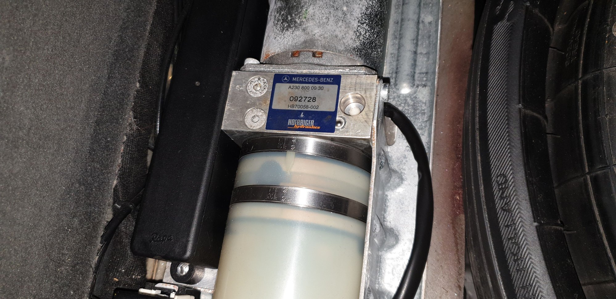

Does anyone know what the correct fill level is for the newer version pump reservoir? Screenshot from WIS for the revised pump... is it to the top of the “+”?
Old Sep 12, 2019 | 07:47 PM
bobterry99's Avatar
Joined: Jan 2006
Posts: 1,982
Likes: 393
From: Atlanta, unfortunately
'09 S600, (2) R129 300SLs, '03 SL500, '03 SL55
I'd regard the specification as being in the range defined by the length of the vertical segment of the "+". I also think the reservoir can be over- or under-filled to a considerable degree without consequence.
