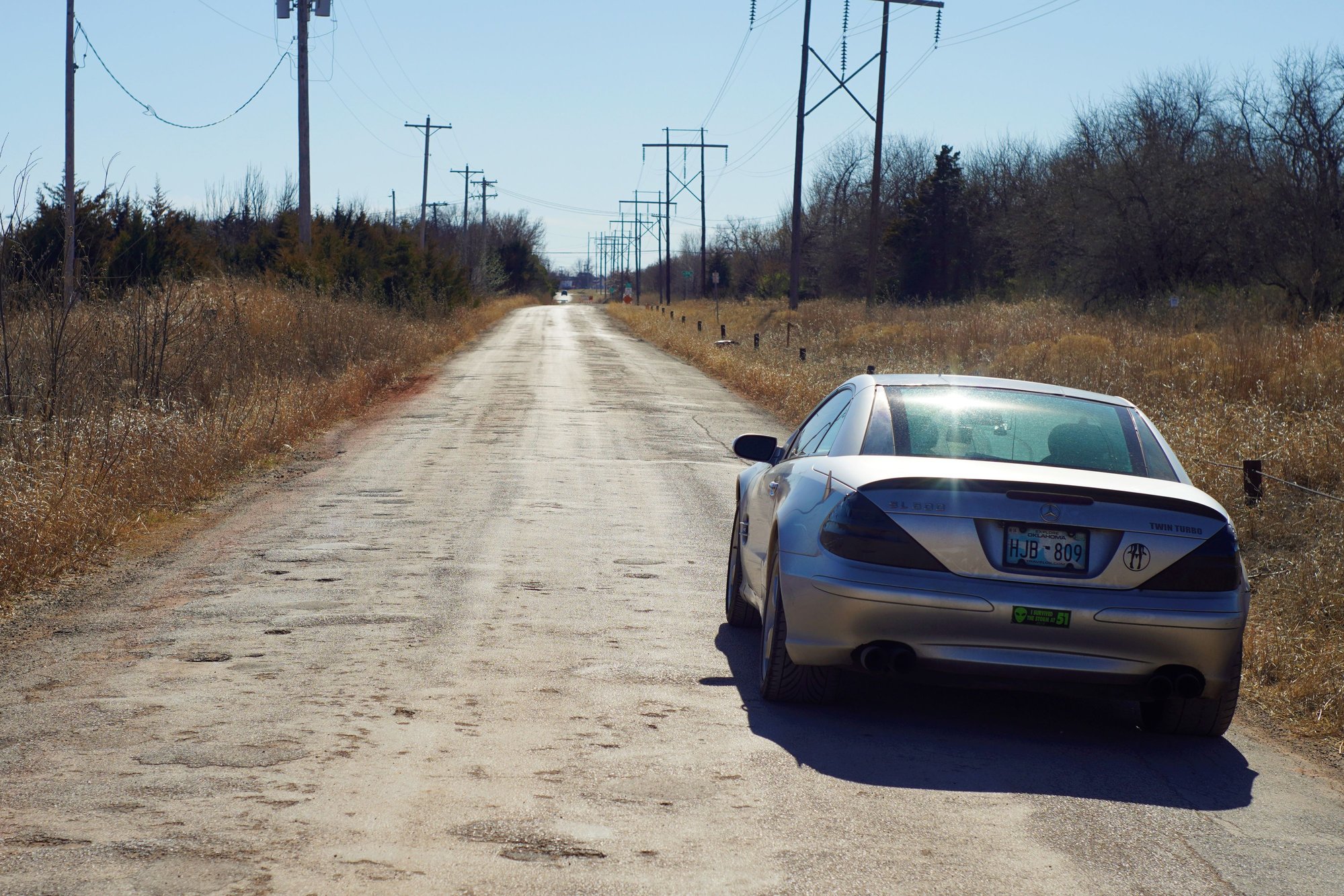

Old Mar 5, 2020 | 08:34 AM
Sl600kd's Avatar
Joined: Jul 2018
Posts: 57
sl600
Endless Roads
