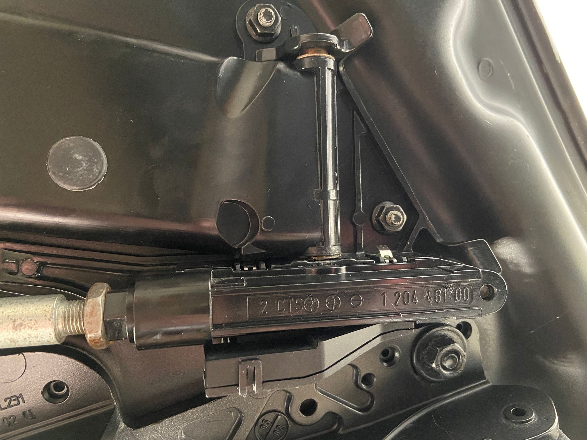

As title , the Gear inside my left rear Roof flaps are stripped, is there any replacebale parts, service items ...
Pic nicked off ebay as im not with my car right now , you can see the gear tho thru the aperture, some **** has yanked on it and stripped the teeth off
As title , the Gear inside my left rear Roof flaps are stripped, is there any replacebale parts, service item etc.. Do they even come apart, i cannot see how it would to rpleace the gear, these are crazy expensive secondhand in the UK so if anyone has a cheap replacement let me know ...

I'm going to look at a parts car this week. I'll try to pick up that assembly cheap.
On your existing one be sure to remove the two screws which secure the flap position switches and remove them.

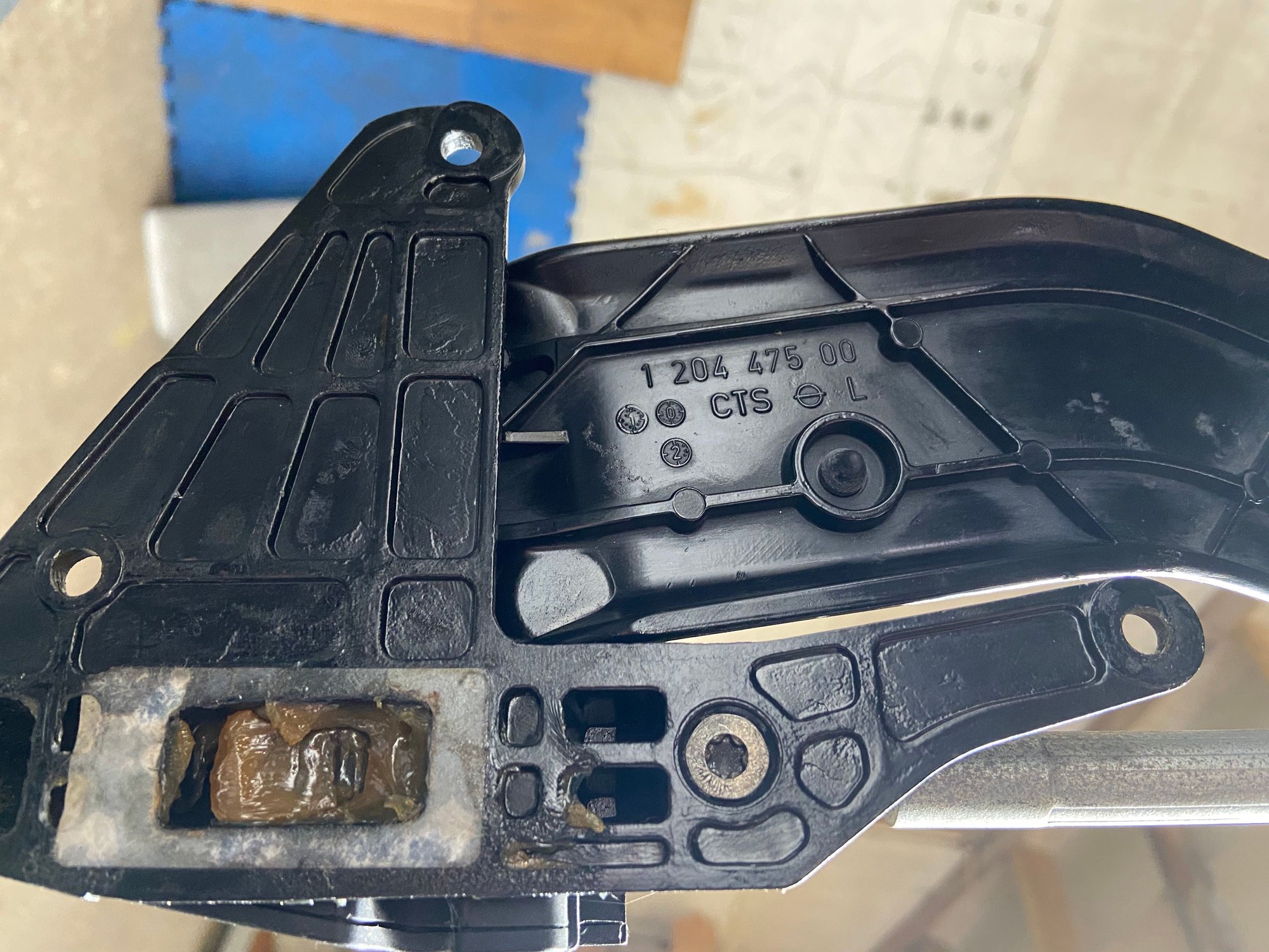

475 00 Left ! The Grease was added to keep the flap Up in postion the teeth on the gear are broken

Thanks but that repair kit is for the top part of the mechanism , when the sliders wear the flaps droop , story of my life ,lol . Its the actual Spindle with the Gear on it im after , not sure how it comes apart but they go together so must come apart !

Its for this bit ...
