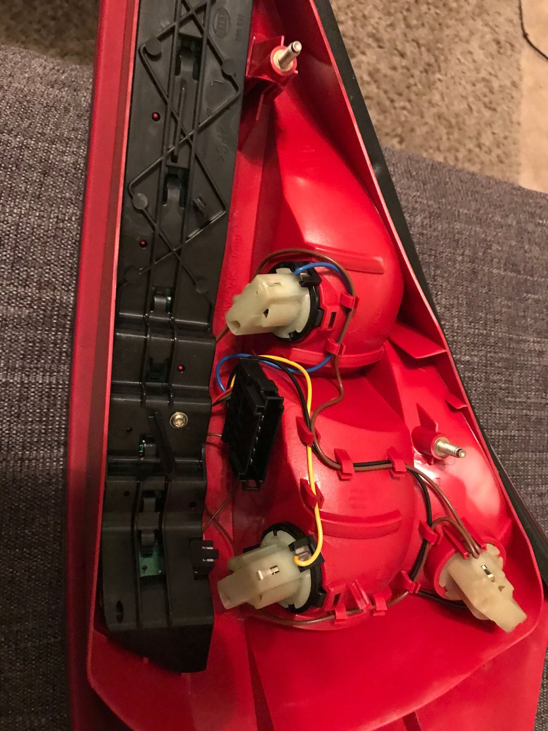

here is my old taillight. Where do I drill these small holes?

I am sorry I only told you a fix that worked in the past for me I cannot tell you where to drill the holes. I have never had the tail light in my hands. I only know if you let the air change the condensation will evaporate. As far as my experience is you can seal all you want but you have to get the water out of the tail light maybe with a hair dryer with some small holes. If you think your effort to seal the entire light will work fine. if it does you can always seal the holes you drilled. as per the picture take out the leds and dry it and maybe use a desiccant to absorb water as a temporary fix.

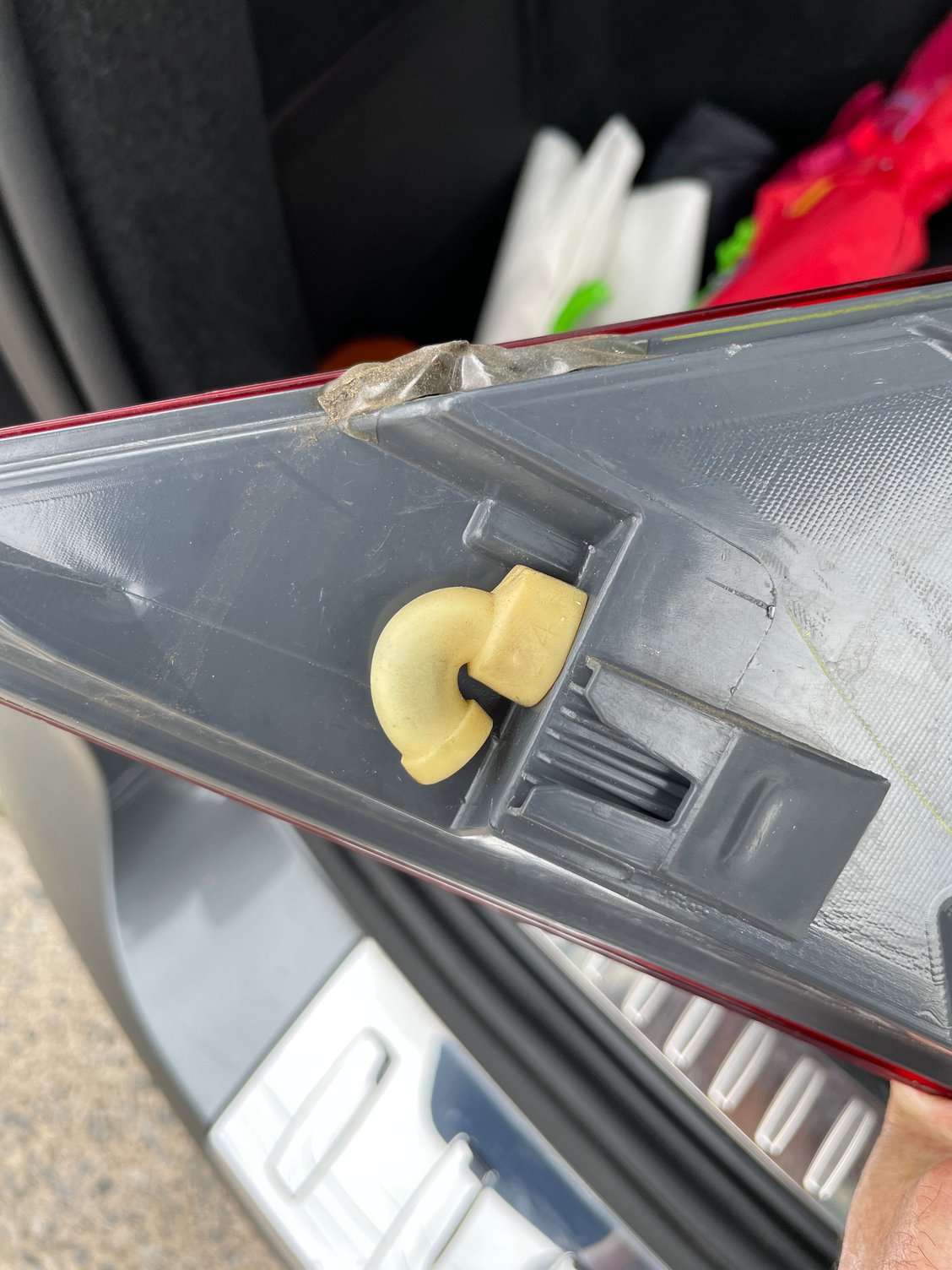

Does anyone know what exactly this is called or referred to as?
I had water condensation in my tail light. When I removed it to find the compromised area I found that one of these were missing. MB said in order to get this piece I’d have to purchase an entire tail light.. lol. Thanks in advance!!
I bought brand new SL tail lights and they continue to fill with water. I drilled 3 holes under the tail light to at least have a place for the water to escape instead of having it fill up. At this point I give up. My mechanic said the car may have had frame damage and the lights are not sitting flush. He made some modifications and still water getting in.
What model vehicle is that tail light for because my SL tail light does not have that piece.....
