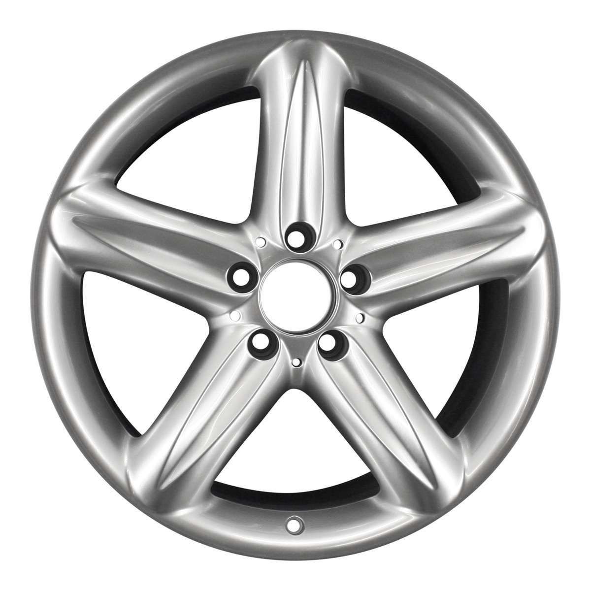

What size and type/style hub caps will fit this SL500 wheels?
Hi All,
I've been trying to find different hub caps for my SL500 stock wheels in other colors other than the original silver background hub caps. For example like black glossy background, or black with Mercedes words etc.
But, what I find on eBay are hub caps with different types of attachment design. There are ones with 3 prongs, and also ones with a a metal circular ring inside that pushes the prongs out.
Do the 75mm hub caps fit the stock SL500 wheel? And what kind of attachment design will fit? I read somewhere that the ones with the metal ring inside maybe won't fit.

The 75mm caps fit the SL500 wheel pictured. I have those wheels and replaced my caps with cheap ones from Amazon. The plastic clips were very tight and it required care to not break them while installing.
The ones I bought were labeled "SB Wheel Center Caps For Mercedes Benz 75mm - Raised Star Wheel Rim Insert Caps (Silver)". The amazon page isn't available for them anymore

The top picture, with the metal ring is what I bought. It was very tight to go in, so I removed the ring on some of the wheels to get it in. I think the caps in either picture would work.

Sadly my wheels are fairly beat up. I pried the caps off with a screwdriver while still on the car. I wasn't worried about scratching the wheel as they have already peeled quite a bit. I don't think my old caps were original as they were cracked and pealing.

I just used a very small screwdriver wrapped with a cloth to pry off. Removed the wire spring ring and the caps went on perfectly - driven @ 1,500 miles - no problems. The caps are so inexpensive on ebay, buy an extra set. The ebay caps are a perfect match (cosmetically) to my OEM.
