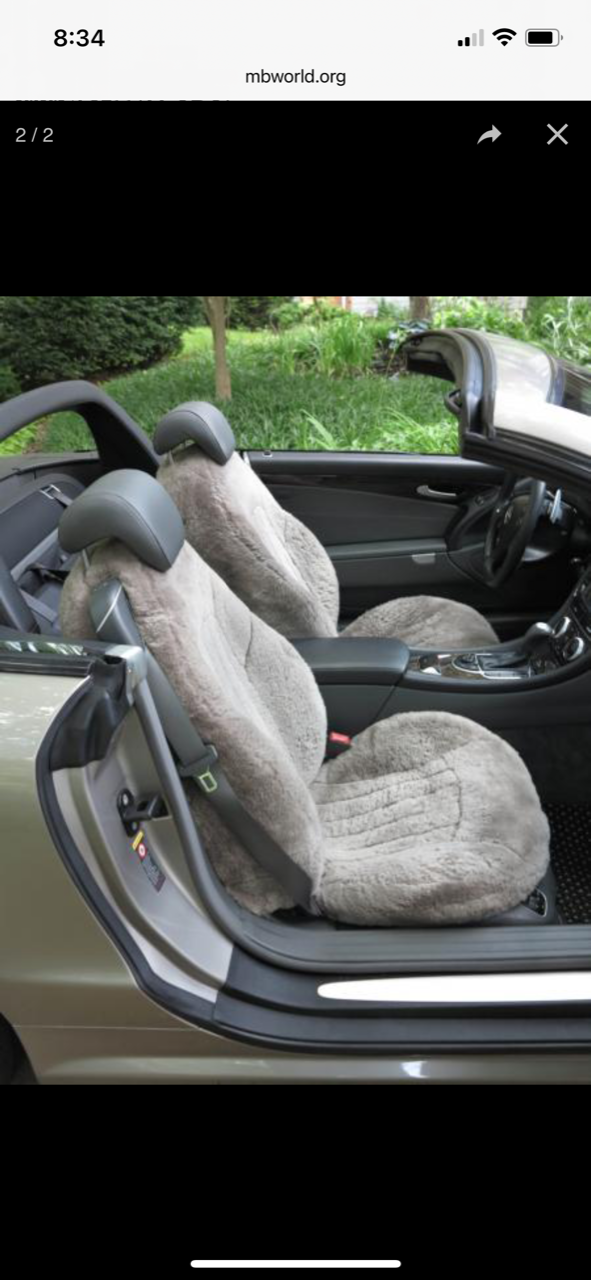

I just purchased a 2007 Mercedes Benz SL550 with 37K miles on the clock. Here is a picture:
Everything works great. However, I do have a couple of quirks that I wanted to ask about. First, after you start up the car -- every 15 minutes or so -- I can feel the massage seats slightly move for a split second. I checked the massage buttons below the seat and nothing seems to be stuck, broken or activated. Not a huge deal just wondering if that is normal or a problem that could get bigger.
Second quirk, I accidentally bumped the shifter from "D" to the + sign and I guess it put it on "manual" mode. I quickly put it back to D and the car would not move. Is this normal? Is there something I have to press to default it back to drive? I had to turn the car off and on in the middle of traffic in order to get it driving again. Weird.
Also, where can I find these exact seat covers!!! Someone in the For Sale section posted this years ago and the terms they used didn't exactly give a brand name. Thanks!

Hello, congratulations on your 07 SL550, hope you will like it!!! As for sheepskin seat covers, I had them on my SL a few years ago. I purchased them off eBay, check this listing:https://www.ebay.com/itm/MBZ-Factory...-127632-2357-0
or search eBay for r230 sheepskin seat
Those covers are generally good, but beware of the following:
a) the seat covers are relatively bulky and once installed, the curvature of prominent SL side bolsters is not being experienced anymore.
b) over the time, sheepskin loses it’s fluffiness in the area of the most body contact, especially on the bottom seat cushion. Appearance of the seats is not appealing anymore.
c) after a few years, the amount of dust accumulated is enormous and a cleaning service could be necessary.
