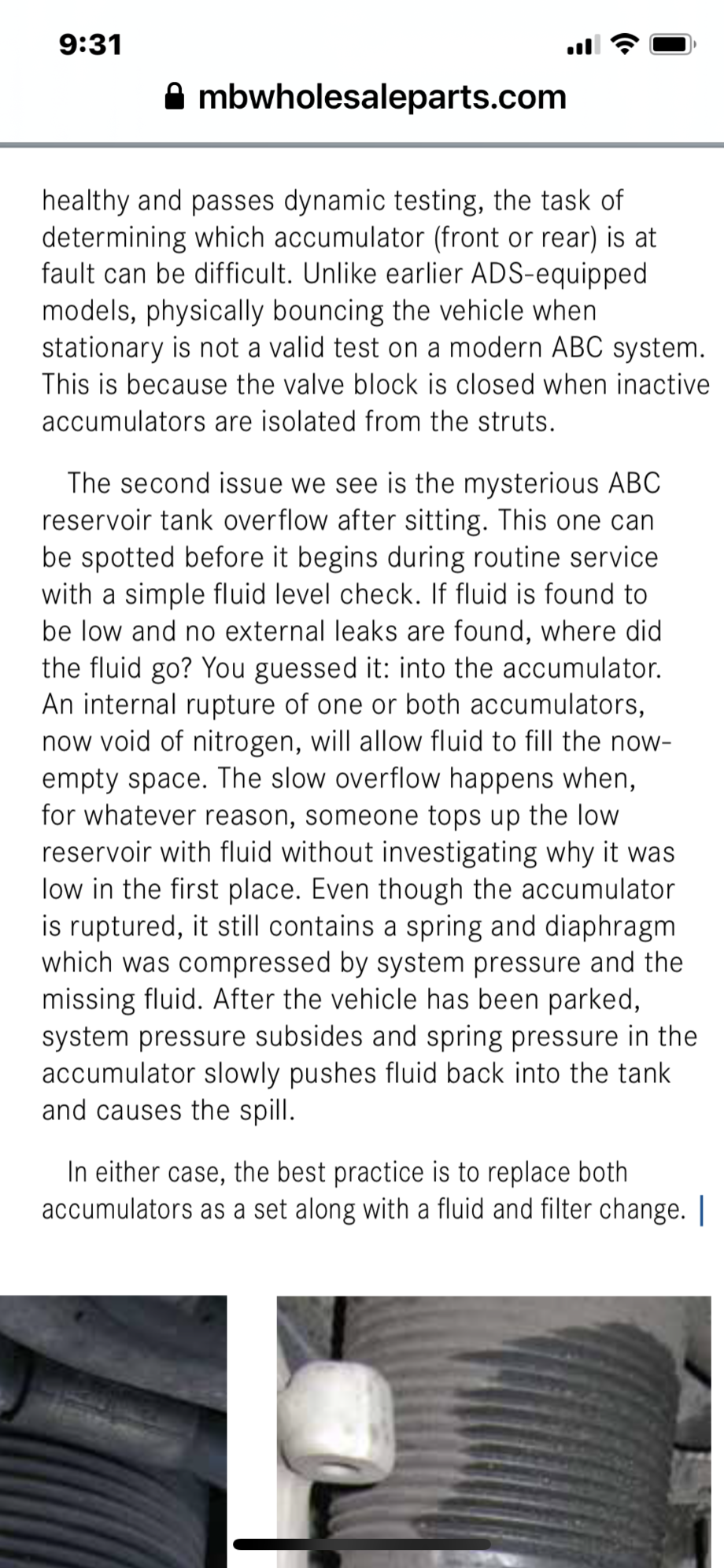

Drove to work, walked out 8 hours later and saw puddle of ABC fluid on the ground (front)
Opened the hood and saw the dipstick for the reservoir was dangling and abc fluid and gotten all over the reservoir and surrounding areas. Put the dip stick back on properly and started driving. Got white abc error and minutes later followed by red abc error.
Before I drop this off to my mechanic I'm thinking I fill the reservoir back up again. Maybe light came on because of low fluid?

Yes definitely fill that reservoir and do not drive the car if the leak is other than a faulty dipstick seating. Your pump will be ruined without proper levels in the reservoir. Major $$$$ to replace. Consider a flat bed tow.

Dropped the car off Saturday. Fluid was a little below the MAX line BEFORE start up. I to was thinking accumulator. Will keep you guys posted

They did a rodeo/ABC flush and changed the filter. All is good (for now)
$400

Keep an eye out for any ABC warnings when driving over bumps. You’ll get momentary low pressure errors when the struts need fluid rapidly if an accumulator is bad. It wouldn’t surprise me if one of your accumulators blew and put a bubble of nitrogen in the system that caused fluid to spew out of your reservoir. Driving with bad accumulators also increases the risk of blowing hoses or damaging struts. ABC accumulators tend to need replacement every 10-15 years.

Exactly what wizee said. You can run the pressure drop on shutdown test to check accumulators. My experience is that a bad from accumulator will throw ABC warnings on bumps, but the rear is not as likely to. Blown accumulators add high stresses to the system, they were put there for a reason.

Got it- that what I was initially thinking- blown accumulator. But they did a flush and all good. I will keep an eye for errors when going over bumps.

I would guess a bad accumulator would rupture and the gas that’s in it would cause the “air” in the system as well as displace the hydraulic fluid, pushing it out through the reservoir like you had.
My guess is that filling and rodeo got the “air” out and there is no more faults from that. The accumulators absorb the shock from bumps , the system doesn’t have a fault code for bad accumulators.
As above, the warning will come on when bumps are hit. If the accumulator is bad, the rest of the system is taking the shock load. I would take the advice above and get the leak down test done to rule this out.
