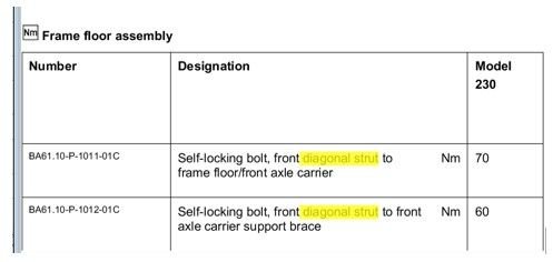

I think this is the thread I found that has the bulletin that describes the procedure. Torque to 12 nm.

Here is the bulletin P-B-46.20/60b PDF file for a little easier reading.

[QUOTE=doitwright;9087406]I think this is the thread I found that has the bulletin that describes the procedure. Torque to 12 nm.
Note multiple torque values in that bulletin.
