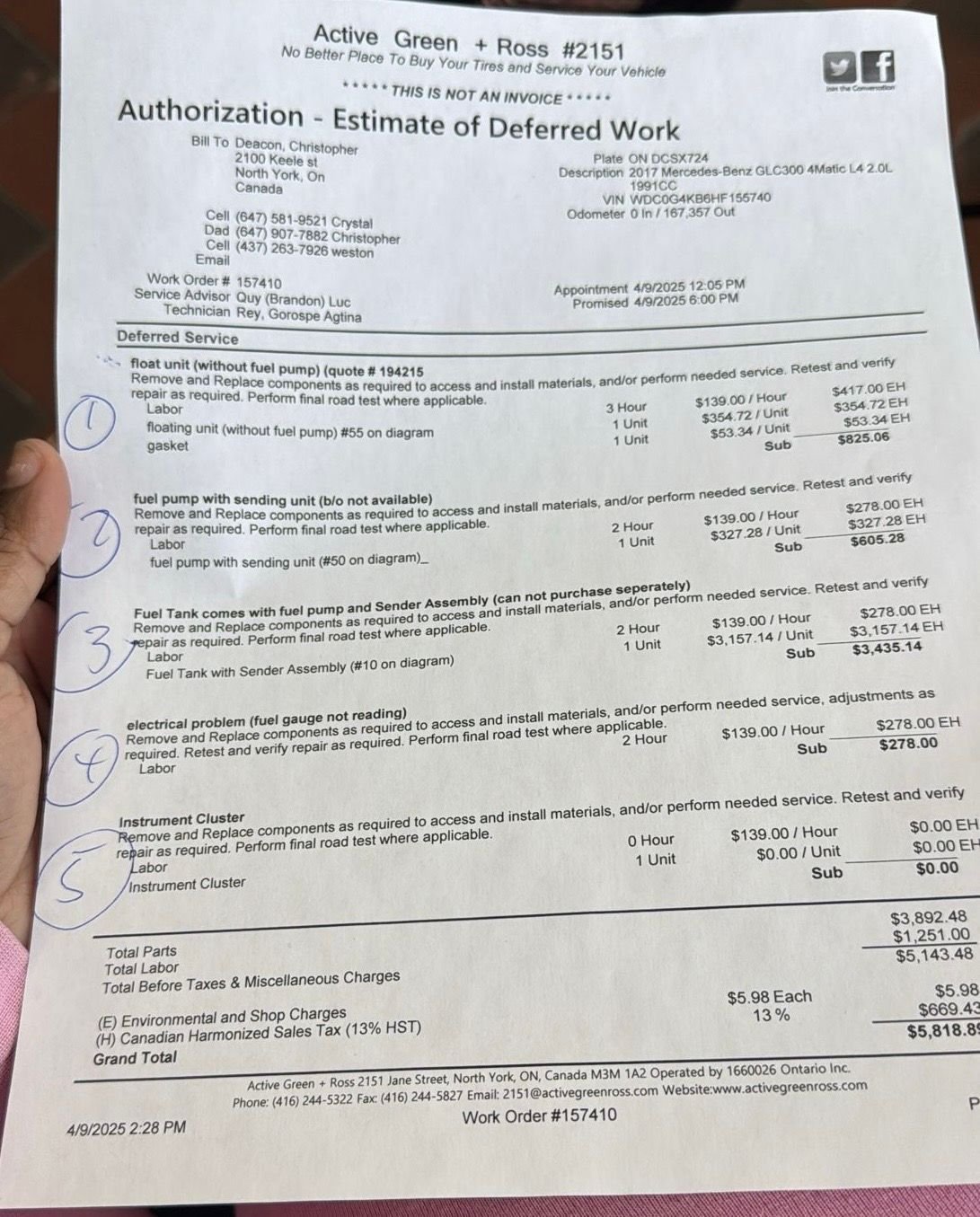

Hi sorry to bother you I have the same car with the same issue over a 3 months now but I don’t know what’s possible cause I bring it to mechanic but they keep telling many codes which I don’t understand am thinking it maybe the SAM or the sending unit but to know if it’s the SAM how can I test it as it’s the only problem everything else works and I don’t know what’s possible cause fuse it use
s

In your case, the fuel level is read by the fuel pump control module. If there are level sensor codes in that module, I would start with Option 1 or 2. The reason that they gave you two options is while the sensor is available from Mercedes, an entire aftermarket fuel pump assembly is cheaper and quicker to replace. There is also a chance that the wiring between the sender and pump control is faulty, or the control is faulty. This is whey they have option 4, in case they need to check wiring, etc.
If you have no codes in the fuel pump module and the module has a fuel quantity that can be read on diagnostics, you might have an issue with the cluster or CAN (network) issues. This would be harder to diagnose and more expensive to fix, but it is the less likely case.
Note: The quoted labor rates are very reasonable, parts markup is 100% or higher.

ok I see I bought and installed a new fuel pump model that I bought from Mercedes thinking it was the issue but unfortunately it wasn’t that case so I assumed it something else maybe the level sensor or something these list I got from the mechanic so in a case he’s not sure as those probably faults is what he got in his case
