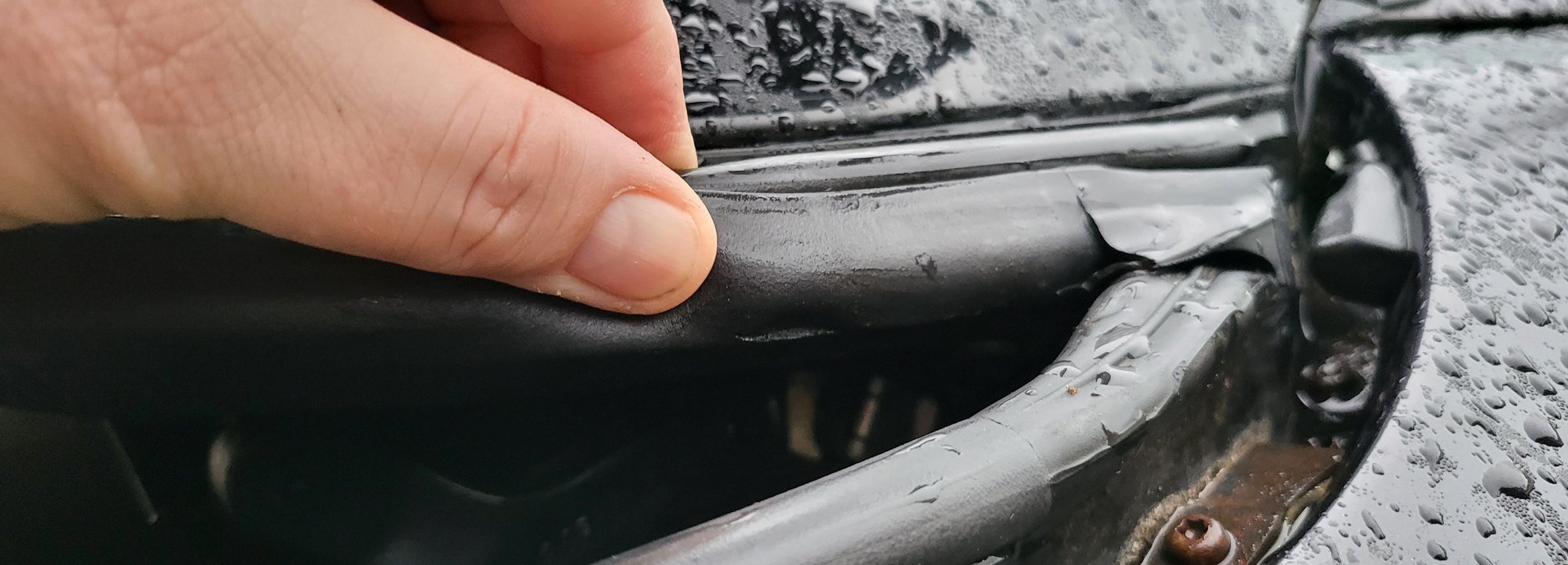

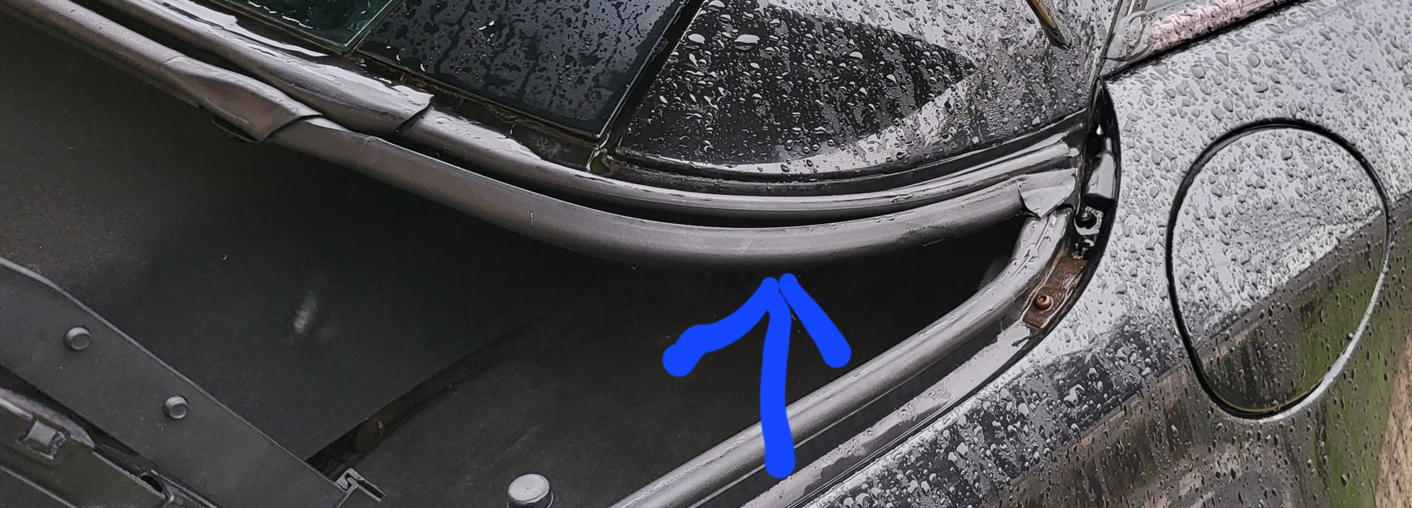

I found the issue, it was a torn rubber seal, can anyone confirm this part as being A2307903098

Or is it thr left side 🤔

You can repair that with a little swipe of RTV sealant/adhesive.

I'll take a bit of a guess that you might also have a leaking rear window seal. Have you shone a bright light up there or run your hand over it and checked for leaks? It's such a common failure point on the 230.
Good idea, will save me £150
I checked for leaks , only place where u had any water drops was from the 4x bolts. I have resealed these and hoping for the best.

The seal in the photo was were I had my issue, I removed the rubber temporarily, cleaned off the rust on the metal lip, painted then applied sealant and re-fitted the rubber seal, all dry now.
