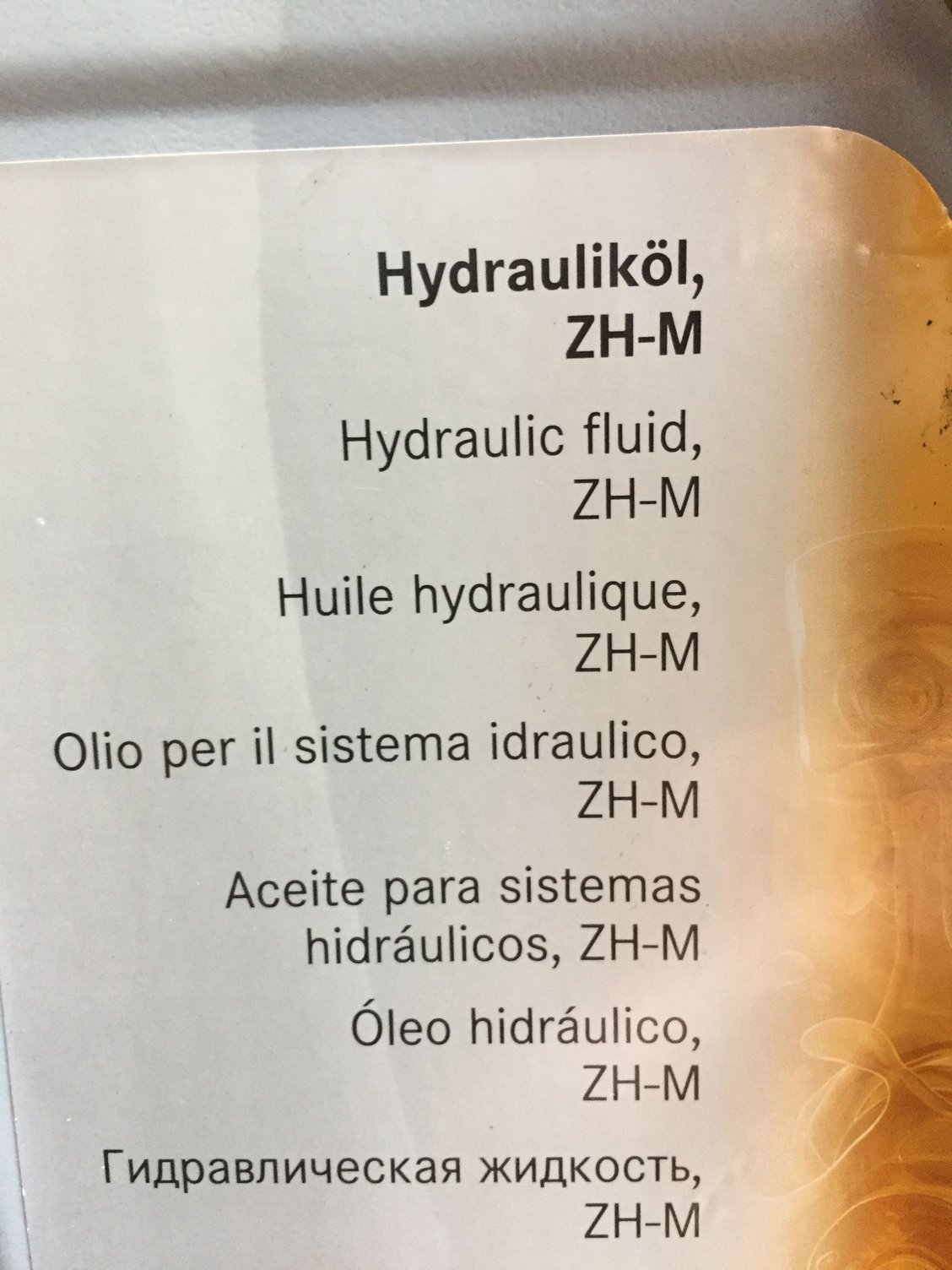

My top wont go down. Im going to top off the fluid and find out why its low. Can I buy the fluid off the shelf? What type hydraulic fluid do I ask for at the local parts store?

Frederick NL's Avatar
Joined: Mar 2018
Posts: 1,442
Likes: 260
From: Netherlands
2005 R 230 SL350 (M112 3.7). Sold the 1966 W113 230SL recently
100% no you cannot, please don't put just any liquid in there. Use the right oil. A bottle of it is not exactly cheap, but on the other hand it isn't an amount worth taking the risk of messing things up for. Available at the MB dealer.
There are technically equivalent oils but I don't know about them (not worth the trouble).
