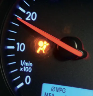

Could anyone post or describe a picture of a right airbag warning light on the speedometer of a US version 2011 or 2012 or 230 version SL. Everything that I see on owners manuals demonstrates that there is an SRS light on the tachometer, and that there is a right airbag warning, light in the center consul region slightly below the round air conditioning bench. This is a great interest to me, because my car is being held up at the border, I purchased a
This is what USDOT is saying it should look like refer to as picture one, supplied by USDOT Claims my vehicle is out of NHTSA safety standards per USA FMCSS regulations. If the data that user in the 2012 owners manuals is indeed correct, then all SL R230 are in violation, show me that I am wrong and I will gladly comply
That speedo with the airbag light does not even look like the same type!

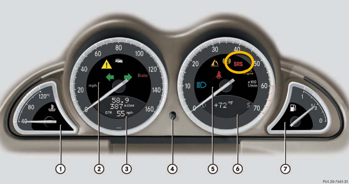

Again

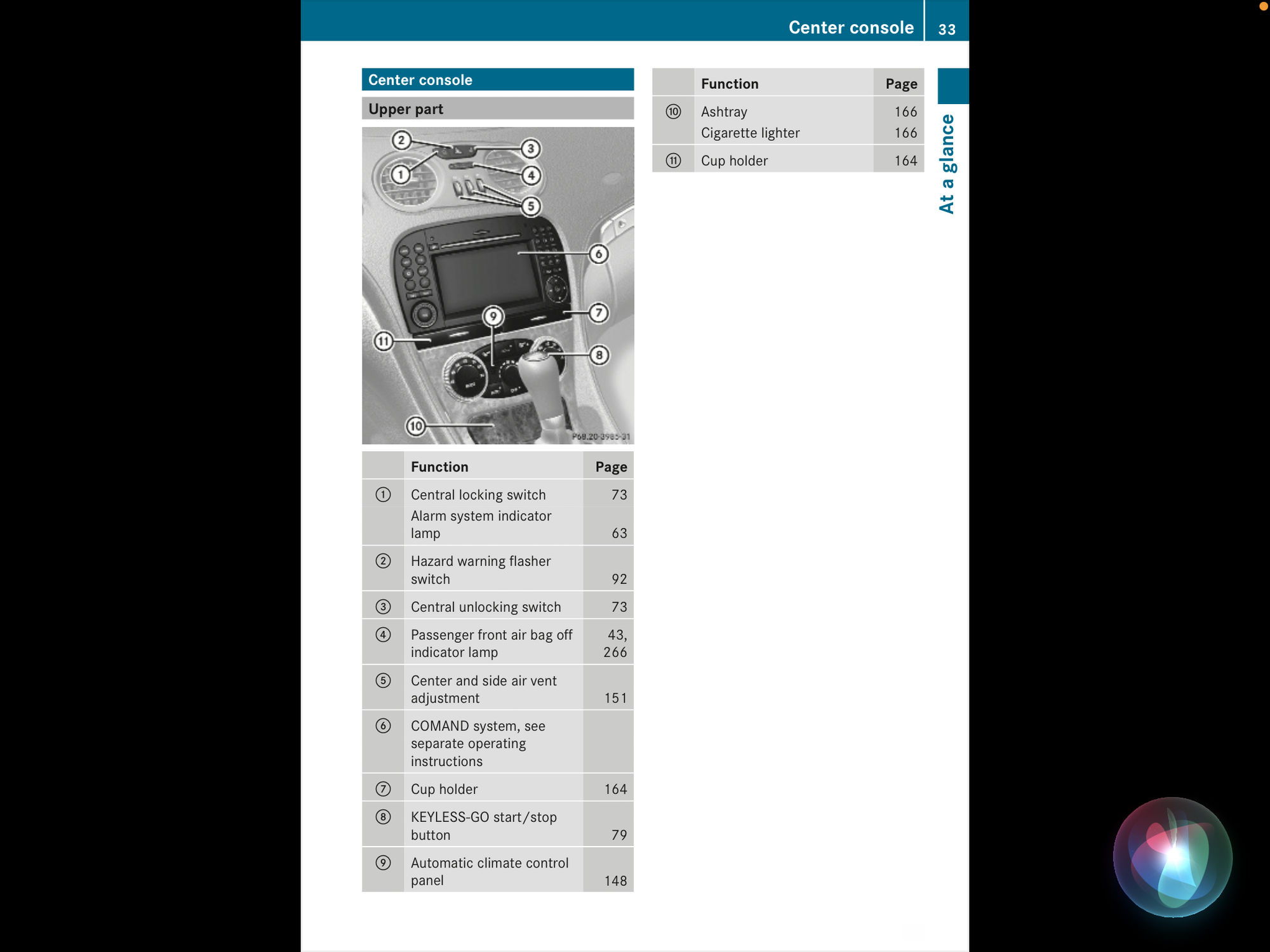

Center console item 4 is the RT airbag indicator

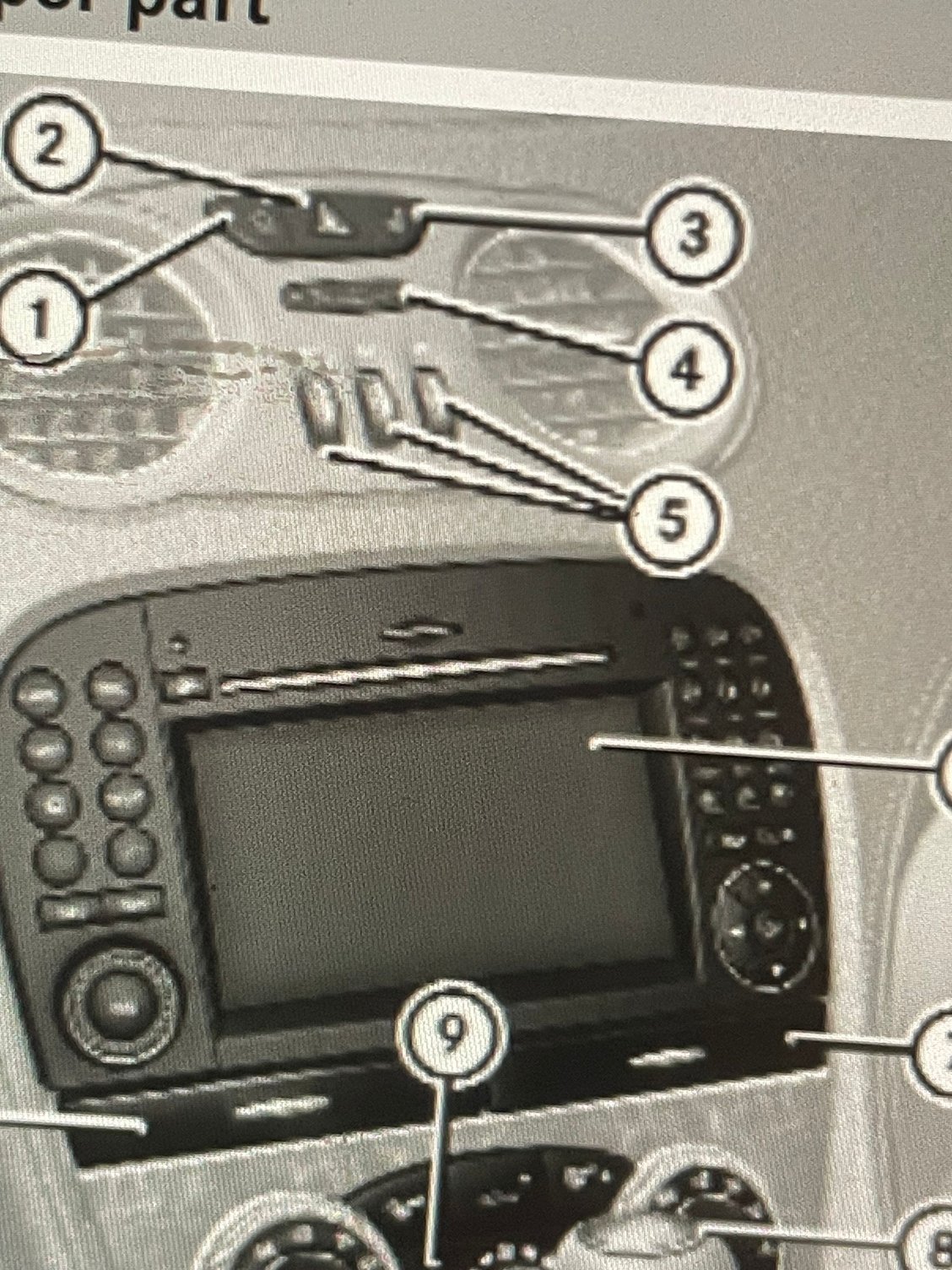

Same

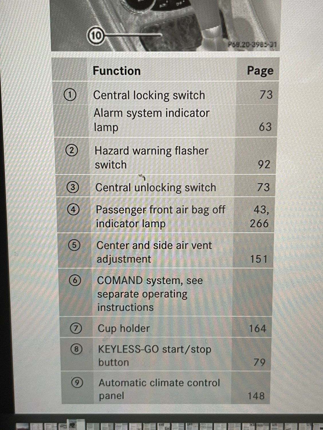

This is the source of all other pix except number one above, this is a US 2012 SL owners manual

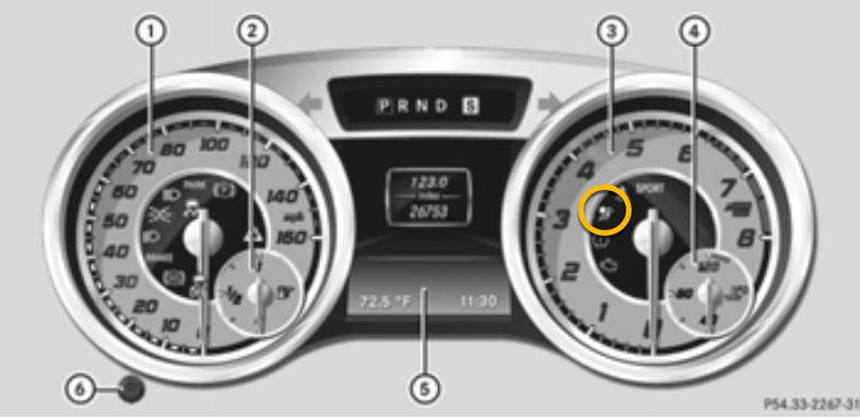

Your first pic looks like the tach in my 2015 SL (R231). (EDIT: Actually, it doesn't look like mine.). I can understand wanting to escape Canada. I'm surprised they didn't say anything about your speed in KM. Maybe you should point out that they need to update their references.
This is from the 2015 SL Operator's Manual

Also, tell them that SRS=Airbag. Kinda amazing that you have government employees performing a function they know very little about.

Lastly, this is also from the 2015 manual. I think we spell out "BRAKE" because the symbol looks too much like the TPMS warning. Then, we also have the ABS warning. But they should be using the correct manual.

I think what you are seeing on the center console is the light indicating when the passenger airbag is disabled. For the airbag to be active, there must be at least 20 lbs in the seat. Less than 20 lbs indicates a small person or child in a carseat, and the airbag is disabled.
This is from a US spec R230 Operator's Manual.
