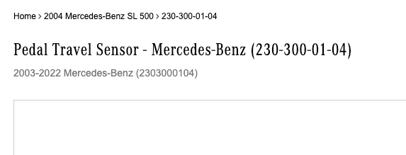

Old Oct 14, 2023 | 10:49 AM
JettaRed's Avatar
Veteran: Army
iTrader: (1)
Joined: Nov 2016
Posts: 7,847
Likes: 3,495
From: Maryland
Here's your part number: A2303000104 or just 2303000104.
Hmmm, the price seems to have gone up on these...
Old Oct 15, 2023 | 08:03 AM
cdk4219's Avatar
Joined: Sep 2007
Posts: 1,481
Likes: 310
95 SL600
It’s a different part number for earlier cars, depending on manufacture date
Old Oct 15, 2023 | 08:40 AM
JettaRed's Avatar
Veteran: Army
iTrader: (1)
Joined: Nov 2016
Posts: 7,847
Likes: 3,495
From: Maryland
Nope. That's the number for a 2004 SL500.
Old Oct 15, 2023 | 09:03 PM
cdk4219's Avatar
Joined: Sep 2007
Posts: 1,481
Likes: 310
95 SL600
Maybe check out part number a2303000004 . Could be superseded with the new part number, but that’s the part number for the early cars.
Your picture shows the 2004 model, my car was built in mid 2002,
The early cars also have different front upper control arms that are difficult to find as well.
