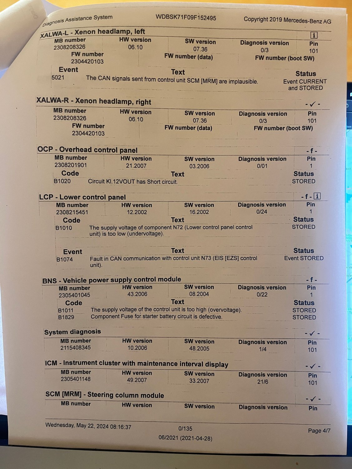

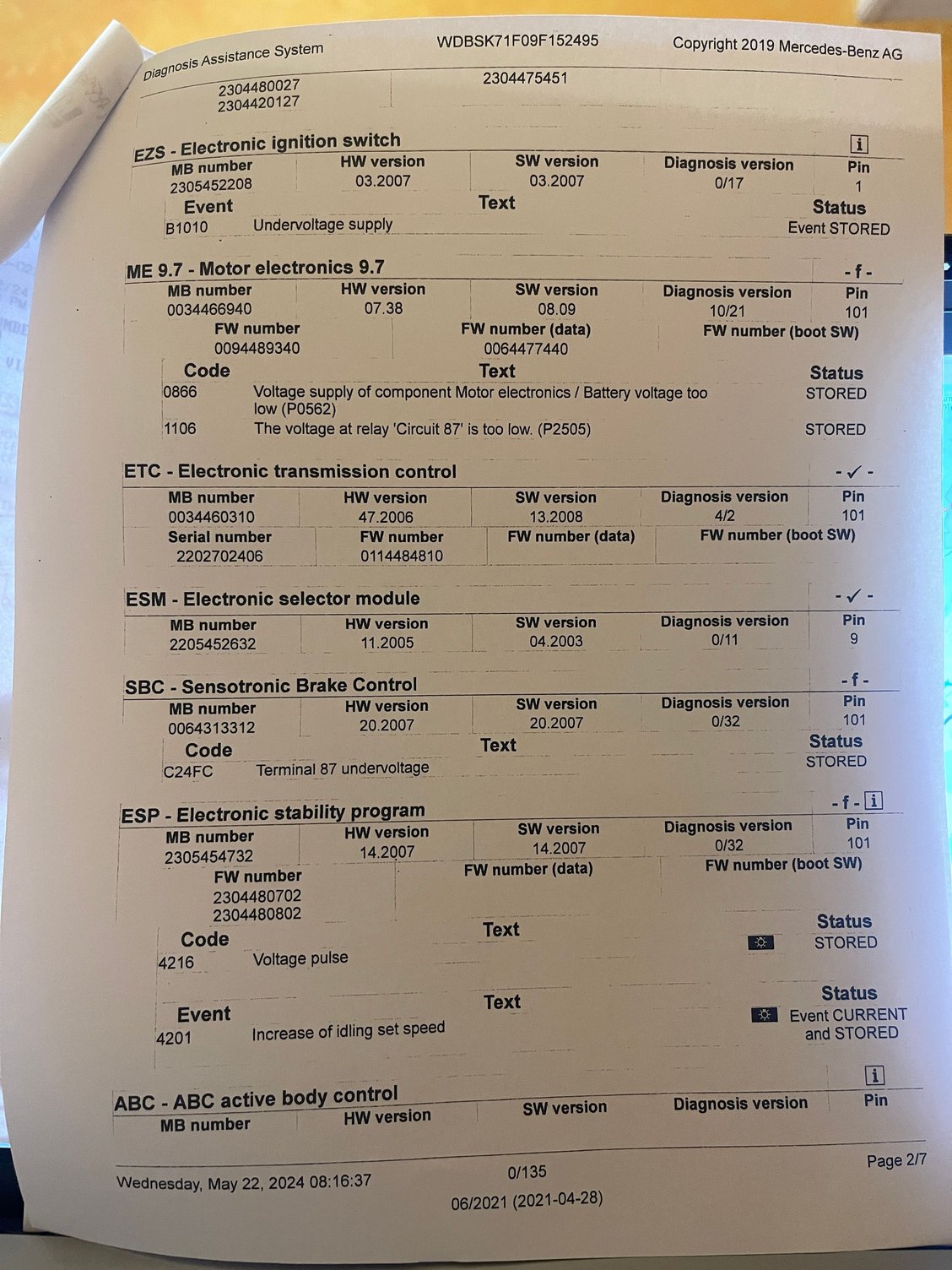

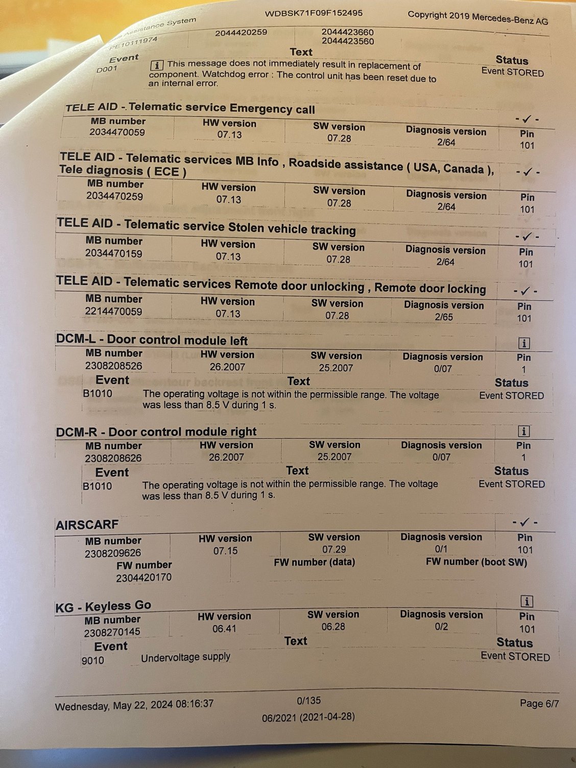

Shop told me the Voltage on the auxillary battery is 3.4 and the car is showing a ton of electrical faults. The battery was is a Mercedes replaced in april and is a March 2024 battery, but they are saying the battery is bad. Gave them the invoice showing the battery was replaced and they are replacing under warranty. I don't think that will fix the issue.
Shop owner says he pulled up some system on Alltech and it shows that the car previously had the PSE and trunk actuator replaced last year. I didn't know it could do that, as I would assume that information is not public information. Is that a thing?

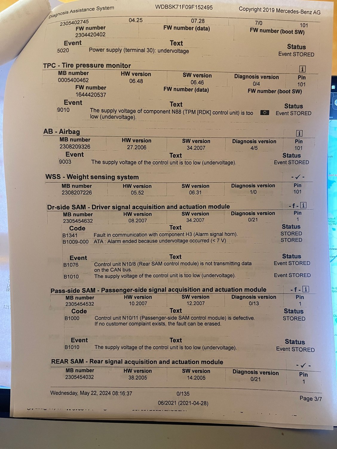

Codes are:
B1000 Control unit N10/8 (Passenger-side SAM control module) is defective. If no customer complaint exists, the fault can be erased.
B1010 The supply voltage of the control unit is too low (undervoltage)
Details are:
Remedy :
- Disconnect battery G1/4 and battery G1/1
- Replace component N10/11 (Pass SAM)
- Reconnect batteries
- Restart DAS
- Startup N10/11
- Carry out operational check
