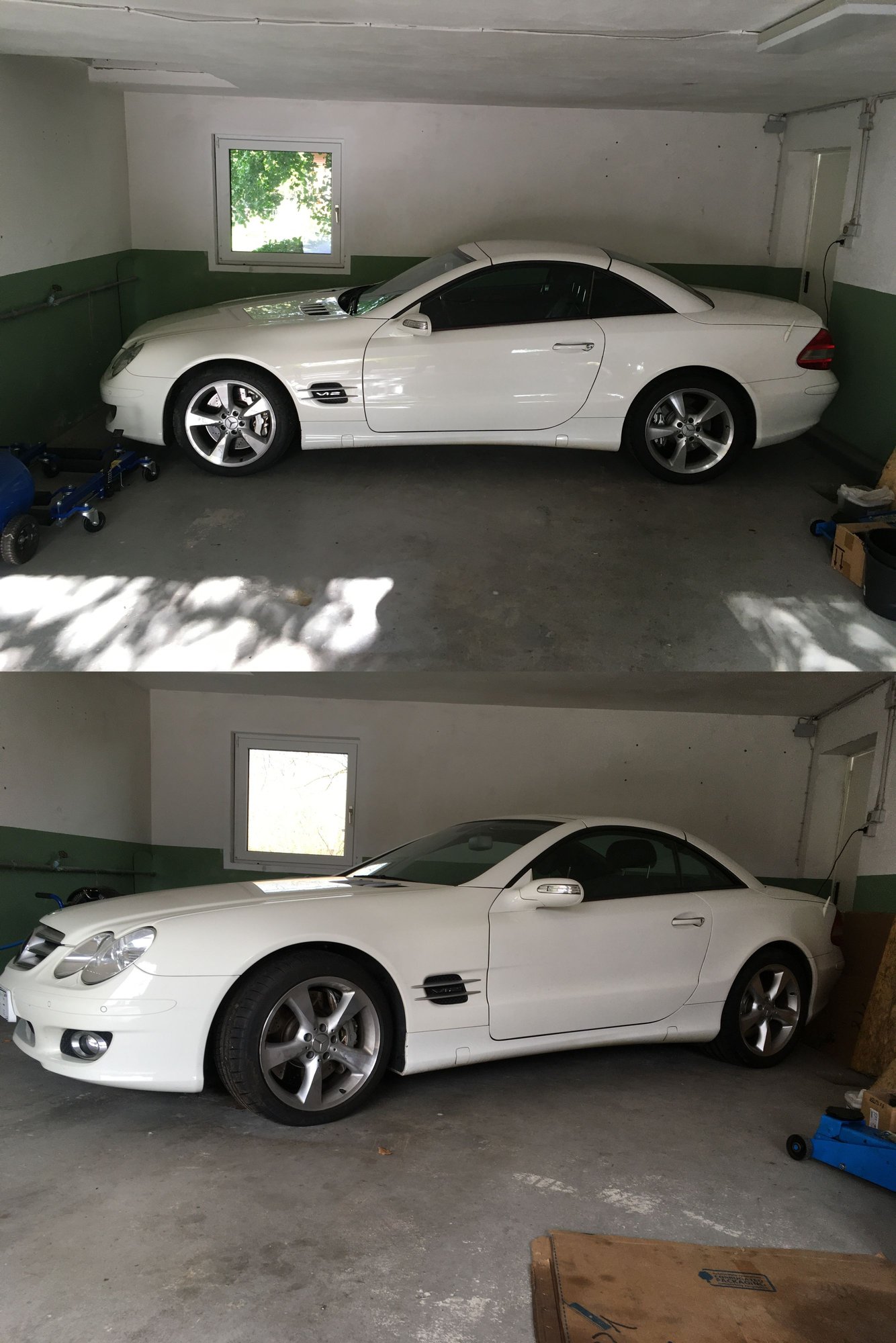

I bought it because of the ABC, not despite it (and of course because of the engine). My son has a R230 with the 3.7 liter engine without ABC. That doesn't make the car that slow, but it really lacks everything that makes a R230 what it is. The car is not driven over the winter, the picture shows the difference in vehicle height after 6 months.
Thanks for all the inputs. Yeah, I used to have several cars on the farm I used to have until my wife went mad. To many cars was one of the reasons for that. Now I live in an apartment with only space for one car in the garage. Thinking maybe to wait with the sl until the next wife and get a c207 400/500 in the meantime.
