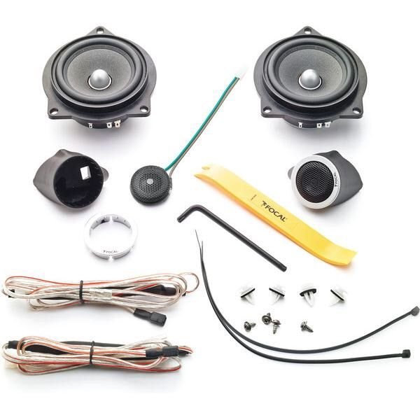

The good news is that Focal makes drop in replacement speakers for the 4" midrange 2 ways and 8" subwoofers specifically to address the Harmon's shortcomings. Connectors are OEM BMW but that's an easy fix.
