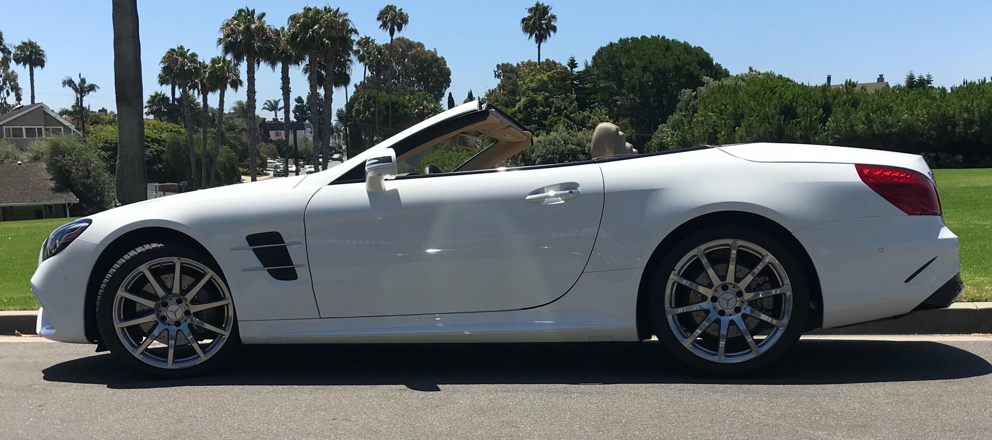

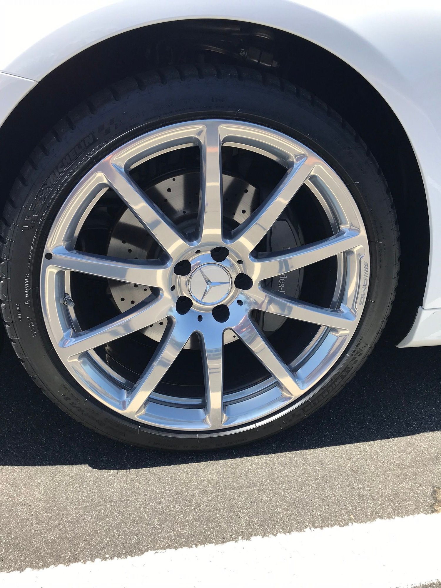

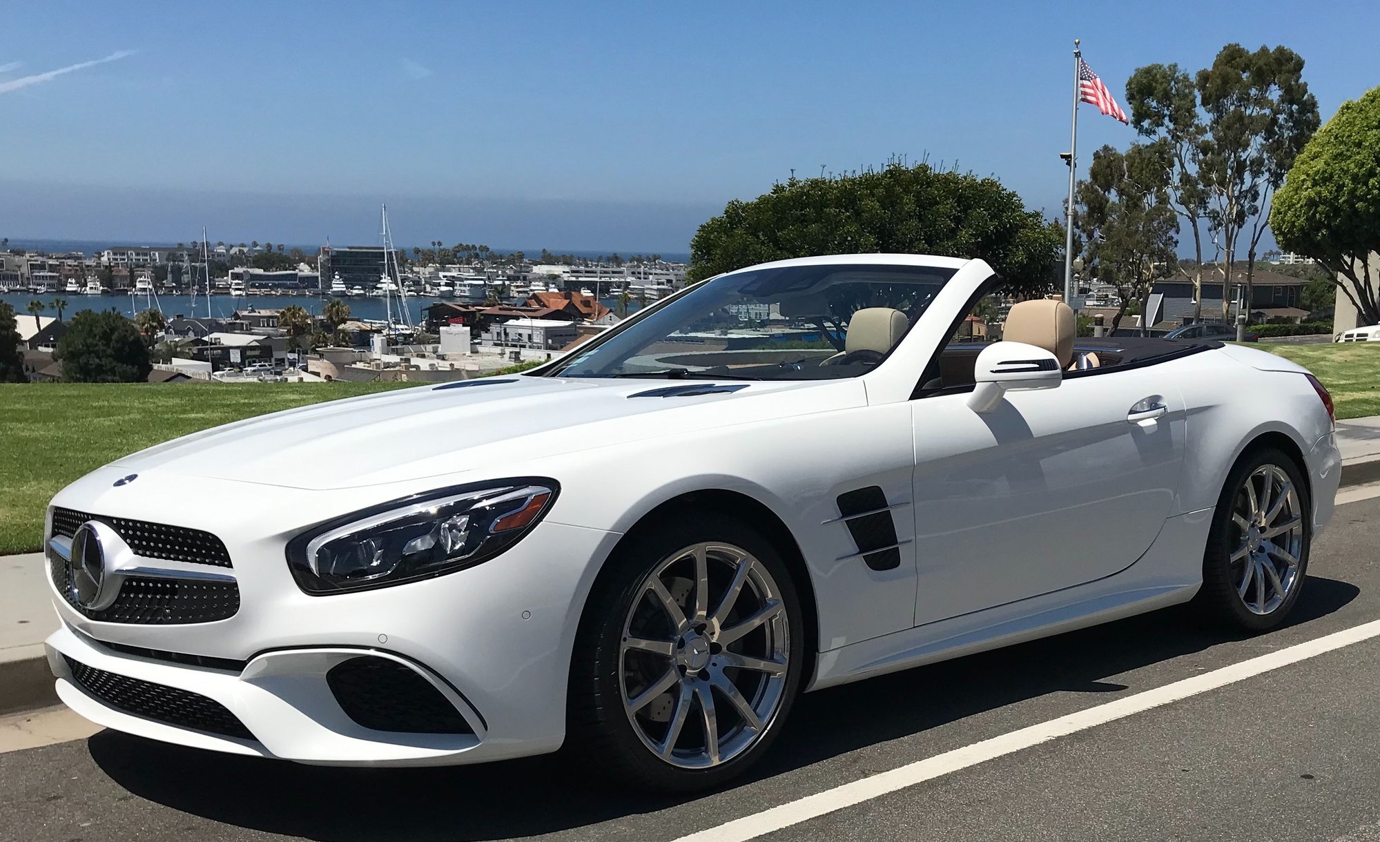

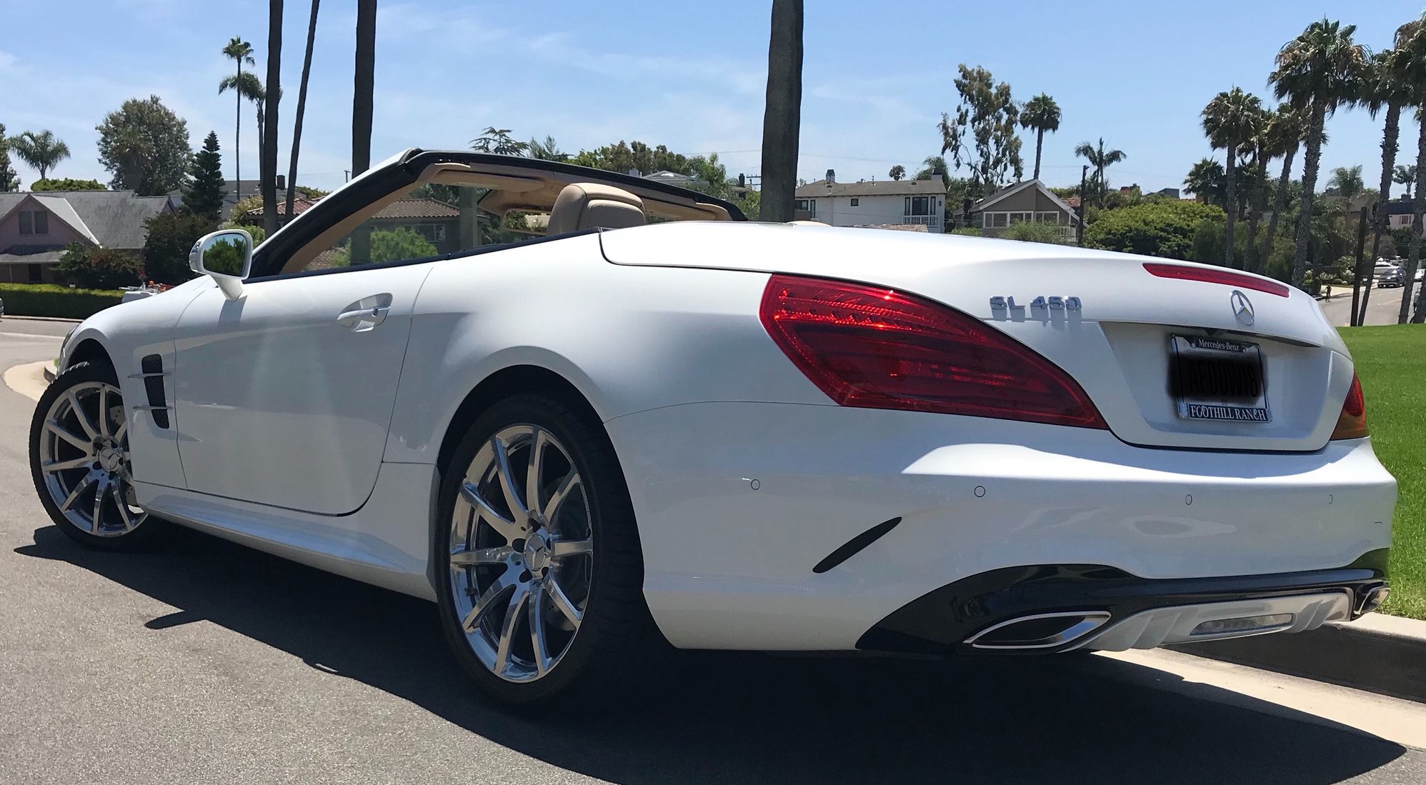

Well, my original thread “New Wheels for Mighty Mouse” got hijacked to a point where I thought I’d just start over. No worries hijackers, I’ve done it plenty of times myself.
Anyway, I bought four 19” x 9” forged wheels, the type used as original equipment on the front of the 2017 SL65 AMG. That car came with 19’s in front and 20’s in the rear, but I did not want 20’s, so after much good advice from Wolfman, TireRack & others, I went with four 19” wheels. I mounted the stock size tires that originally came on my 2019 SL450, but I dumped the run flats in favor of Michelin Pilot Sport A/S 3+ conventional tires.
I’ve had the new wheels for over a month now, but did not want to mount them while the original brake pads were on the car, as I didn’t want the new wheels to get filthy. So, I bought pads from Porterfield Racing Brakes in Costa Mesa, CA and had a local shop install them, as my dealer refused to mount non-stock pads. The brakes work just like with the original pads, but the dust factor is down substantially.
Our friend Wolfman suggested that I might need spacers on the front wheels and said the best supplier of spacers was a place called Supreme Power in Fullerton, CA, which is only about 20 miles from my home. So, I went over there and Eric, the owner showed me his IMMACULATE shop, where they do a lot of high end wheels & modifications on Porsche & BMW’s. He showed me his “No Touch” tire mounting machine and his Road Force balancing machine, so when he said “I match TireRack prices, I knew I had found my tire supplier/installer. Since Eric lives close to me, he graciously offered to pick up the new wheels at my home and will return the original wheels & tires as well. Supreme Power is a class act and if you live in Southern California, I highly recommend them.
So yesterday, I drove the car to Supreme Power and they did the install. It was decided that the car looked good without any spacers and the lug bolt cylinders are so deep, I even stuck with those original, black lug bolts. I did, however, change the dust caps.
As someone who has been damn near militant about run flat tires, I am happy to report that the most current versions are reasonably acceptable. However, I am talking about a car with ABC, so having that really mitigates the harshness. Still, I am happy to report that these new tires do give a nicer ride, especially over sharp bumps.
Lastly, I had wanted to go with the AMG Carbon Ceramic Brakes—and I still might—if and when I find the right deal.
Anyway, Mighty Mouse is sporting some new boots and here are some photos.

Very nice. Surprised you went with all season tires in southern CA.

Called Michelin and they say PS A/S 3+ is most quiet, softest riding tire for the SL. TireRack agrees. The rear tire size is not available as a PS-4, the only summer tire I was considering.

Stream - great summary - and even BETTER pics - a really nice setup !! Now, enjoy the ride.

IMHO, the original wheels suited the car better in design, color(s) combination and function.

They look gorgeous! So I thought the OEM staggered setup was 8-1/2" wide in front and 9-1/2" in back; is it actually 8"/9"? And I know nothing about spacers but why would one use a spacer with a new, wider wheel? Also, when you say "The rear tire size is not available as a PS-4", does that mean you have different size tires F&R even though the wheels are the same size?

Yes, the car originally came with 8.5” front and 9.5” rear. The new wheels are 9” front & rear, but am still using larger tires in the rear. The offsets of the new wheels are different than those on the original wheels, which is why there was the thought of possibly using spacers, but we are talking millimeters and when the new wheels & tires were put on the car, sans any spacers, it looked fine.

I love those wheels! Per our previous discussions, the square setup is a bit unusual but understandable if the 19" max diameter was desired and even the offsets looks fine to me. Was the car raised in those pics? Looks a bit taller than it should. Enjoy!
To ThreeMBs; the 285's on a 9" rims is no problem whatsoever. It would have been on the 8.5" ones. Roll diameter is factory spec and they are much better wheels than the cheap cast factory wheels which are rather fragile. In regards to pricing, what is overpriced is in the eye of the beholder. Some people think spending $80k on a car is too much. That said, Stream got those wheels at a great discount.
I personally prefer the 19"/20" combo but think that this wheel design makes for the best looking wheels available for the R231 SL

Congratulations on the new wheels. Personally, I feel that the design you chose is much more fitting for the aesthetics of the R231.
I agree that the OEM brake pads are horrific for brake dust. I also found that surface rust would immediately appear all over the MB steel rotors if left to sit in the rain for a day or two. While you have already made and are comfortable with your decision regarding aftermarket brake pads, I personally would be rather uncomfortable with something so safety-critical that was not necessarily designed in tandem with the rotors.
I will note that the carbon-ceramic brakes make no brake dust whatsoever. Additionally, with your shiny new wheels, you should most probably be able to have them bolted on directly, with no difficulty or complications at all.

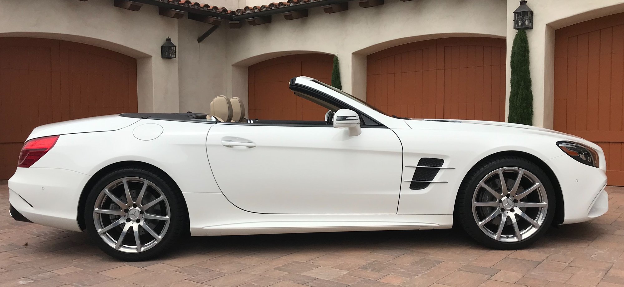

Thanks Wolfman, I probably would not have made the switch without your sound advice. Your help & expertise are very much appreciated.
I don’t think I had the car raised in those photos. Here is another photo, with the car definitely in the lowest position. It does look like a bit of lowering may be in order. I’ve read posts where you mentioned how lowering a car with ABC is very simple. How so?

I must say, those wheels do fit that vehicle to a T! Well played SL, enjoy many more miles and smiles! Damn that is a good looking car (even if I am a bit prejudiced).
