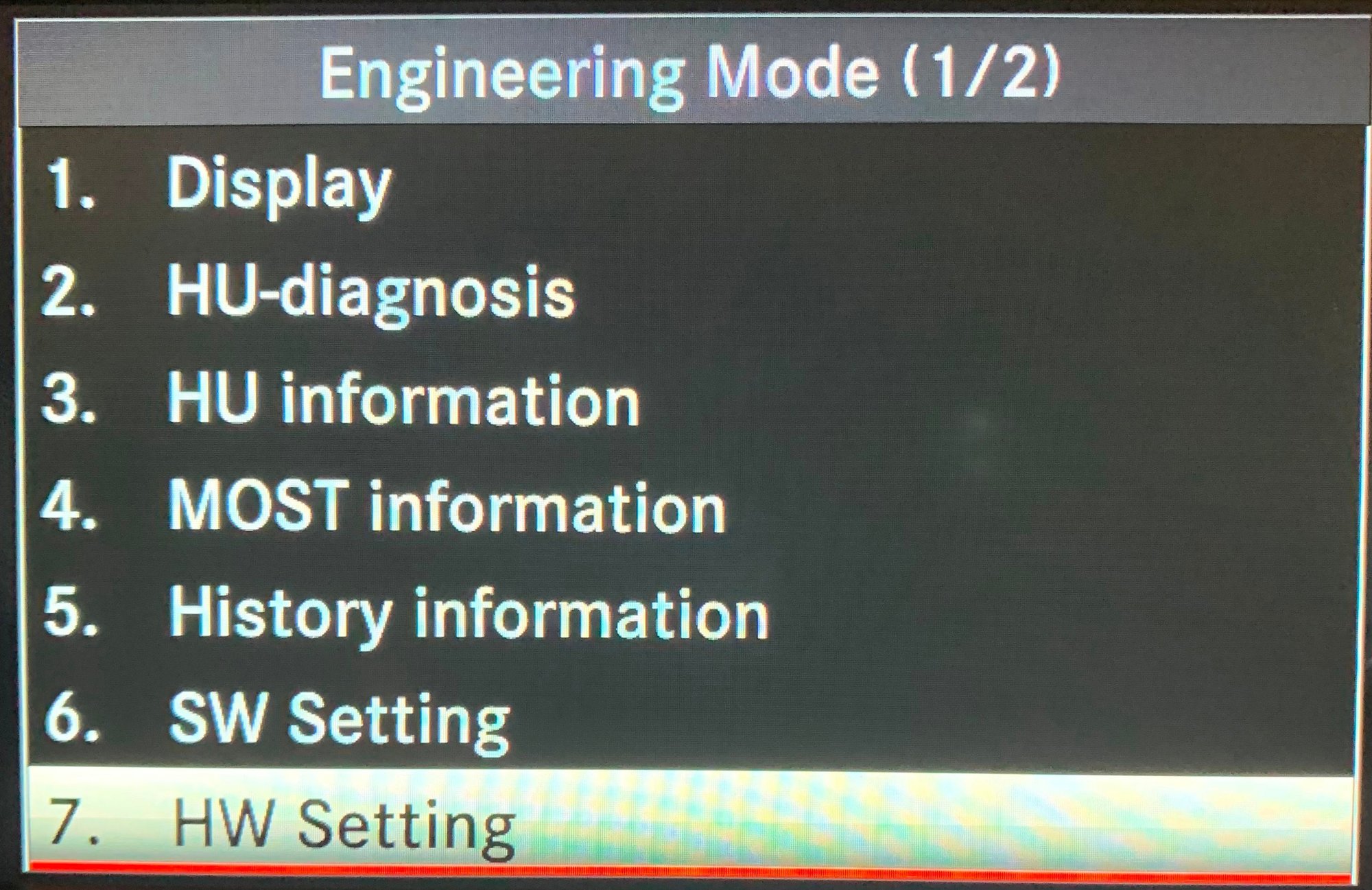

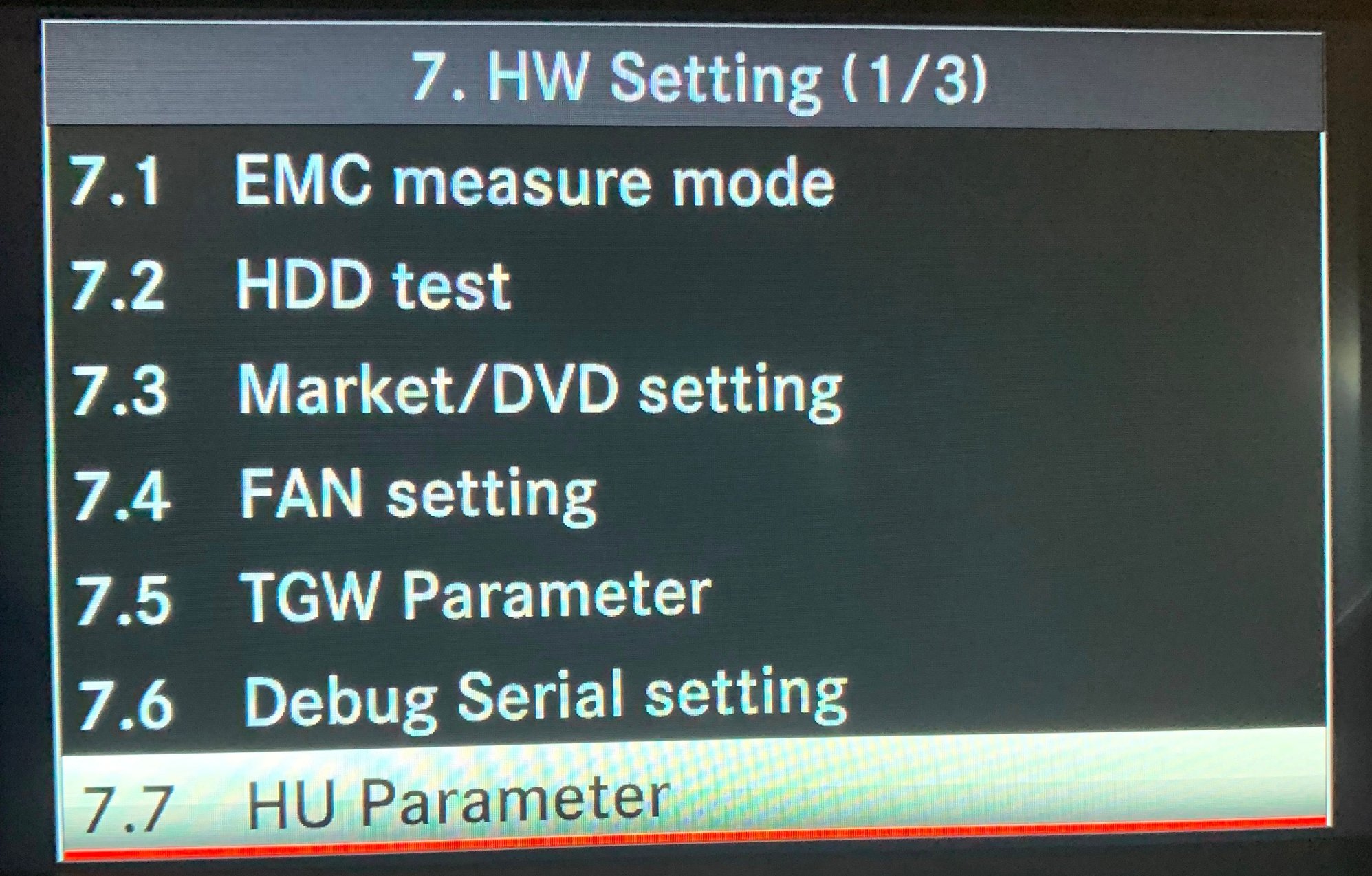

I know that there has been a lot of discussion, frustration, and complaints about the sound system in the R231 SL. On another group, I posted detailed instructions with photos on how to activate the speaker fader control. This will allow you to control the volume of the back speakers without adding any amplifier or changing any wiring. I did this on my SL 550 about eight months ago and it works very well. These instructions only work on MY 2013-2016 pre-facelift R231 SLs with Harman Kardon Logic 7 sound without Apple Car Play.
How Activate the Rear Speaker Volume/Fader Control on the R231 SL with Logic 7 Sound Comand NTG 4.5
Note…This only works on MY 2013-2016 R-231 Pre-facelift SL without Apple Car Play.
1. Enter Engineering Mode...This is performed with the engine off, ignition on, and on the Comand/Audio system number pad under the video screen. Push and Hold the Red Phone hang up button, the number 1 button, and the # symbol button at the same time. Hold all 3 buttons at the same time for approx. 5-10 seconds or until the engineering menu is displayed on the screen.
2. Using the Console Control, scroll down to number 7 (“HW Setting”) Press the console control to select.
3. Using the Console Control, scroll down to 7.7(“HU Parameter”) Press the console Control to select.
4. Rock the Console Control back to scroll all the way down to number 49 (“ Speaker Control”) Note…Rotating the console control will not allow you to scroll through the numbers to this point, rocking the control back will scroll to the proper point.
Press the Console Control to select (“Speaker Control”) Scroll down to highlight (“Balance and Fader”) and press the Console Control to select.
5. On the Console Pad press the back button until you return to the (“HU Parameter”) screen and then scroll down to (“End”) and press the Console Control to select to exit the (“Engineering Menu”). The Comand system should reboot at this point.
If the system does not reboot, without turning off the ignition, turn the Comand/Audio system off and back on from the button in the center of the volume control under the display screen to register and save the new selection.
Now back on the home screen, scroll to highlight (“Sound”).Along with Treble and Bass, the Balance and Fader control should be on the screen which will allow you to fade more volume to the rear and control the volume of front and back speakers as well as balance from the console control.
The Fader Control now should allow you to control the volume of the front and back speakers. This function works with Logic 7 Surround on or off. The fader settings that you set will be remembered until you change them. Each time that you turn Logic 7 surround on or off though, the speaker fader will need to be readjusted to your preference as it will return to the middle factory set point. I find that for my preference the system seems to sound much better with Logic 7 Surround on and the fader set to (-5) for the front speakers. At least now you can control the volume of all of the speakers.
I would also like to add that I would not recommend changing any of the other settings in the Engineering Menu and there are a lot of them. I am surprised though that Mercedes decided to not have the Fader control active from the factory.
I hope that this helps and Happy Motoring.

Does anyone know how to get to enginerring mode to change the speaker balance on a 2017 SL450?
Thank youin advance.
Hello, Does anyone know how to go into enineering mode to open the speaker balance on a 2017 SL450?
Thank you in advance for the information.

As far as I know, this only works on 2016 & earlier R231 models.

Just did this on my 2014 SL550. I tried it multiple times yesterday and it didn't take. This morning, I gave it one more shot, and it worked. Guess it needed to sleep on it before deciding it would accept the reprograming! 😄. Really helps to balance out the sound. Thanks for posting this fix for the radio fader control BBay!
