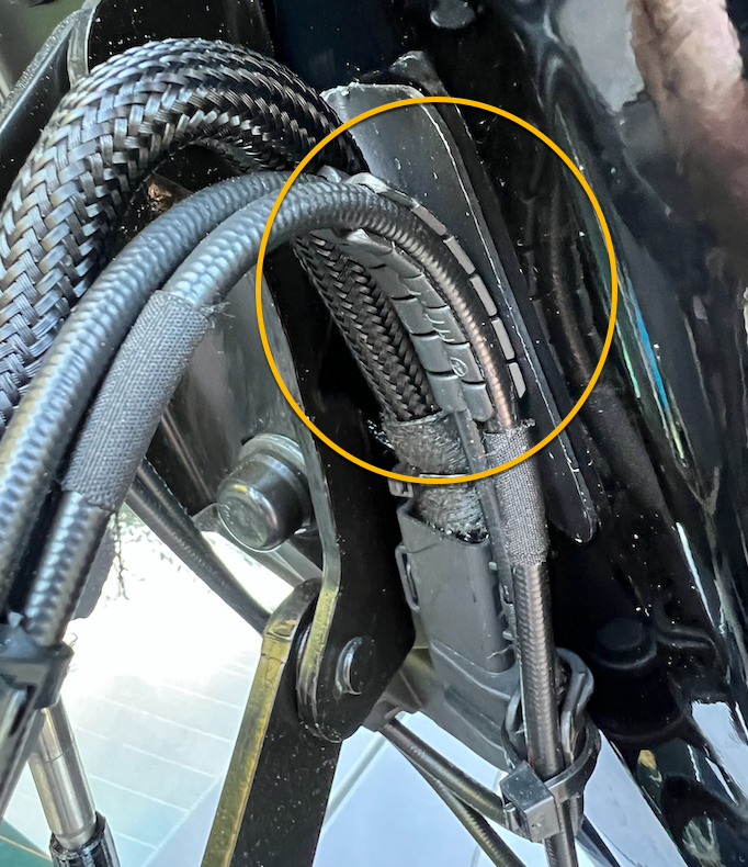

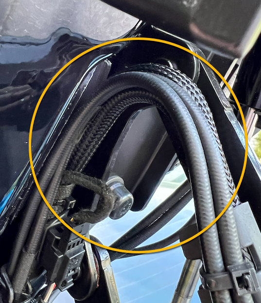

Originally Posted by steve sl550
Jetta
Your "strain reliefs" are not positioned correctly.
If the "strain reliefs" were properly installed (should be located where the bend occurs) you would not have a kinked line and no leak.
I just checked mine and my plastic segmented strain reliefs (just like yours) ARE installed correctly.
So.....I would say you have a complaint even if out of warranty that MB should cover.
Others should check their lines and if the strain reliefs are not correctly positioned (should go over the lines where the bend occurs) they should be fixed by owner or by MB
Interesting, but the repaired line does not have the strain relief. Both were removed.
Driver's side (repaired)

Old Oct 11, 2023 | 05:06 PM
JettaRed's Avatar
Veteran: Army
iTrader: (1)
Joined: Nov 2016
Posts: 7,847
Likes: 3,496
From: Maryland
Correction, the ones on the other side (right/passenger) do have strain reliefs. I may have to discuss this with the service advisor the next time I go to the dealer.
Passenger side.
