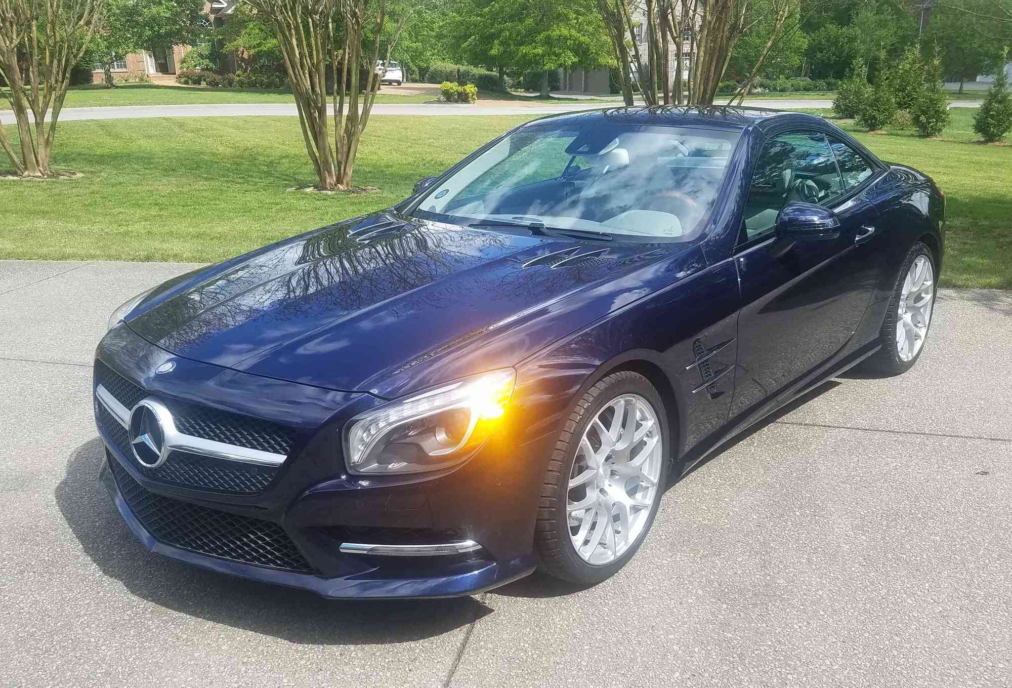

In the first two years we had our R231, we 'cracked' two rims; when the third cracked, I went aftermarket with wheels from Avant Garde. For the next three years, zero cracks; I am a believer in the aftermarket, or the forged AMG wheel. They were still in great shape when we parted with the car a bit over a year ago.
AG wheels on 2013 SL550.

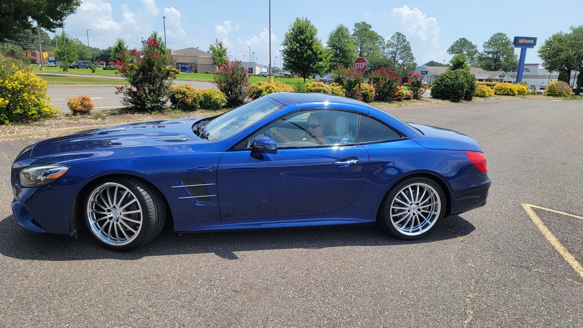

We had one leaking air and cracked. We had another that had been welded and fixed before we bought the car. We replaced them with these Mandrus wheels. We like the looks and they are problem free. The Mercedes replacement wheel was $1200 plus tax. We have really liked the car and the pros outnumber the cons by far. But some things I would think they would do better.
