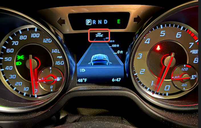

Pre-Safe Functions Limited

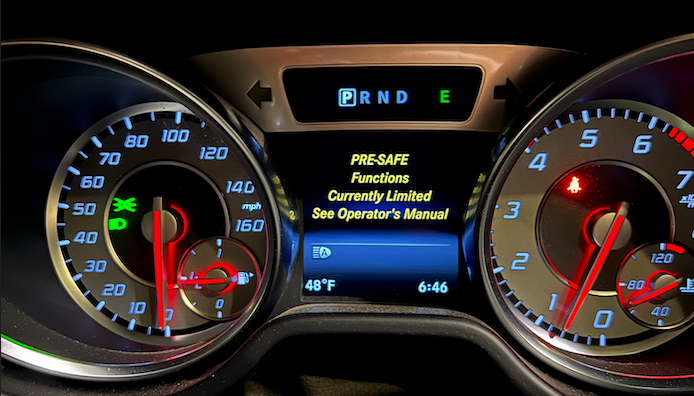

I got the warning on the dash after doing an electronic throttle calibration using my iCarsoft MB V3.0. BUT....there are no stored codes using the iCarsoft scanner, my LAUNCH Creader Elite BENZ reader, and even Xentry. I haven't driven the car, but am thinking I may need to drive it a bit to allow the other systems (e.g., ABS) to adapt to the reset throttle control.
Anyone else experience this or have any thoughts?
Thanks

1 lock the car, keys away, 15 min
try again
2 remove the + from main battery 10 min
try again
tips: stop using icarsoft and autel junk for anything else than reading

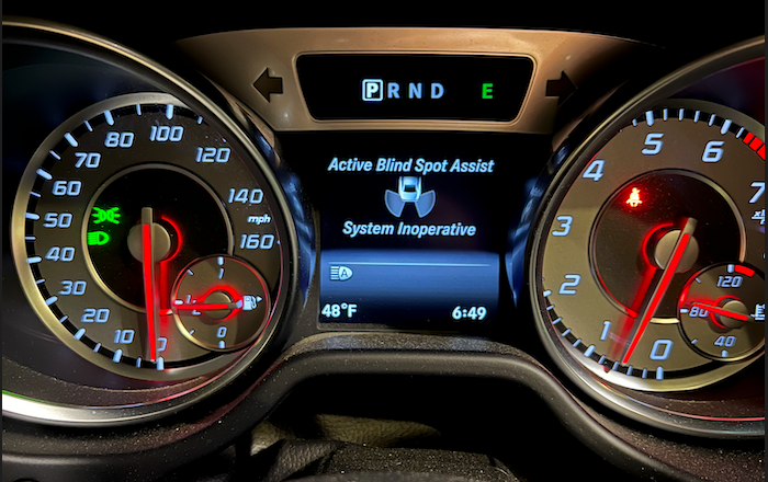

Tried both things and the warning persists. When scrolling though owner configurations in the dash, I see Pre-Safe Brake and Blind-side Assist both as inoperable. This has me thinking there is something wrong with the radar controller or sensor.

The other symptom is that Distronic Cruise Control does not work. I cannot set the speed. Only a long dash appears where the set speed should show.

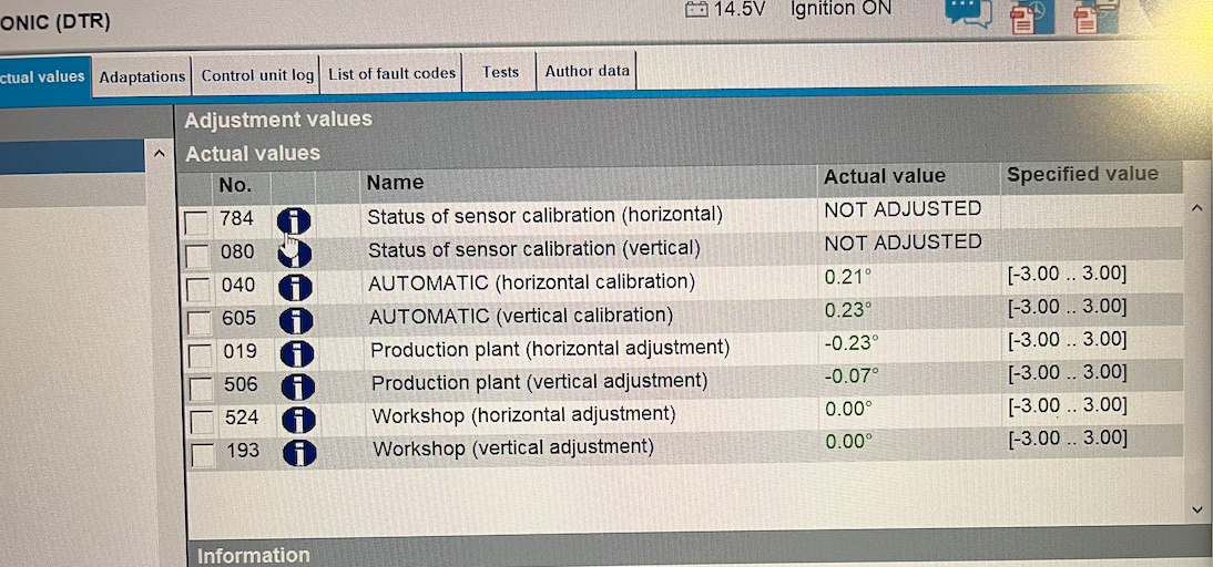

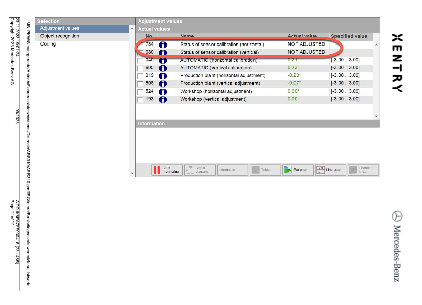

Still no DTCs, but further examining the DISTRONIC PLUS controller, I found this. Does this mean the sensors need to be calibrated? Is this what is causing the problem?

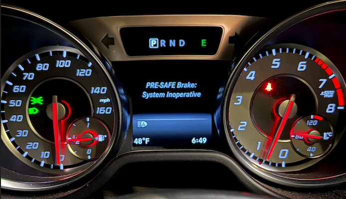

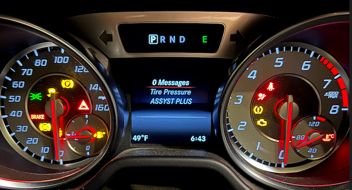

More interesting stuff.
With the car off, there are no messages. But as soon as I start the engine, I get the
Ignition on, engine not running.
Engine on.
Running a Quick Test shows no faults.
No fault codes.
Yet, DISTRONIC and associated functions are inoperable.
Image Assist shows collision avoidance off.
PRE-SAFE inoperative.
Active Blind Spot Assist inoperative.

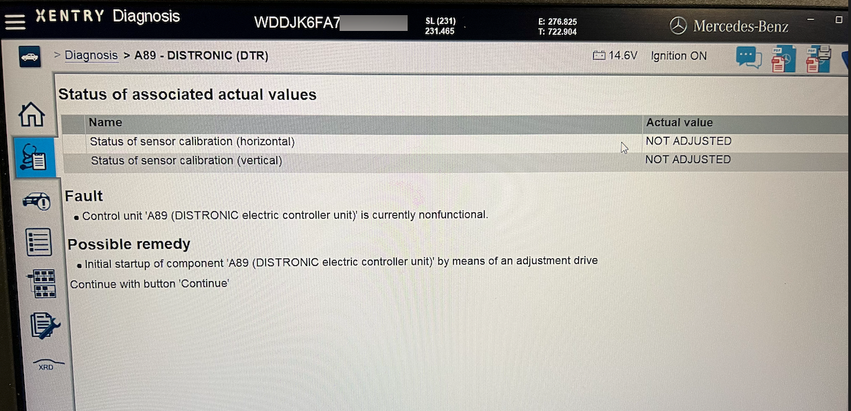

Further analysis of DISTRONIC shows that the sensors are not calibrated.
No DTCs, but DTR is not calibrated.

So, I found this YouTube video that shows how to calibrate the DISTRONIC radar sensors using Xentry. I will give it a try tomorrow.

I conducted the calibration of the DISTRONIC radar sensors using Xentry (as described in the YouTube video). However, with my version of Xentry (09/2023) the menu choices have been revised. The calibration procedure for the A89 controller is now under "Initial Startup" without control unit replacement and with adjustment drive. I started the calibration and proceeded with the adjustment drive. After about 10 minutes of driving, all functions were restored.
