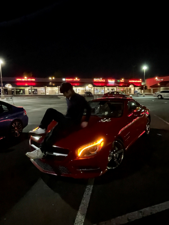

Why is somebody sitting on the hood with their shoes on the hood?
thats me 😭
My first reaction would be to shoot them with my non-lethal pepper ball pistol, but I'm a peaceful guy and not sure if the pepper liquid would harm the paint. So, maybe just with a firehose.

Originally Posted by exturnul
thats me 😭
Ugh! You're disqualified. No SL for you!

Maybe some Hail Mary's and never admit that is you sitting on the hood again.
By the way, the body panels, including the hood and trunk are aluminum. Strong, but still aluminum, meaning any dents will be very difficult and expensive to repair as aluminum does not have "memory" like steel.

He's sitting on the hood - do you really think that he waits for it to get to operating temperature before pushing it? You think he lets it spool down after doing so?

also i DO get it to operating temperature..... don't let the picture fool you. although idk about the spooling part. the ending part of my drives are usually gentle drives where it's a continuous 20mph for 1 mile
Haha, OP could have saved himself some ball-busting for not uploading that picture, although him taking things in stride and being a good sport about it says a lot.
We were all kids once and (most) folks outgrow the occasional foolishness that comes with that. Sweet cars are also exciting, instigating that "young and dumb" behavior.
What matters are the lessons learned and applied.
In this case, no more TikTok-level cringe on MBWorld, OP.
