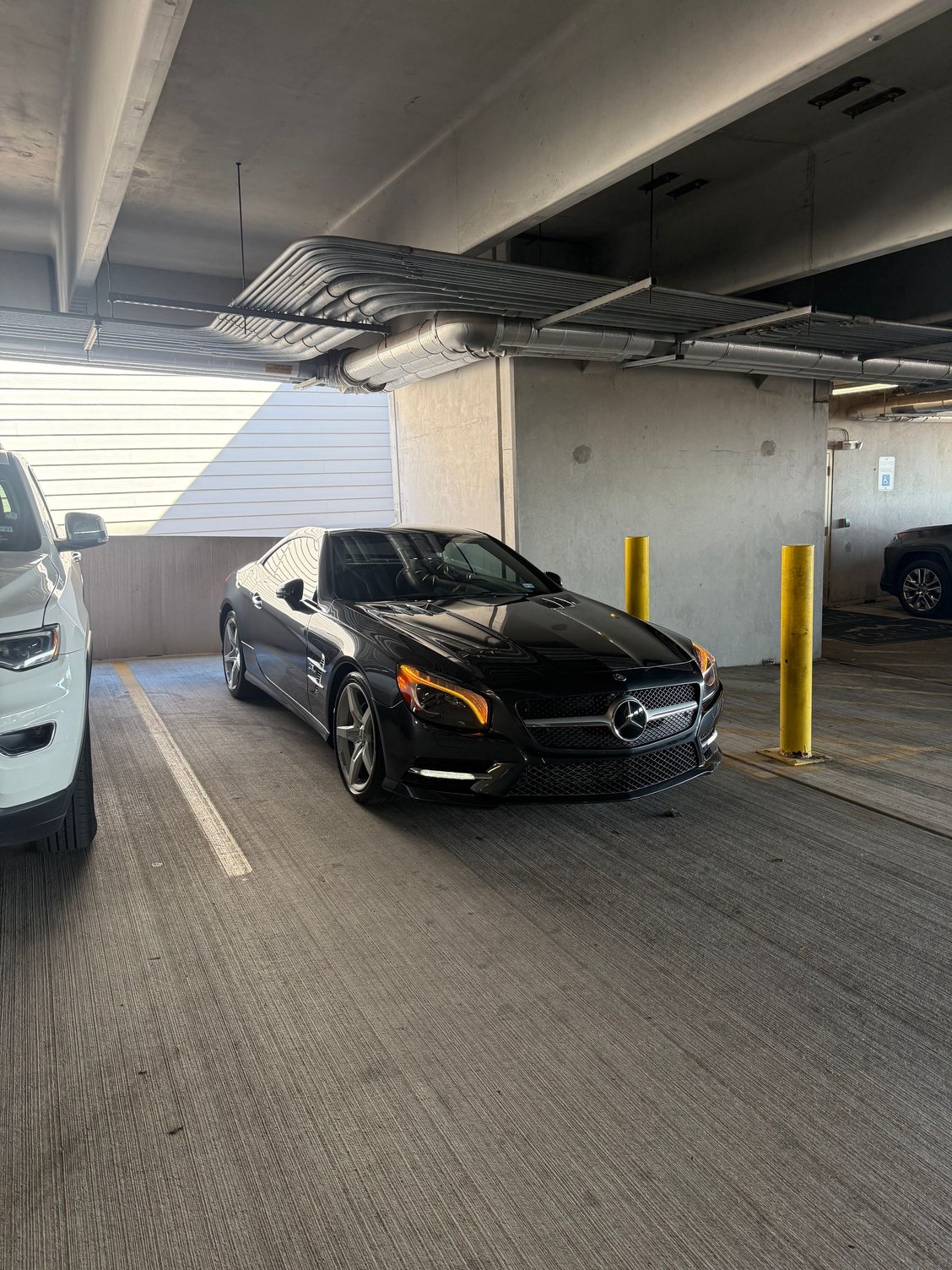

Hi folks,
It’s my first post on MBworld. I’ve owned a W212 for five years and recently added a r231 SL550 with 58,000 miles to my parking lot. It’s a super clean car from a private seller with all the bells and whistles, including dynamic seats. However, I realized that the multicontour seats only work for about 10 seconds after a cold start and stop working due to leaks, making a hissing sound. It’s bummer cuz I love this feature and was one thing I was looking to have in this car. I took it to my mechanic for some preventative maintenance and asked them to fix the leak. They diagnosed the issue but said it wasn’t within their wheelhouse to fix it, so they gave up. They also mentioned that my pump was overheating. So, now I apparently have to replace the pump and fix the leak. I’m willing to spend some money to have it fixed the right way, or if there’s a good DIY for me to do it myself. Unfortunately, I couldn’t find any videos for the r231 on the internet.
