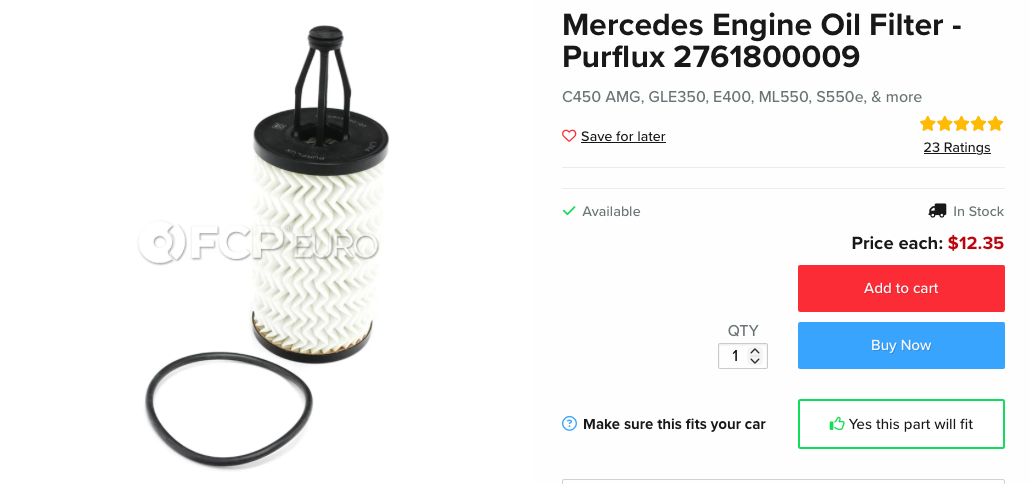

Why not stick with the Purflux OE filter? $12.35 USD. Not sure if FCP ships to you.

Too late, I already got the Wix filter. But I'll keep it in mind next time.

For that specific filter I would go with the Purflux L394. Less money and its who manufactures the Genuine MB filter.
I have the M272 engine so go with the Mann filter who manufacturers that specific filter.
FCP is good if you have a bunch of other parts to return as well, not really worth it to just ship back one $12 filter.
