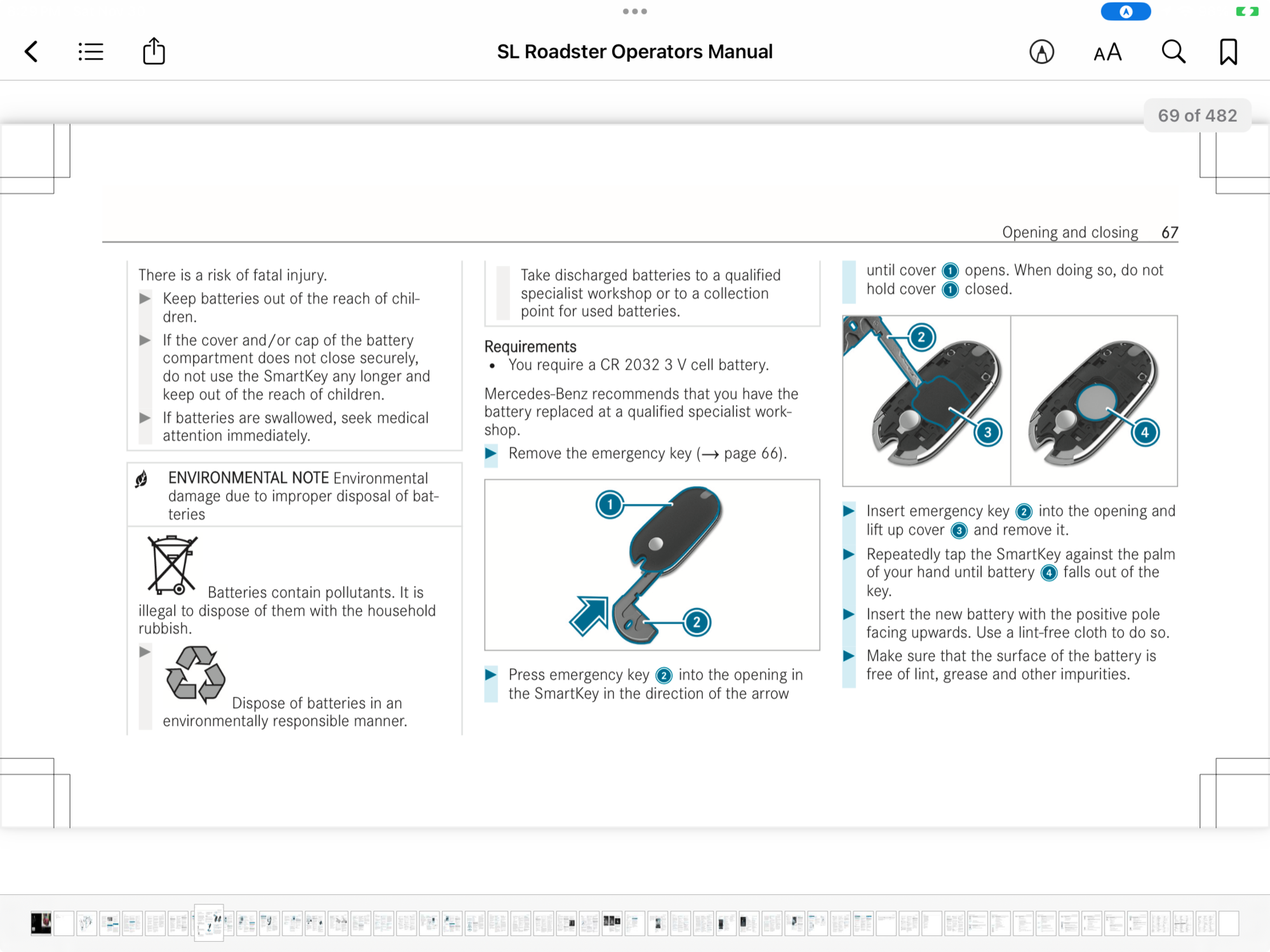

As for battery replacement of the R232 key fob battery,
