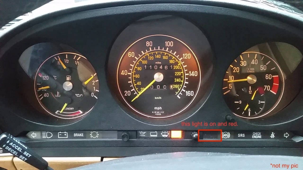

2. There's a red light on directly to the left of my 'anti-lock' light. I don't see any info about this light in my owners manual. What could it be? Pic attached. *not my pic, that yellow light isn't on in my SL.

Hey @Ceckman check out this parallel thread I posted in Benzworld. It ended up being a blown fuse on my OVP relay, behind the passenger side kick panel. 25 cent fix just added a few thousand dollars in value to my SL. I can only hope your fix is as easy as mine. Is your ABS light on by any chance?
