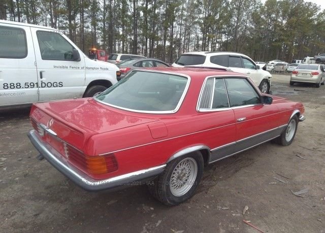

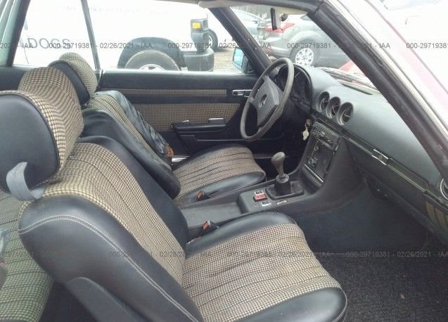

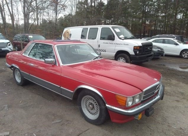

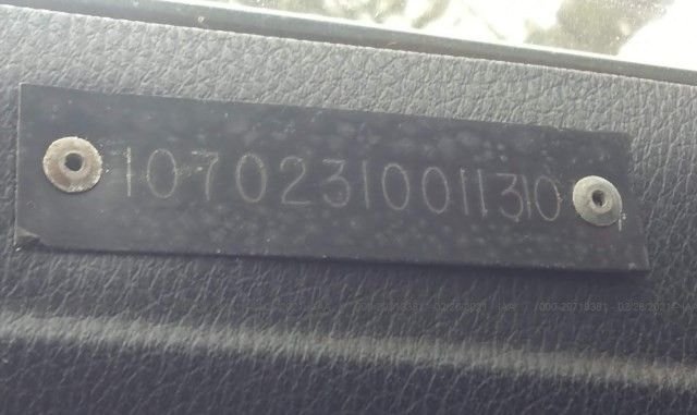

Old Apr 8, 2021 | 11:29 AM
m3j0n's Avatar
Joined: Jan 2006
Posts: 607
Likes: 8
From: South Florida
W220 V12TT Land Yacht / W211 E55 Estate
Old Apr 8, 2021 | 01:35 PM
myway's Avatar
Joined: Jan 2010
Posts: 330
Likes: 26
From: Middle of Nowhere, USA
450SL
Nice looking car. That spoiler was original equipment on the 450SLC 5.0, 500SLC, 500SL and 560SL. Also used on some 80s AMG models. Front spoiler looks like AMG also.
That is not a Mercedes VIN plate.
Old Apr 8, 2021 | 02:42 PM
m3j0n's Avatar
Joined: Jan 2006
Posts: 607
Likes: 8
From: South Florida
are there any other locations to confirm a matching vin? Thanks for the help!
Old Apr 8, 2021 | 06:48 PM
myway's Avatar
Joined: Jan 2010
Posts: 330
Likes: 26
450SL
Stamped into the right of the upper cross support on the right side and riveted to a plate on the left side of the same cross member. There is a sight chance of a build strip under the jack base. Unsure of when they started putting it there.
