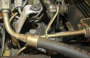

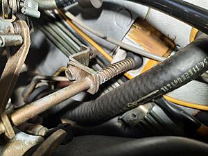

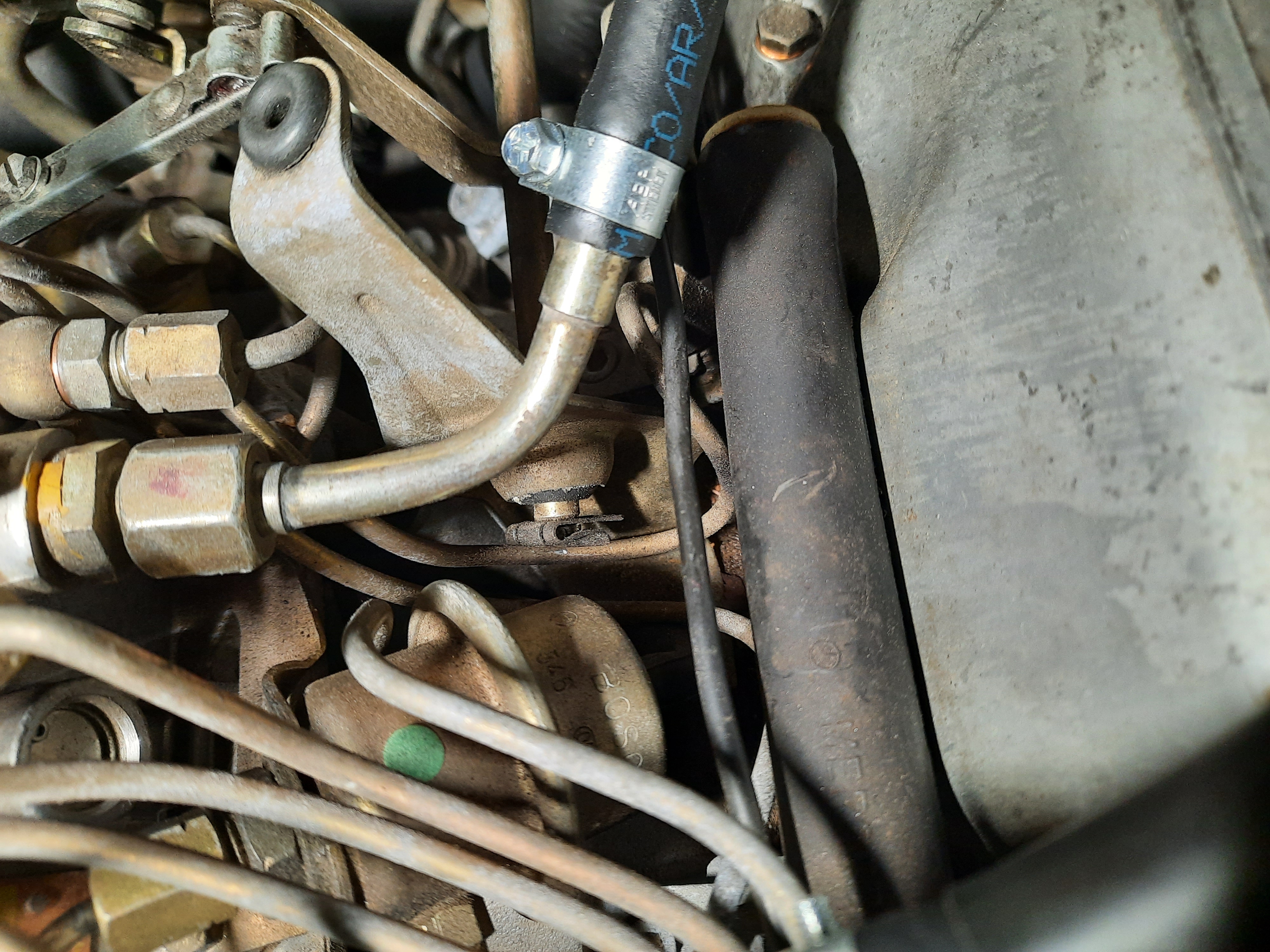

Attached is a picture of my '85, should be the same as your '83. Note the clip on the end of the shaft, perhaps this is what you are missing. There is a plastic ball on both ends, and the spring maintains pressure to hold everything in place.
Here is a link to a parts list for the linkage:
https://partsouq.com/en/catalog/genu...BA45C7FA033305
Here is a link to the service manual:
https://www.tonk.ca/Index/116.3index.html
Attached Thumbnails 380SL Throttle problem-linkage.jpg   380SL Throttle problem-clip-end-throttle-shaft.jpg

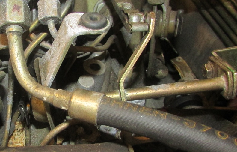

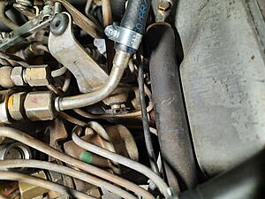

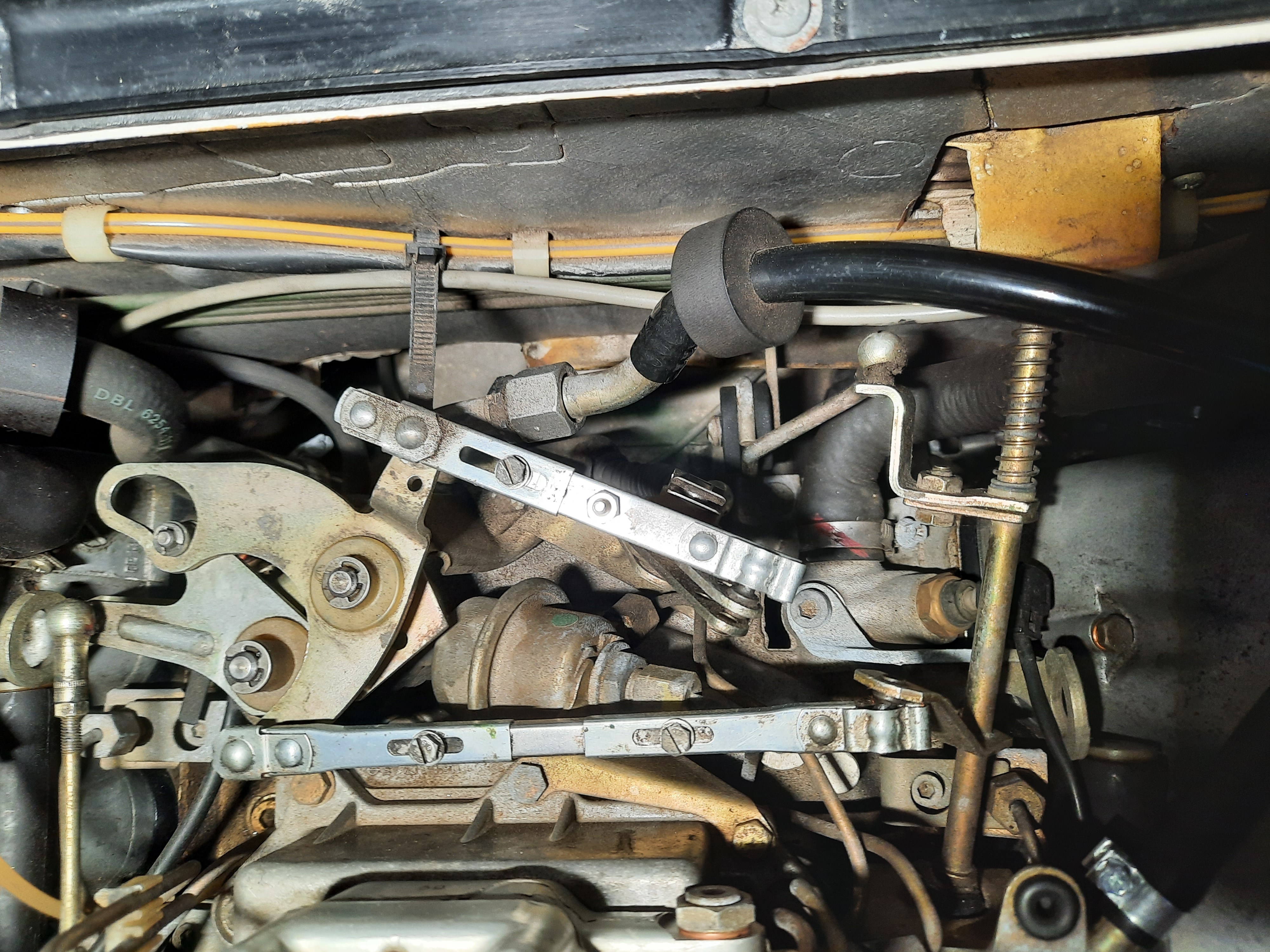

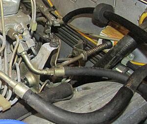

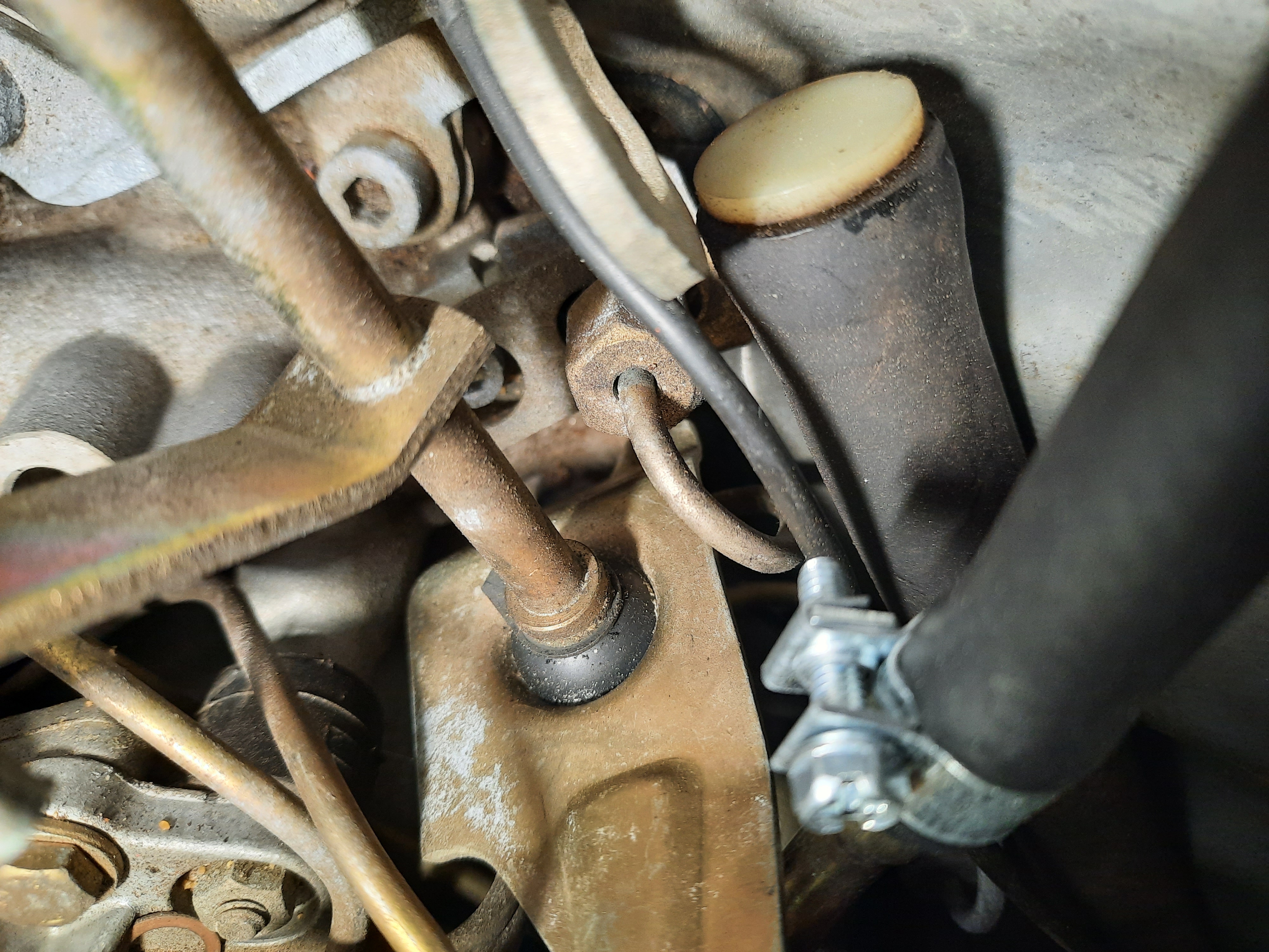

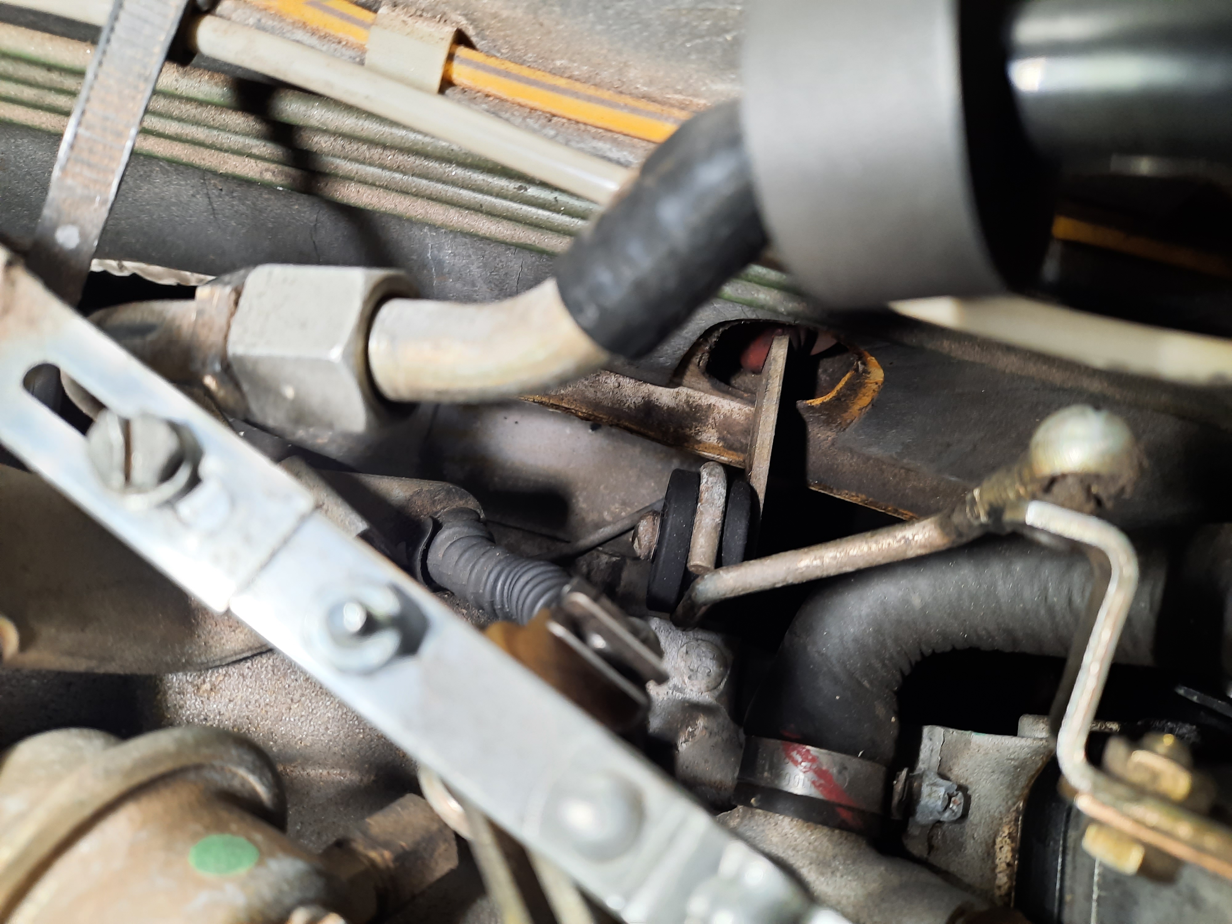

Here are some more pictures of the linkage on my car. Note that the service manual info does not match my car. The linkage shown for the 107 on the diagram (top) is correct except for the longitudinal shaft #3, my car has a shaft like the one shown for the 126 (bottom).
Attached Thumbnails 380SL Throttle problem-20230313_194021.jpg   380SL Throttle problem-20230313_194032.jpg   380SL Throttle problem-20230313_194041.jpg   380SL Throttle problem-20230313_194112.jpg   380SL Throttle problem-20230313_194145.jpg
380SL Throttle problem-20230313_194323.jpg   380SL Throttle problem-linkage-types.jpg
