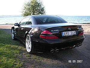

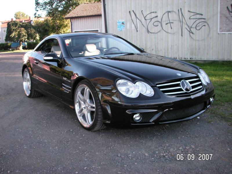

Summer of 2007, I bought EXACTLY that set, from the same dealer for my old 2004 SL600!
They fit perfectly, and don't require any spacers!
(See my photos.)
And the guy working there, Bob, is very helpful and polite!
I highly recommend them!

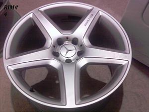

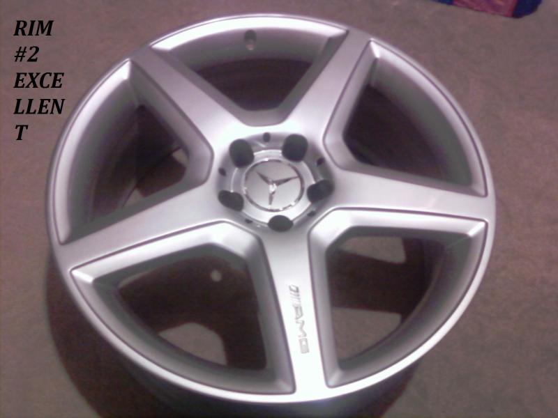

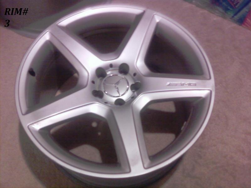

Same here CLS500 WHEELS!!!! SL & CLS have similar off set and it can be shared between the two . This set is for SALE if anyone is interested . it has less than 500 miles . MICHELIN PILOT SPORT . Also have this for sale 19" CLS55 WHEELS

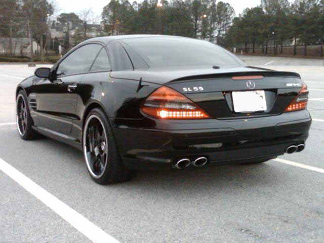

Don't go stock, Get something that gives the car a wider yet classic stance.
