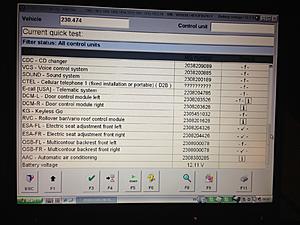

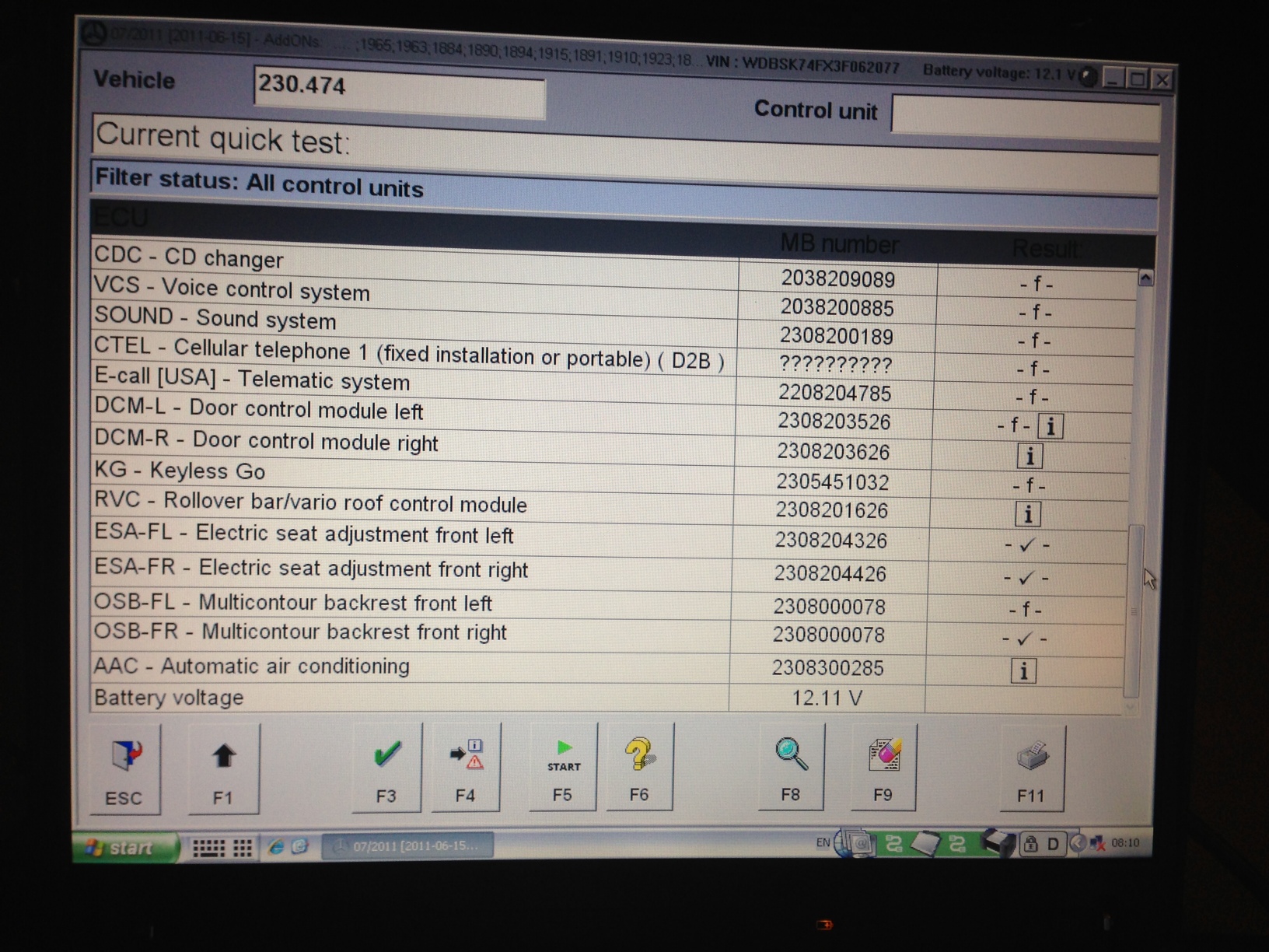

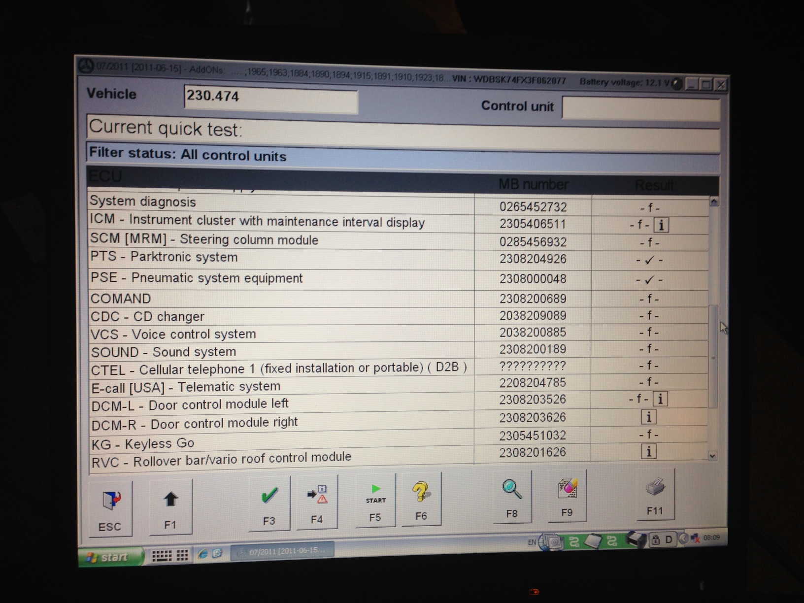

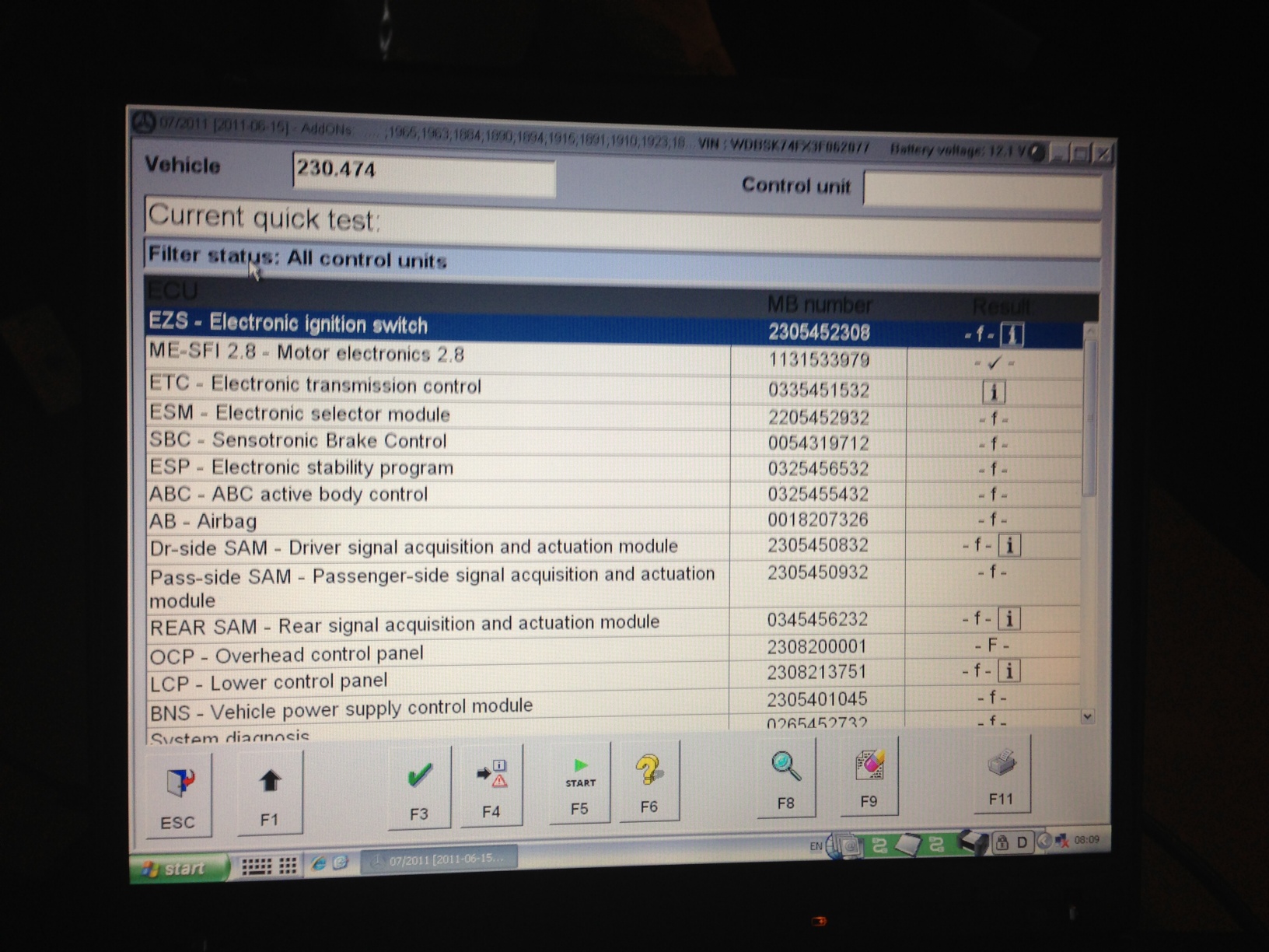

so i picked up an SDS for my 03 SL55, and was giving the program a "test drive".
i ran a quick check, and this is the list it came up with. does anything appear unusual, or i should be concerned about??

all lower case f are stored but not current all upper case F are current fault codes.
ahhh, so all those 'f' was previous codes, that had been corrected sometime in the past? if so, can they be cleared?
what does the 'I' and check symbol represent?

yes you can clear them.
i = communication issues with that module

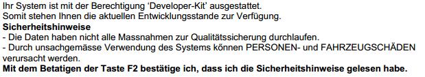

Thanks for that info. Not sure if I have development version, how would I check?
One of the first screens you see upon starting the software will be a screen warning that your SDS is a "Developer Kit". The attachment shows the exact text that appears on my SDS.
