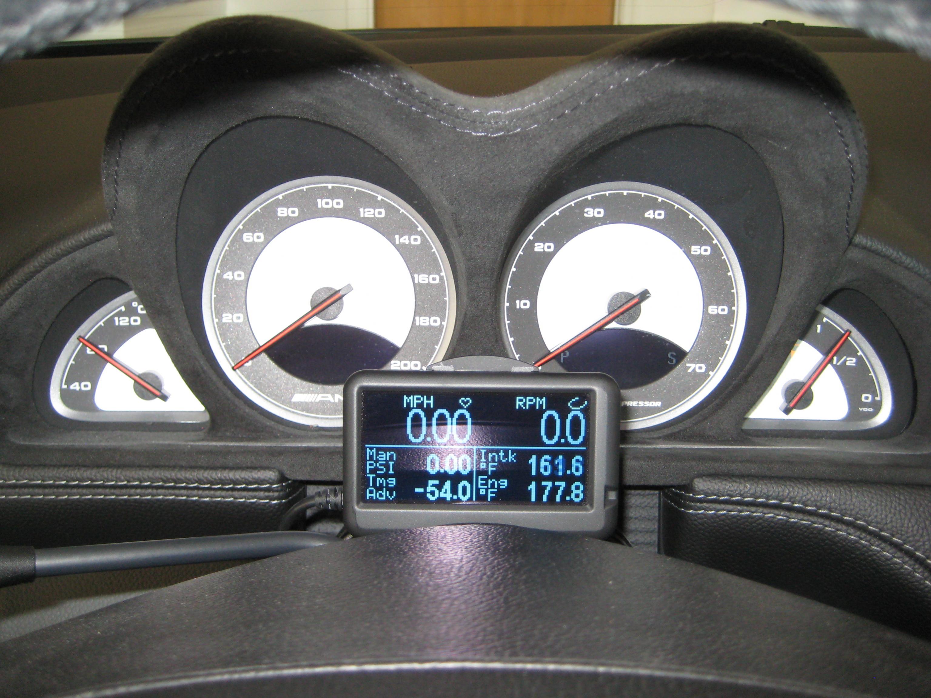

Cheapest and best looking option is an UltraGauge. IAT should be no more than 30 degrees above ambient if you are moving.
