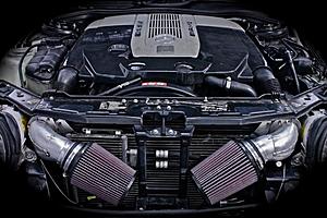

The intake that RaceHorse fabricated looks to be ideal. However, on the 2005-2007 SL's there is literally no room to run piping to the left/right of the radiator and headlights. I believe that it's entirely possible to do with the 2009-2011 model years though.
It seems that the older SL65's have three options.
1. Renntech carbon airbox
2. Speed Driven Scorpion intakes
3. Homemade with filters in front of air inlets
Old May 21, 2016 | 02:10 PM

Ekselent did a very neat and effective job on his SL600:
https://mbworld.org/forums/sl-class-r230/581629-sl600-cold-air-intake-project.html
You know ... these don't look half bad. A lot better than the "cold air" intakes ahead of radiator, anyway.

These were fabricated by worldmotorsport for a CL65

Ekselent really did do a an excellent job creating his own intakes. They honestly look like they're ready for mass production. His car is a 2009+ however which has more room in between the radiator and headlights. On the 2005-2007, there is literally no room to do something like this due to the bubble headlights.
To those who have created their own intakes. What are you doing with the stock intake air temperature sensors that are removed from the stock airboxes?
