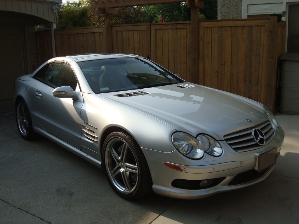

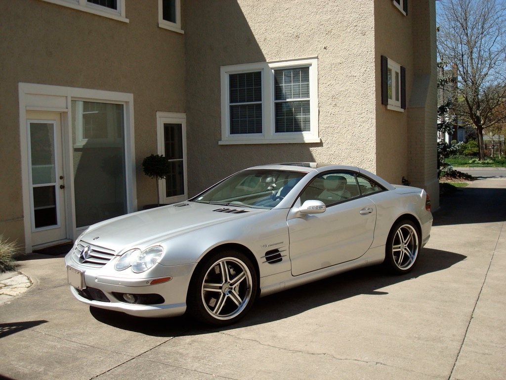

Don't know of clearances, but these are the wheels I have fitted. They fit perfectly along with the Michelin Pilot Sports. I have attached a couple of images below. Hope this helps :
Mandrus Manheim Wheels - Painted/Gun Metal
Front 8.5" x 19" ET 25 mm Tyres : 255/35 R 19
Rear 9.5" x 19" ET 25 mm Tyres : 285/30 R 19
Don't forget wheel bolts for Mandrus Wheels have taper and not OEM ball seats: M14 x 1.5” pitch, 60︒ Taper Seat
