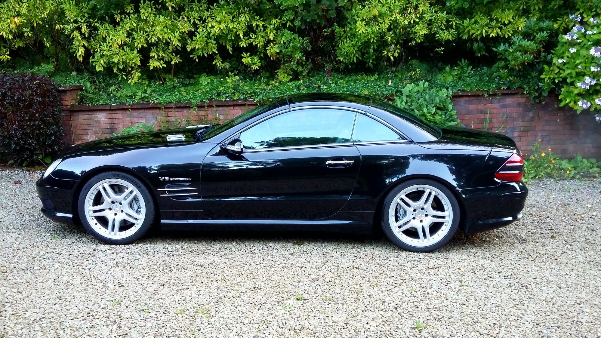

Just curious if there was a visible impact on ride height with the coilover conversion? Would love to see some pics.

The KW coilovers on my car are height adjustable.
Also compression and rebound damping has 16 level adjustment allowing the car to be dialled in to suit the users preference on stiffness vs comfort.
