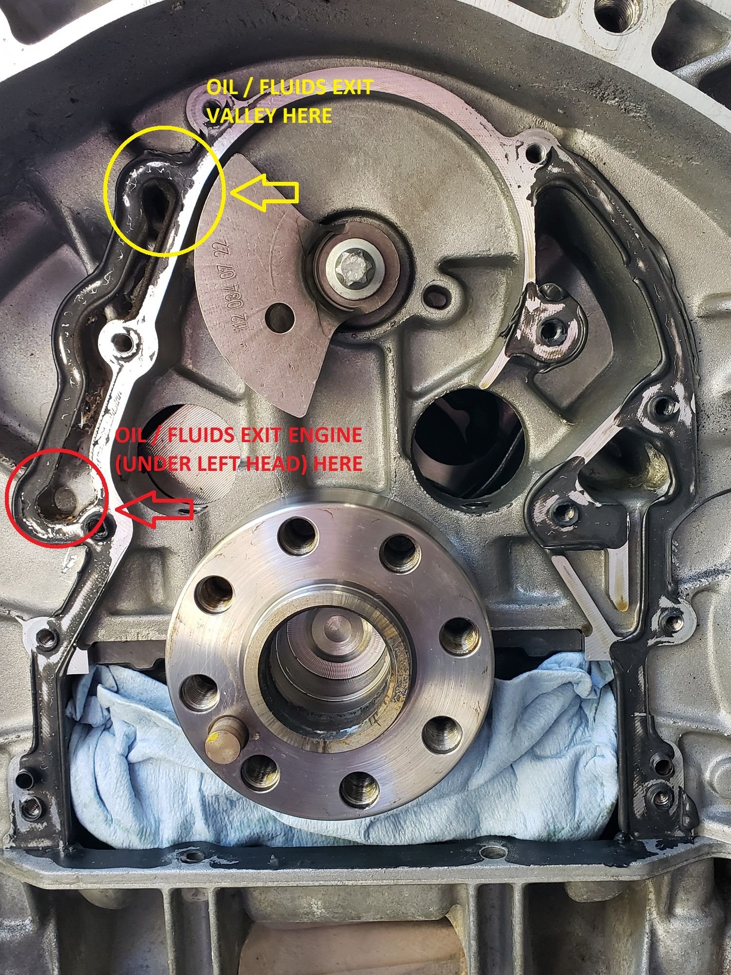

There is a path (channel) for oil and fluids to escape from the valley under the supercharger that ends up at the back of the left head. The passage is cleverly cast into the back of the block under the rear-main-seal retainer/plate and exits about where the starter would be mounted (IF the starter were mounted on the left instead of right).
See pic
hope that helps,
Chris

Chris…….YES, very helpful.
Can you tell me the source of this leak from under the Supercharger?
What will I need to remove and what seals/gaskets/hoses etc. will I need to reseal and reassemble things?
Thanks a lot.

I would begin by confirming that this is the source (the drain hole). I have never had a leak here, myself. And, it is not immediately obvious to me how oil would leak past a gasket and make its way through here.
Supercharge front-case-oil could I suppose (but doubt there would be much).
Coolant the from Intercooler and/or supply pipes could make its way here.
A really bad valve cover leak perhaps (but you have ruled that out already).
And, I guess you could have a bad seal on the retainer-plate (of the rear-main seal) ... but that seems like a long-shot (and requires the trans be separated from the engine to get at ... so lets hope not)
Hopefully someone else will have some experience that they can share that would shed some light here.
but first, do confirm that this "drain" is the source of your drip
Chris

I'm now wondering how I'll confirm (or not) the leakage you have pointed to. In the photo, am I looking at the rear of the main (crank) shaft with the motor removed? Or is that the front of the blower with the clutch removed?
I'm pretty sure it's not the main shaft seal as I can inspect the lower/inside of the bell housing and it's pretty dry.
I am seeing only motor oil, no antifreeze. And no oil in the coolant tank either.
It's a reasonably sizable leak that can result in a 6" diameter oil spot after a drive and cool down.
I'm guessing that the main oiling system also lubricates the blower......correct??
Best, Mike

I showed you a picture of the rear face of the motor because that makes it easy to point out where the "drain" is. What you will want to do is to look for (and then look at) where the lower hole (that I indicated with a red circle) comes forward (exits the block). It should be a hole close to 10mm in diameter and you should find this near where the starter motor WOULD BE IF it were on the left side of the engine. You may be able to see it with a flashlight and a mirror, but if you have a borescope it would be easier to see. I have several borescopes, but the least expensive one I just bought recently may be my favorite.
Amazon Amazon
the blower is not connected to the main oiling system, but instead has a smallish gearbox in the front that holds a small amount of fluid (probably not the source of your re-occurring spot).
HTH,
Chris
