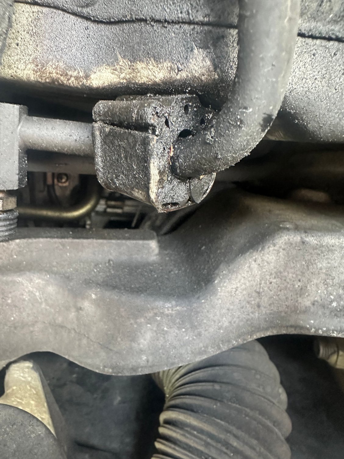

There was a small puddle of ABC fluid by the drivers front wheel. Also the top of the reservoir seemed to show some residue. I pulled the filter and the gasket looked a little wonky. I pulled the wheel and see no evidence of a leak around the strut or fittings but this bushing (or whatever it is) was the only thing showing evidence of fluid. Research indicates the accumulator ?

Based on what I read here, the ABC fluid is being forced up through the resevoir due to the accumulator failing...and viola. The other clue was an occasional ABC warning when hitting bumps and/or fluid on the wheel lol. I will start replacing all the components over time.

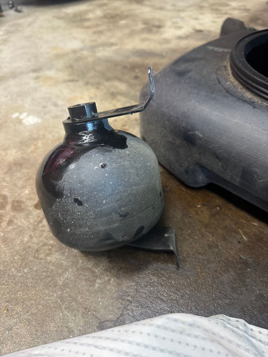

Thanks lilbaggie and nice name lol. I just got it apart and ordered the same. I feel like if I had a 24 mm in hand and gotten the side vent off I might have gotten it off in place, but I ended up just disconnecting the 3 hoses and had to use a vice to hold it because that thing was on good. But, it's off and Amazon had one. I am just posting this diatribe to maybe help the next 2004 SL55 owner.

Hey sports fans I have the front accumulator and pulse dampener in place and now waiting on the rear accumulator to be delivered. I thought that was behind the passengers rear wheel but I am watching a YouTube that shows it on the drivers side.

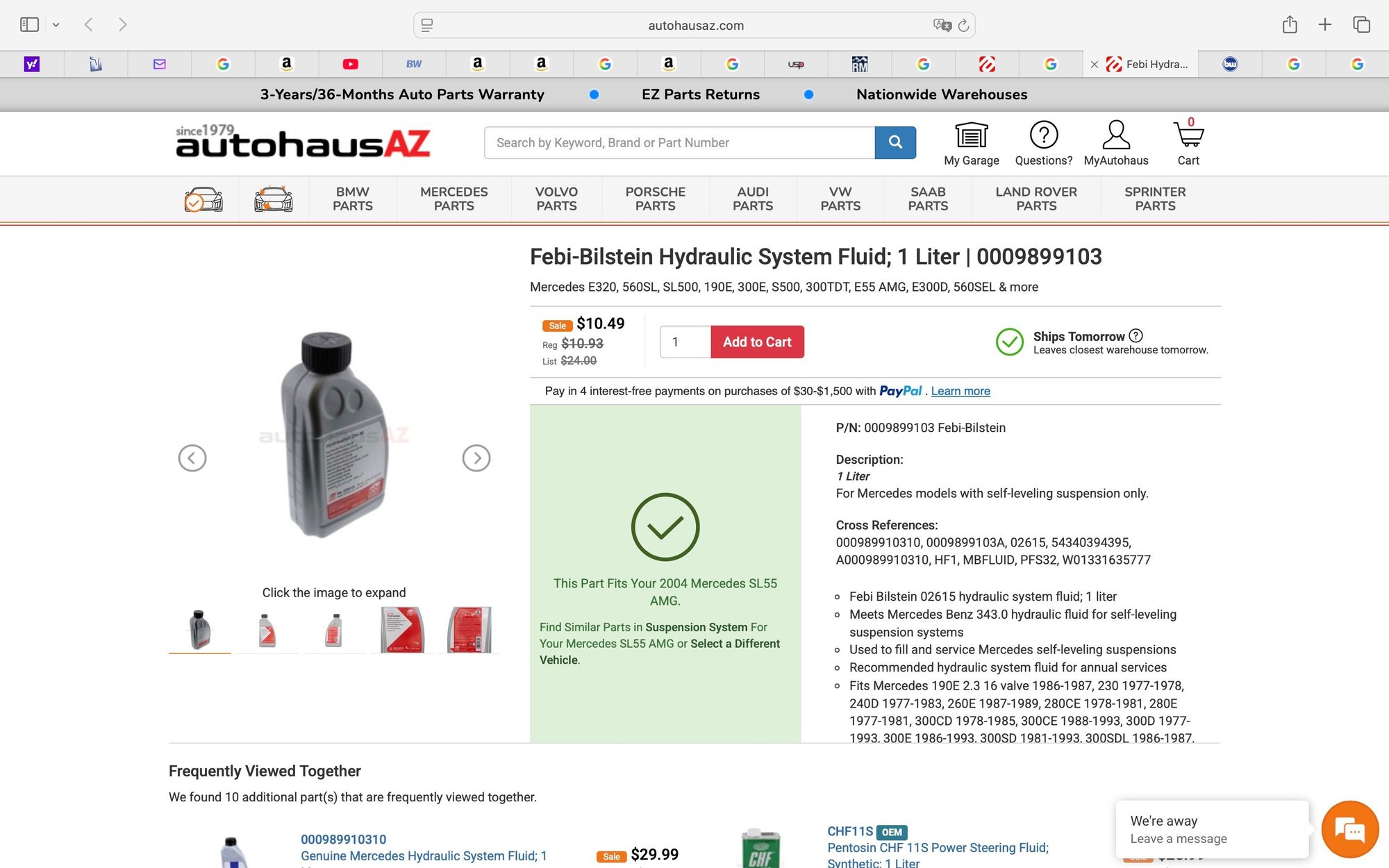

Slight thread drift - but is Pentosin 11s and Titan 11s exactly the same ? According to this Fuchs acquired Pentosin.
https://www.fuchs.com/baltics/lt-en/...eering-fluids/
More drift. I will be topping off with 11s rather than tempt fate but this appears to be MB blessed and way cheaper.

The consensus is another thread was that they are equivalent if not exactly the same. I also notice that FCP Euro sells some of the R230 ABC kits with Pentosin and some with Titan.

Pretty compelling message that this fluid is perfectly fine, I'd be inclined to use it for the next flush.
