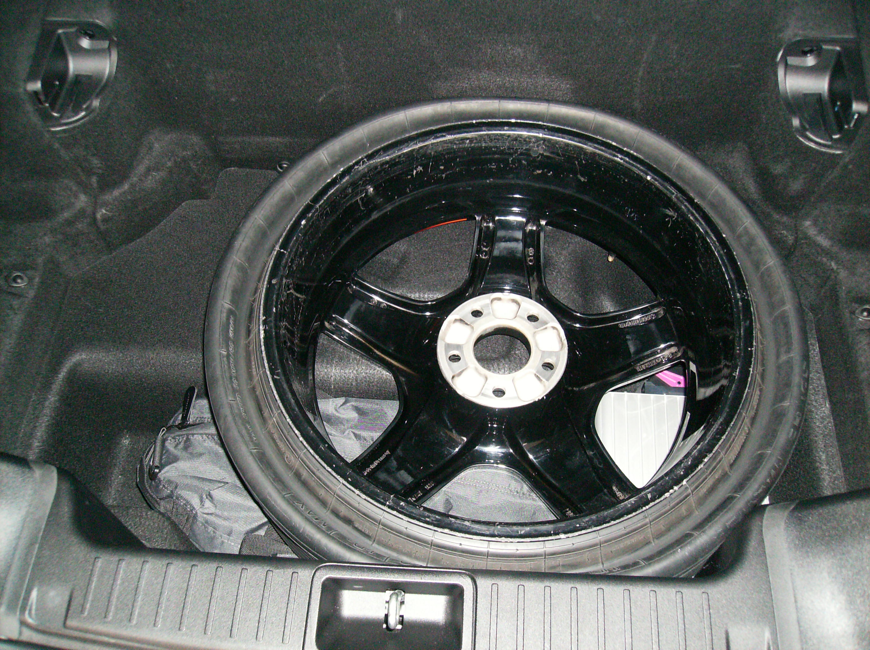

The R231 will use the R230 19" spare. There is no spare for R231
23040112702
175/50/19 tire 19x6.5 14ET
It is used in E63, CLS63, maybe S63
Attached Thumbnails R231 collapsable spare-hpim8597.jpg   R231 collapsable spare-hpim8599.jpg   R231 collapsable spare-hpim8603.jpg   R231 collapsable spare-hpim8607.jpg

get one on ebay or junk yard for 4-500 and carpet fits i just have everything out

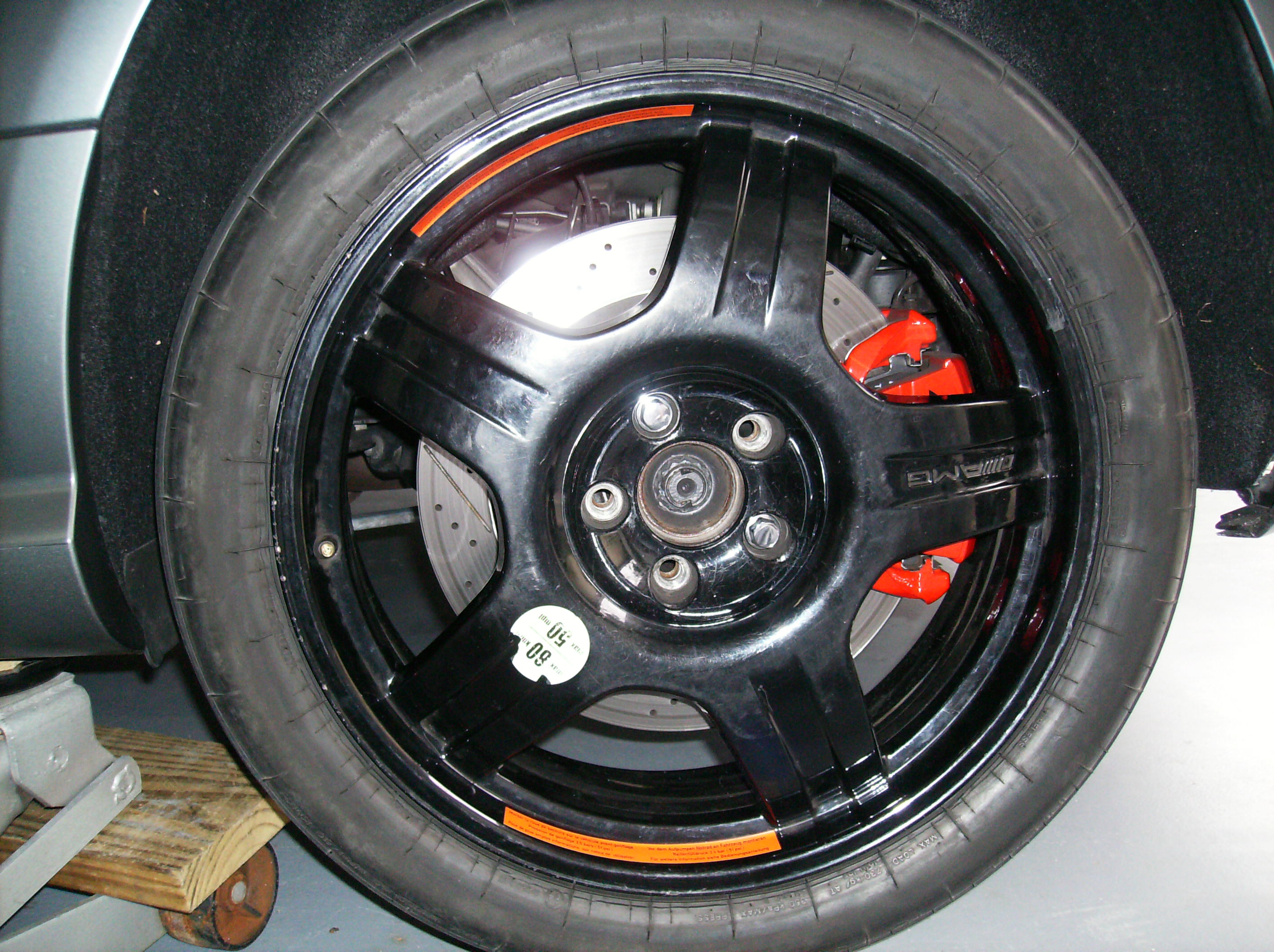

I'm assuming this won't clear the AMG / Carbon Ceramic calipers?

dont know I wouldnt think the carbon caliper is any bigger than others, but if the car has 19 front it should, I would think it fits them all

you have to make up your own tools. I bought a e55 jack , 2115830215. its the same as 230 jack. any lug wrench. you should have the compressor with the car.
you can get all that on ebay

you would put the tire on top of the carpet, I still have room for one lg duffle on the side and one loose filled duffle in the wheel. and there is room below the carpet for a med duffle and tools. plus small areas around the trunk to stuff odds. of course I took out the big cover mechanism.

I had the 19" spare for 7 years for my SL 65 and it bailed me out a couple times and fit over calipers no issues......I laid the spare upside down in the truck, so I could put things in the inside of the wheel for storage space, etc.....you do have room on the sides of the spare for groceries or a small duffle bag for traveling.....usually I put things behind the seats in the interior when I traveled....there is a leather suitcase bag you can buy for behind the seats, but it is expensive and hard to find......I think they were over $ 500 for the suitcase a few years back....
